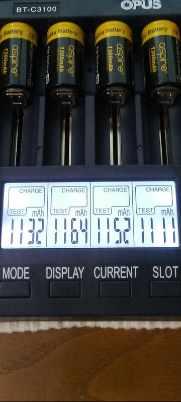

They seem pretty good. Probably one of the best we can still get. Pic below is the Best one they ever had but they don’t make it anymore. I think there’s been several cells that were a derivative of it. See photo below.
And one against The Vapcell that were brand new and the Aspire were almost 4 years old! I can’t recall the numbers of Cycles on the Aspire…but at least 250.
They have 15 amps written on the cell. I’m sure they’re a legitimate 10 amp and were tested at that, at least that. I still have them. One that wasn’t in the picture below was 1020mAh… don’t think I used that one as much.
