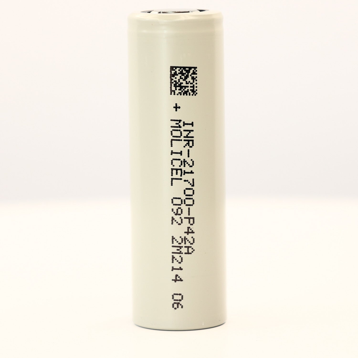

2x molicel 21700 P42A 45A 4200mAh 2 celdas genuino con 3D caso Impreso
This one is the one you want:
Yep, the MOLICEL/NPE INR-21700-P42A is my favorite high drain 21700 cell.
Very thanks, I read very good things about Molicel.
My only doubt is: would I need to addapt it? is it button top? I cant see it clear…
Those cells are flat tops.

So I should go for this one:
And… my only fear is the non protected thing… I dont want it to explode in any way…
The Imalent MS08 has a ring system and can be driven with just one cell (emergency).
The picture in the test of HKJ does show a slight protruding top. So that should be OK.
With the link you posted entry #9 Review IMALENT MS08 - 3*21700 - 34,000lm. did change the cells to Vapcell T42/Molicel P42 which I believe are the same cells. Molicel P42 is a great cell with great output and still having capacity as compared to the Samsung 30T.
Protected cells will not deliver high amps. They are designed as such. That light of yours may be drawing more than 8 amps per cell, above the protected ones.
As for Low Voltage Dropout, I would think Imalent would have built this into their flashlights. As for battery reverse, never; ever do an accidental one in those 3 or 4 parallel configurations.
You bought a big boy light, stand up to the challenge. Forget the protected cells – baby steps.
