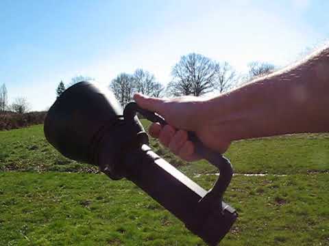

Here is a video of the flashlight with the handle mounted:

I’ve been printing the first iteration of a 3D handle for my BLF GT, it’s a handle you slide in from the back of the GT, it requires the button cap ring to be unscrewed and screwed back once the handle is on, there is a hole to hold it with the tripod screw.
This one was too small in ID on both tube sections to slide in so i had to brake it to mount it and see how it felt.
It looks terrible but i like the ergos very much, and i can access the switch with my index finger.
The section of the handle is oval, what you see on top of it is remnants of print supports that i had a hard time removing.
