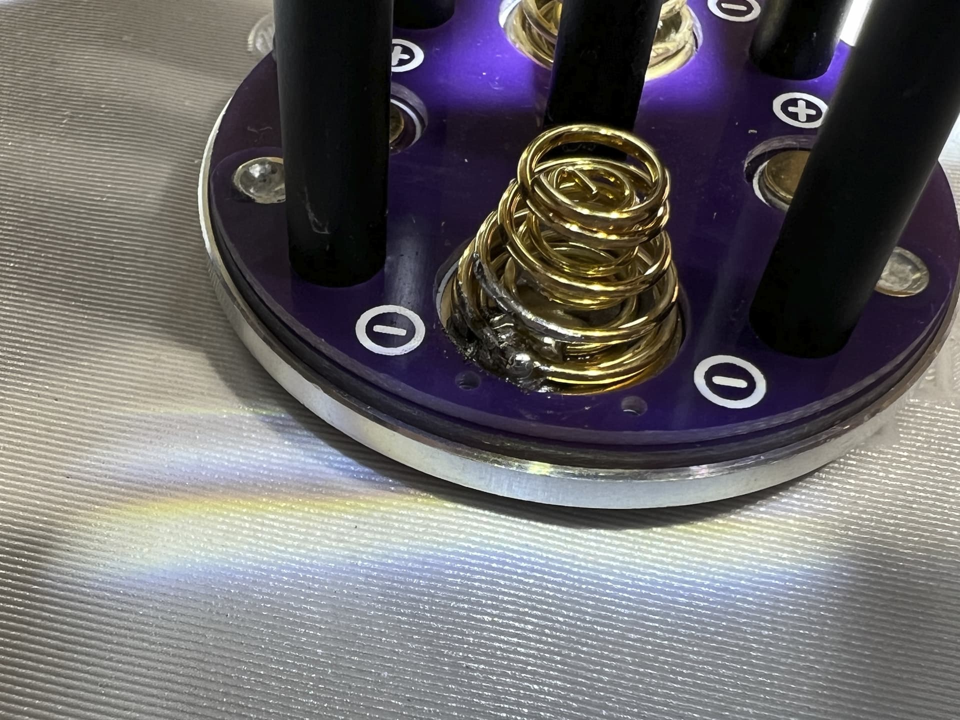

I soldered it, but unfortunately it turned out pretty ugly. it holds the spring in place, do you think I can use the lamp this way? I used such a flux.
Thank you!
It is probably fine, but it looks like you didn’t heat enough. Those globs are caused when the solder doesn’t flow well. This is because the material did not get hot enough to let the solder flow properly. The very bottom of the spring should be heated enough to heat the board below it as well. Then the solder just kind of “sheets” and melts into solder on the board under the spring.
What you did will probably work, but it will not be the strongest possible joint. BTW, the springs I have fixed usually are soldered in more than one place. Sometimes all the way around the base. If you can solder it in more than one place, that would be better. It will be better physically and may reduce resistance a bit.
Again, as long as it does not come out again, it should work OK. Pressure from the battery will keep it in contact with the board.
