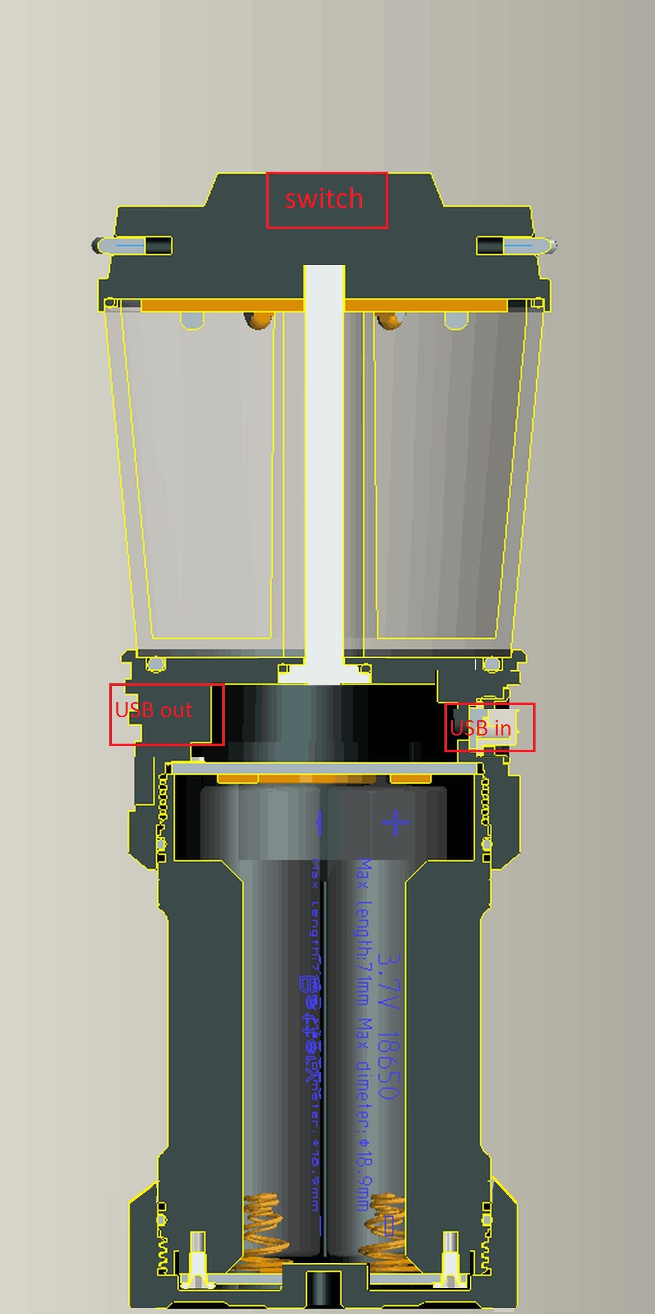

switch does not nessesarely need to sit in center, but my best recommondation would be that the top section gets screwed fom the driver cavity like the Q8 did, so you got no need to water proof the screw on top of the lantern and it looks cleaner
Something I just remembered… the Q8 has this problem that a good smack on the tail cap will cut power for a short while and leave the light off (MCU reset). I suspect this will be a more annoying problem with a lantern that you’re going to put down on its tail cap most of the time. IIRC, some people found that a large capacitor fixed the problem. Probably a capacitor after the diode so it does not power the main LED but my memory is a little fuzzy on that. It would be nice to make sure this is incorporated in the lantern driver so it does not suffer from the same problem. Maybe it already is… I’ve not tried to figure out the rather complex board which was posted a while back.
The aluminium ā€œnutā€ for the bolt will shear in a matter of days.
Over torquing in aluminium can be done very easily also.

And I have to agree with the switch being on the side a-la Q8, and an amber LED sounds AMAZING. Top buttons are cumbersome, especially with the lantern hanging.

I like that idea too of putting the center bolt in from the driver side, as that will allow for a much deeper threaded section in the top solid part for more strength and as you mentioned a better seal.
