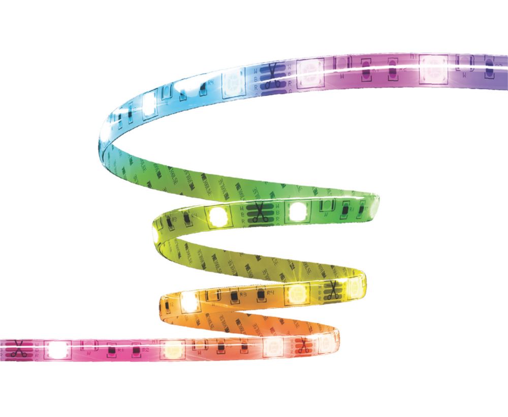

Hi all, total noob when it comes to lights.
Looking for help. I have a set of LED strip lights
I wanted to power then from a 12v battery
I connected the battery to the RGB controller and the controller smelt burnt. Unsurprisingly… lights didnt work.
I can buy a new controller but i dont want to burn out another one. My logic that a 12v battery should have been fine didnt seem to play out.
Can anyone advise how I fix this?
Thanks!

I have a number of inexpensive controllers that I use for Christmas lights and DIY bike lights. All of my controllers are labeled 12V DC to 24V DC so connecting one to a 12V SLA battery delivering 13 Volts would never destroy the controller. I had one instance where the shipper sent me 5V strips instead of the 12V strips I had ordered and they died instantly when hooked to a 12V source. If you are using the ordinary flat strips with a glue backing they will always say on the strip what the voltage should be. You can test the strip by just touching the positive lead from your battery to the + side and then touching the negative lead to R, G, and B on the strip. Each color should light up when you do this.

This one is a little more complicated because of the wi-fi option so you have 6 connections on the LED strip. Simple RGB has four and smart LED strips that have a lot more options for color changing have 5. You can find inexpensive controllers that also have a remote control so you can control it with the remote as well as with a cell phone. Looking at the damaged controller I see it has a J-21 power connector which is common on most wall converters so if you have an old converter from something like a printer with the J-21 end, you will be able to power your strip. One like this 1A 2A AC/DC 12V Plug Power Supply Adapter Transformer for CCTV Camera/LED Strip | eBay that operates on 110V to 240V AC input and 12 V DC output. The power cord is correctly polarized so you never get the polarity wrong.
