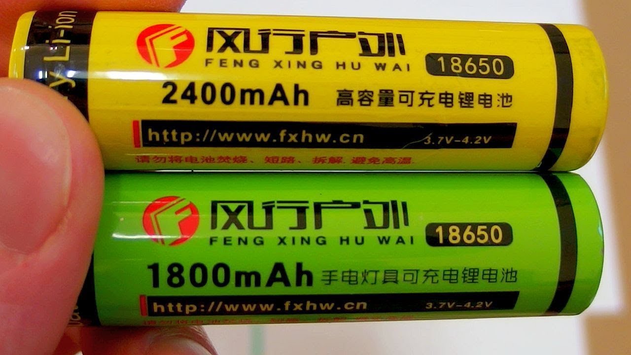

BOGUS 18650 Autopys
Here are some 18650s that are not what they seem.
One of them shows how pulls can be dressed up to look like a new cell.

The price. WTH? $1.55 for a 2400mAh 18650? The profit margin looks to be so incredibly low. Why bother? No trust in something like this. It would’ve been profitable for this guy to test something less conspicuous. Like a $3.50 18650.
The thing I found interesting, other that the humor of the whole thing —-
Was how new end caps were spot welded onto a pulled cell to hide the old spot welds.
I’ve got a few crappy batteries I’ve gotten with cheap lights.
Going to have to strip off the wrappers and have a look.

At this point, I’m surprised they’re not just cutting pieces of broomstick to the approximate length, writing “battery” on the side with crayon, and selling ’em for a buk a pop.
At least that’d be infinitely safer than the Canned Death they’re selling.
