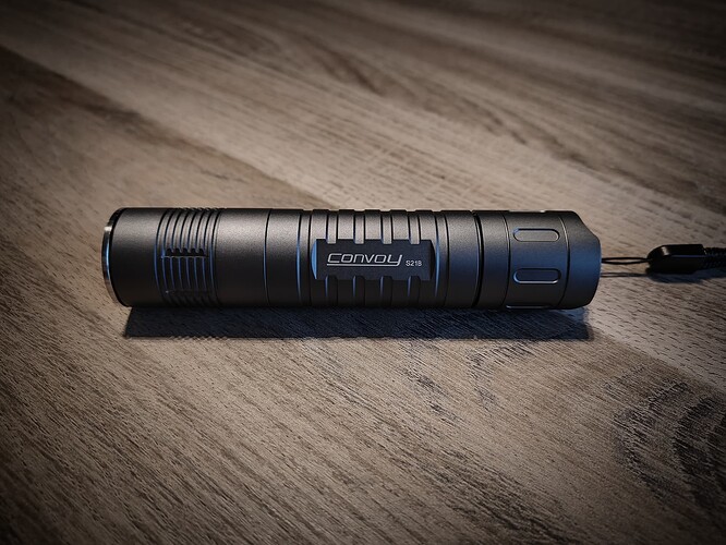

At least 50 times a day, someone will tell me “We lack efficient, high output, high CRI mules”. Well this is it, the voices in my head have won. I have dubbed it “Phobos”.
“Phobos”
  • Convoy S21B gray host
  • 4 x Nichia 519A 5000K DD in mule config
  • Efficient Convoy boost driver (6V8A)
  • 4A per emitter (2S2P)
  • Est. ~ 4000 lumens at turn on (P42A)
  • Illuminated RGB switch
  • Copper DTP, Noctua NT-H1 thermal paste
  • Extra copper heatsinking, bypassed springs
  • 3D printed centering ring
  • Optional Wurkkos 20350 body tube

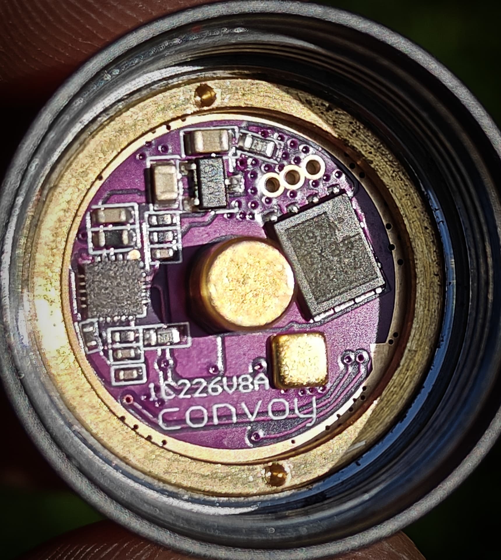

So Convoy has released its XHP70.3 6V8A 22mm driver. I thought this would be the perfect base for a new mule build. @Simon_Mao
This has been a very frustrating build, especially since my dog ate my flux syringe.

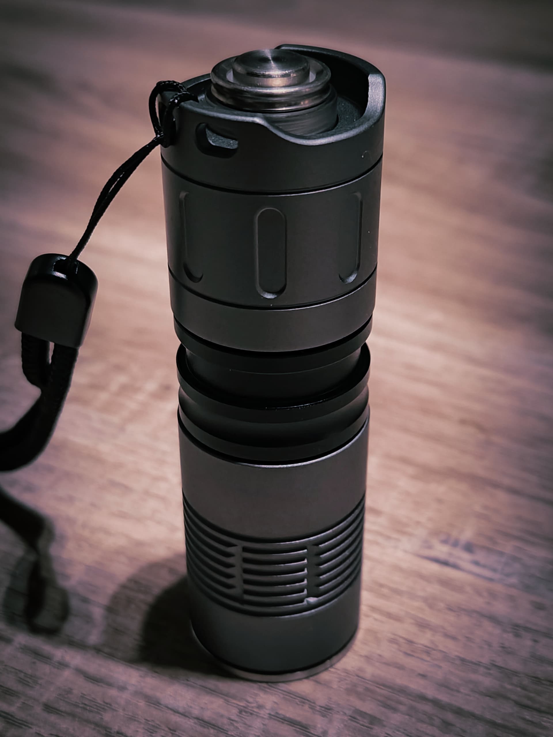

It’s alive!

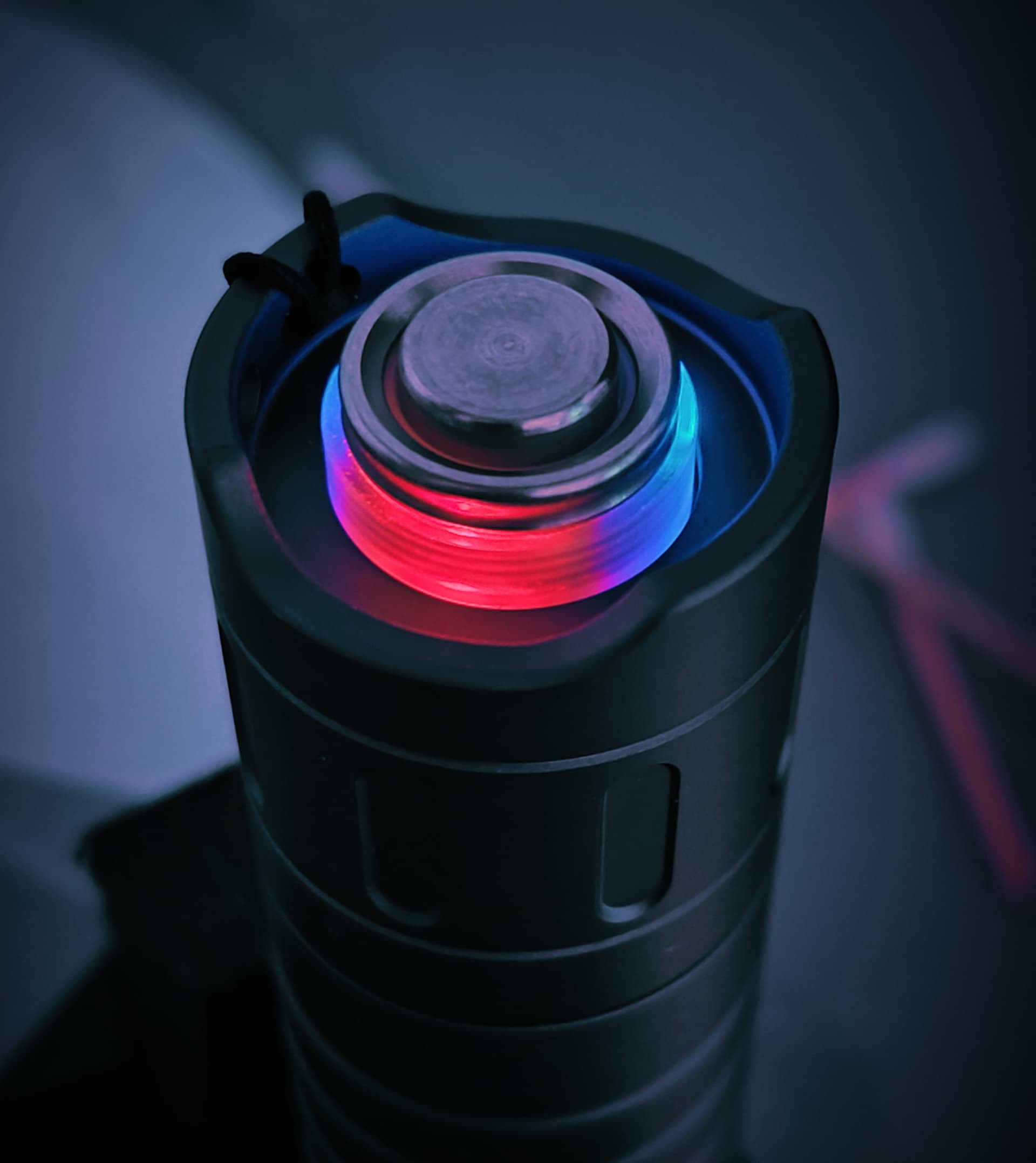

I love how the RGB switch desyncs after a while:
It does get pretty toasty, real quick on turbo. Will the 3D printed ring hold? We’ll find out.

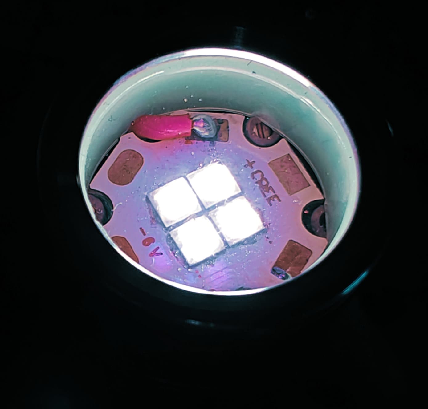

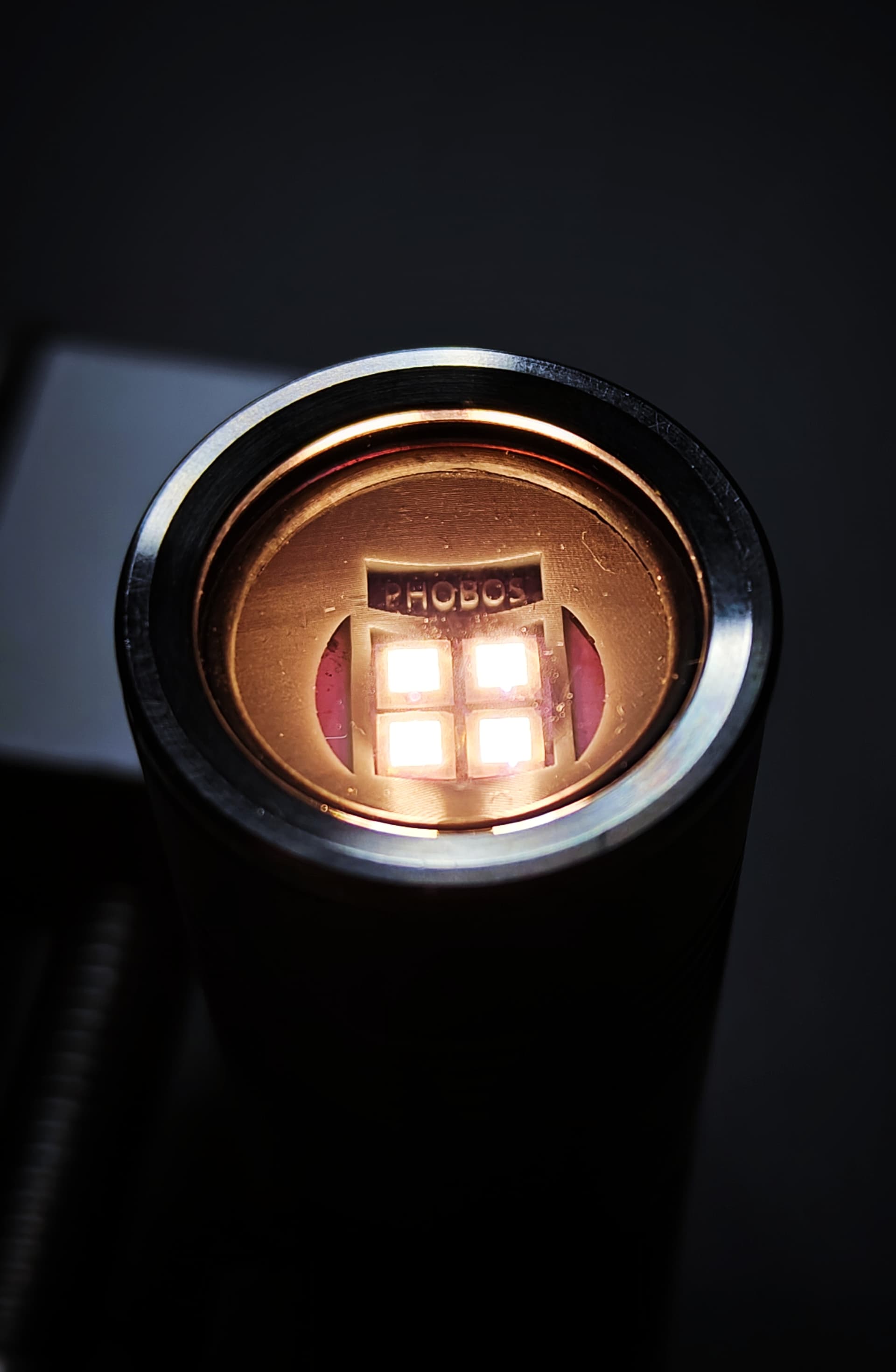

The “mule spacer” are multiple demasked copper MCPCB’s, soldered together. These also function as a bit of extra heatsinking. I used solid copper wire as centering dowels.
Positioning the centering ring accidentally decapitated one dome, so I removed all of them.

You can paint that printed “reflector” in white or chrome .
Looks good! Those quad boards have been around for years but I’ve not seen many builds with them, I put one with 4x 519s in a convoy L6 with a shorty tube and driver from Hank. The beam is a bit doughnutty and I need to tidy up the soldering.
Yeah, I can print in white! Thought the gray was best for the gray body.
Just did a 5 minute turbo run and it didn’t have any impact on the material.
I’m already contemplating V2.0 with cutouts to expose the wires.
Nice job.
Is that spacer resin printed?
Yeah, this quad 6v mule has been on the list for a while. And that L6 sounds like a real frankenlight! Got any pics?
Yes it is, @Hoop . It was the simplest option to hide the ugly generic “CREE” board and double as a spacer.
The design definitely needs some refining, but initially I I wasn’t sure if it was going to hold up to the temperature. Looks fine for now. Will add some new variants soon.
