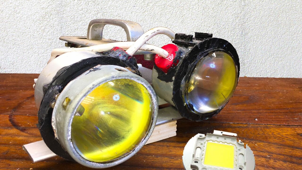

Looks like a very interesting project Cavediver.
Have no idea about the price, and of course nowhere close to 100K lumen)
I guess you can contact them directly to ask for prices.
