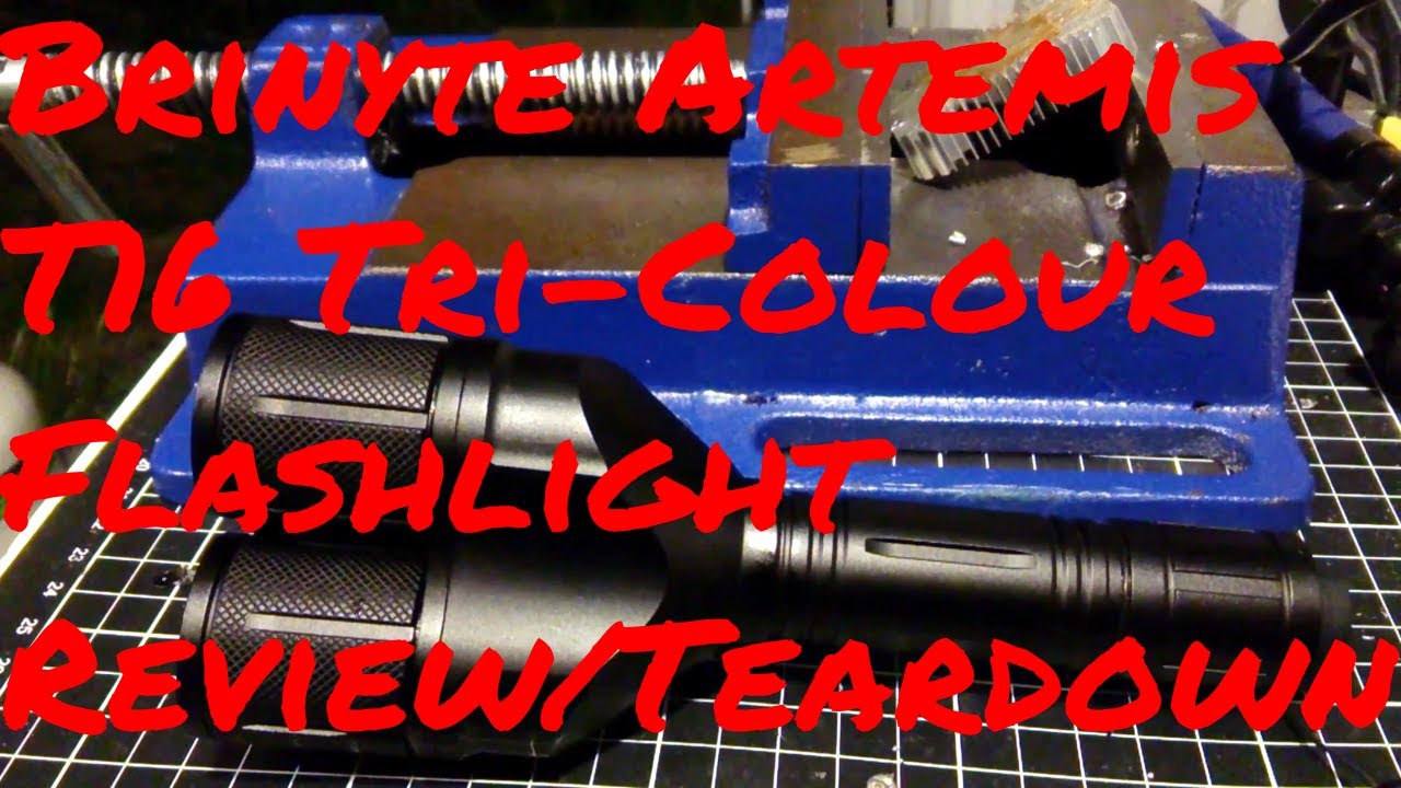

Hey lads so i was sent the T16 Artemis from Brinyte for commenting in the thread. So i guess a bunch of got a light? They didn’t say to review the T16 Artemis but seeings its unique i will take some pics and see how we go.
No specs or instruction where sent with the light so all these numbers are mine. As for output figures i have never tried to measure any coloured LED’s so i am not sure how well it would work. This pics are dodgy i will update them i get time!
The Artemis T16 is a tri colour flashlight that is purpose built for hunting. The T16 is using an adjustable focus lens system. Each colour only has one mode from what i can tell simple on and off is all you get. The T16 also includes a laser in the center of the head.
- Weight: 324 grams without the battery
- Length: 180mm
- Head diameter per single: 33mm
- Head largest part: 68.2mm
- Lens 30mm
- MCPCB: 16mm
