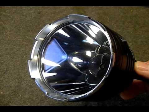

Bear in mind this light was an engineering prototype and was used when I received it. It had quite a few dings in the anodizing when it arrived. The reflector looked to be in great shape for such a big smooth reflector. Didn’t see any flaws worth noting. The threads for the tailcap are not anodized. With a light this size which will likely end up in truck beds and boats, I would like to see the threads anodized for a mechanical lockout of the light. The threads came dirty and were not the smoothest, but this could be a prototype issue rather than a production issue. Hopefully Brontelight takes the time and effort to make great threads on the production model. The light tail stands and is very stable despite the big head. The stainless steel bezel could not be removed by hand. After my review is complete I’m going to do a teardown, but didn’t want to risk hurting anything before my review is complete. The block knurling on the body of the light is good, and is comfortable if you are holding the light from the tube. The handle could use improvement also. I took this thing out trick or treating for a few hours. Firstly the light is very front heavy, so you constantly need to apply pressure to the handle. This does fatigue you quite a bit. I found myself changes hands frequently towards the end. The balance doesn’t let the light just hang from your hand. The handle is also a bit on the small side. The finger grooves did not line up completely with my hands, and definitely wouldn’t if you had gloves on. Both switches are a little mushy as well. I did have several times I hit the switch and it did not change modes. Once again I really hope its a prototype issue and not something that will follow the light into production. The glass is not AR. This is something I would love to see improved on this light as well. The battery carrier seems well built. The screws holding it together are stripped out as you can see from the pictures. It will hold NCR18650B with plenty of room to spare. This will likely not be able to handle the shortest flat top batteries.

So if your interested in white wall hunting your going to be disappointed. The light has some rings. However the hotspot is clearly focused and very well defined. The spill is also well focused around the edges and is just enough to keep in front of you well lit. When you take this light out at night it truly does give you that light saber effect because the hot spot is so well defined. The temperature is a fairly cool white as well. I didn’t see any traces of blue or green in the beam.

Don’t consider these bad, but instead things that need improvement. Hopefully Brontelight takes some of this into consideration. However, please bear in mind that some of these criticisms may be because I have a prototype and may not be an issue in the production models. The threads are not the best, and should be anodized for a mechanical lockout. The handle is too small and the balance of the light is all in the front, which means you have to apply pressure to the handle to keep it in your hand. This will wear you down during long use. The glass lens is not AR, and should be. The switches on mine were a little mushy. That could just be from extensive testing, travel, etc… Also there really should be a blink or step down before the light shuts off. Sudden shut off like that can make a bad situation even worse.
