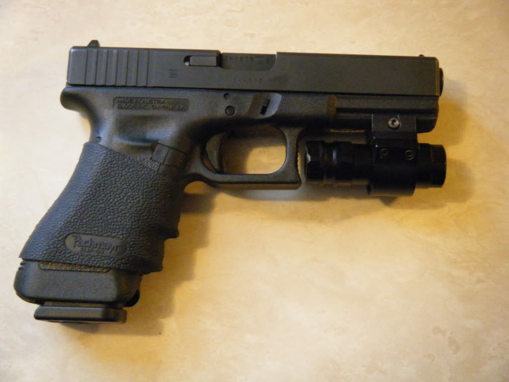

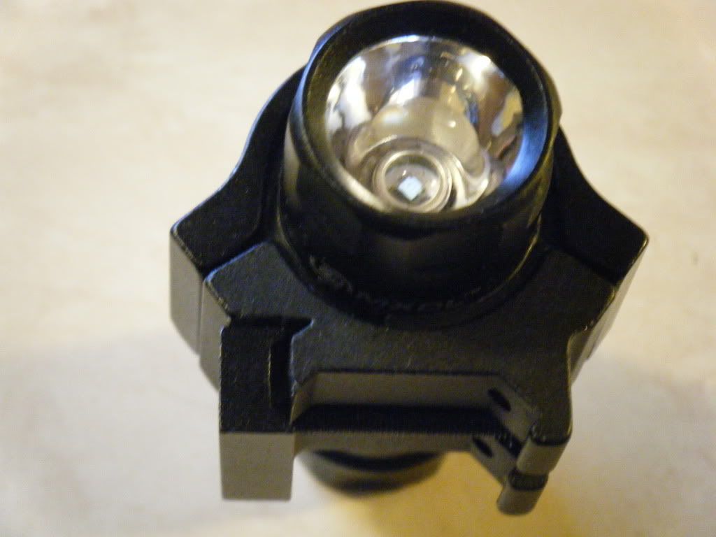

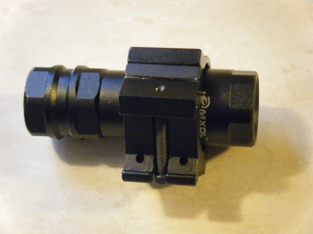

Here is my ghetto light setup for under $20 and a little labor.
I start with an MXDL 3W from DX $6.73
http://dx.com/p/mxdl-3w-flashlight-black-2083
I add an R2 XRE from LCKLED $3.65
Some quick release scope mounts work great $5 for 2
http://dx.com/p/25mm-gun-rail-mount-2-pack-4772
I remove the stock emitter from the light and add the R2 with heavier wires direct drive and Fujik the whole pill together
Once it’s all together I leave the base loose so I can just push on the base of the light to get it to turn on. It’s much brighter than the $100 factory Glock light and handles the recoil fine.
I don’t believe you will find professionals recommending that. The amount of pistol control you lose by taking your off side hand from the gun is considerable.

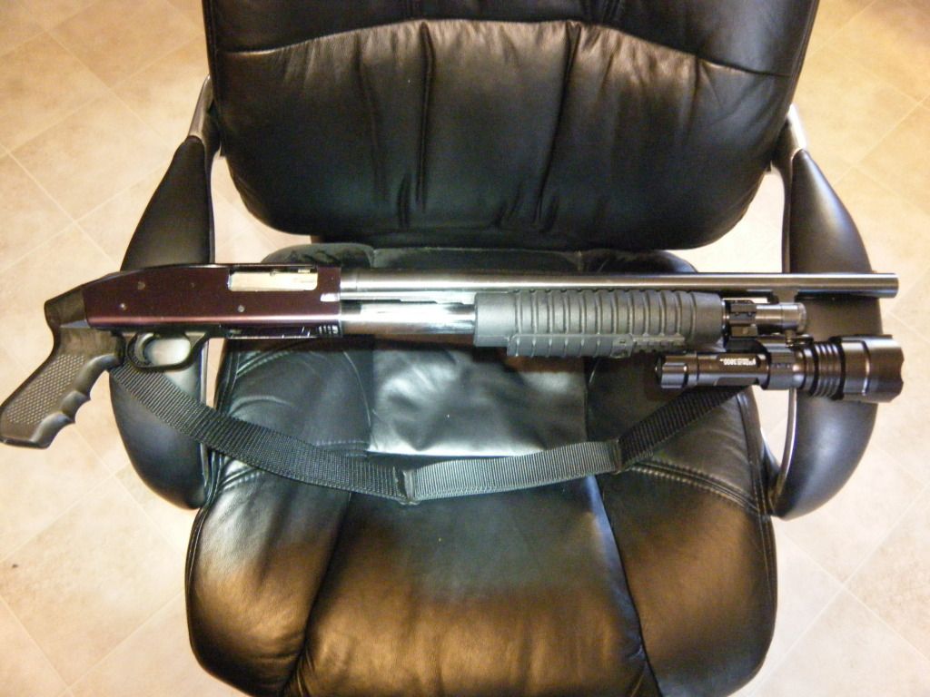

Or just say fugg it, mount an XML light on your AR15 and clear the house with that J)
That’s what I have next to the bed. And 30 rounds of 75 grain hollowpoint ready to go. Of course I live outside city limits, so any time I’d need police I would be waiting for the county sheriff to arrive…….could be some time.
Or you could mount a triple XML to your shotgun and not worry about the possible over penetration of the .223
Haha, nice.
I am going to compare an XP-G2 at ~1amp and my XML at 3amp when I get home and see if the extra light is worth the reduced run time for a weapon light.
