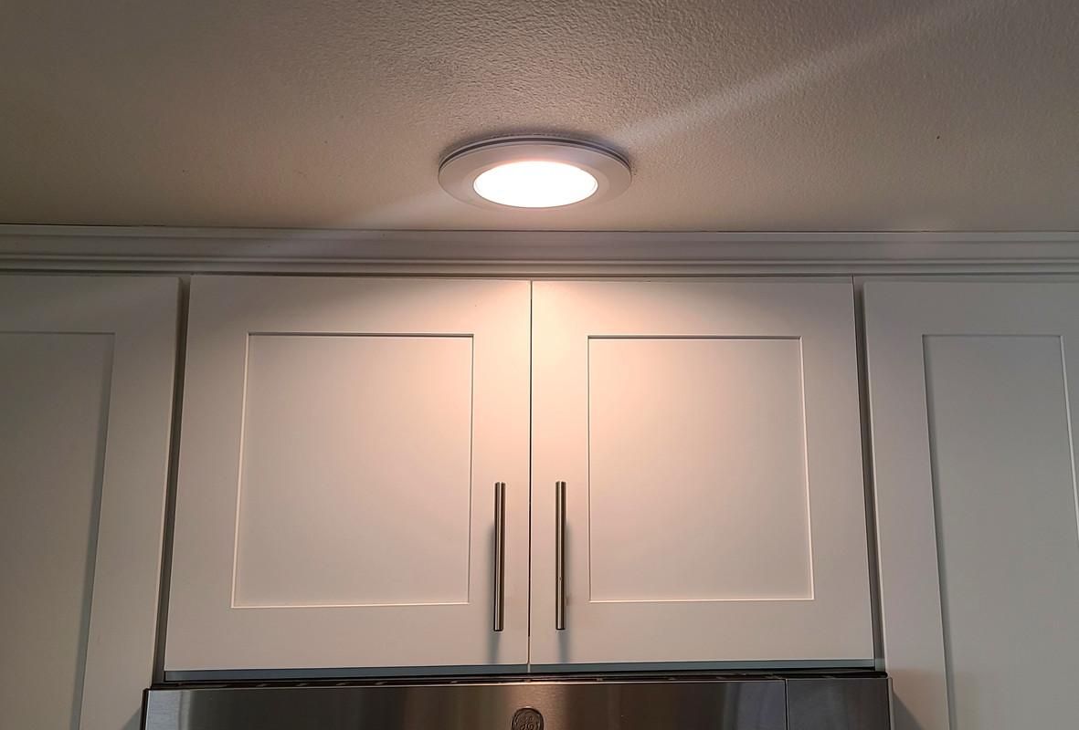

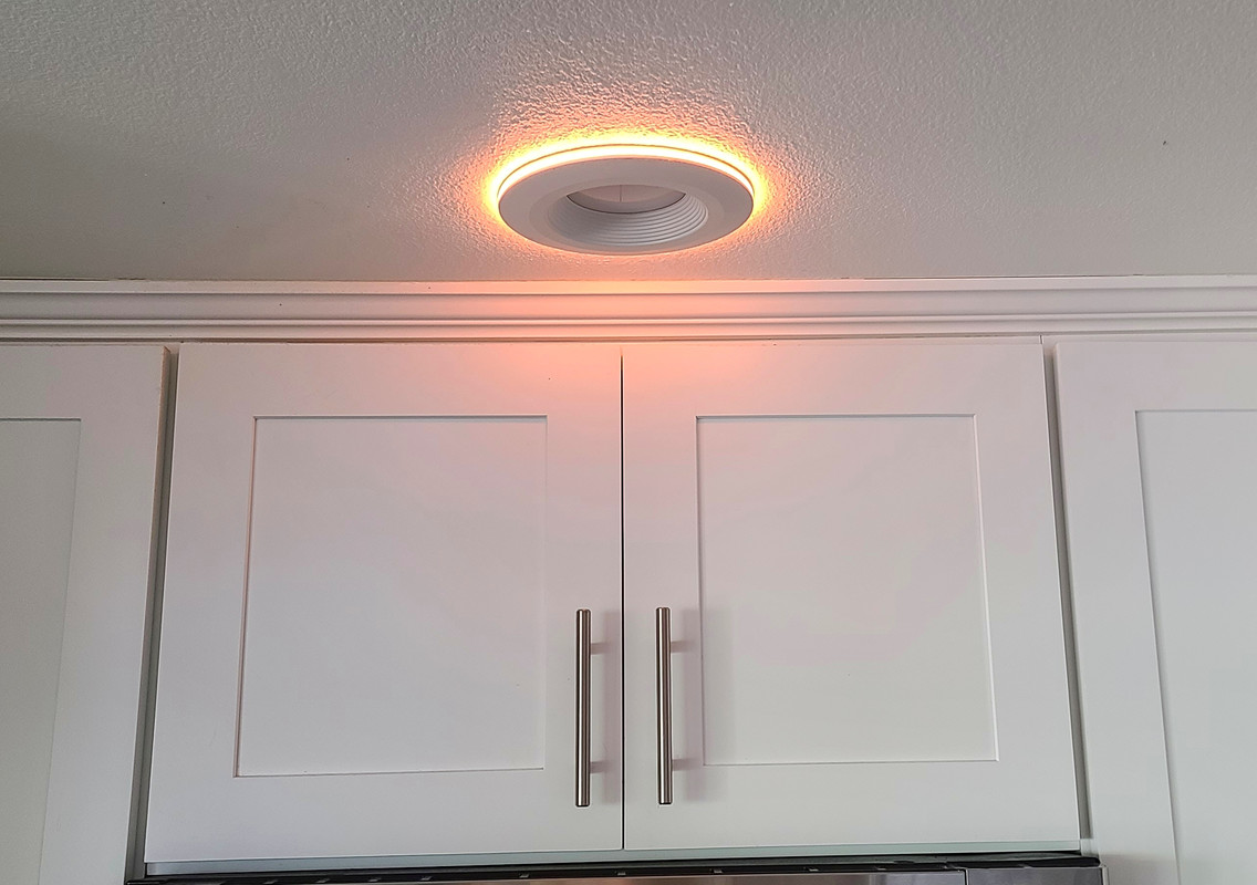

These are an excellent choice for low voltage ceiling LED flush down lighting with CRI options and unique nightlight feature. I have these installed and love them.
Check this out on Amazon
Commercial Electric 6 in. Selectable Integrated LED Recessed Trim Can Light with Night Light Feature 5 CCT 670 Lumens Dimmable (4 Pack) Amazon.com
