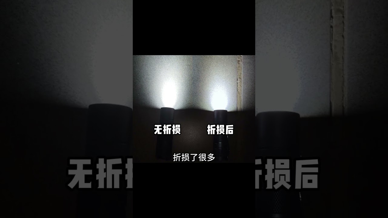

The video, however, I find scientifically inaccurate:
First, a parabolic reflector (illustrated with orange rays) is not a 球面镜 (spherical lens).
Second, just because a TIR collects a greater proportion of the emission into the hotspot does not imply that it throws farther–by that reasoning every TIR should be able to out-throw every reflector, which is not true. So the claim that TIRs out-throws parabolic reflectors in general is provably false. The video also does not account for loss via stray light in a TIR, which is usually higher than the absorption loss in a reflector.
Given the same size, the choice between TIR and reflector is down to beam profile preference and has little impact on throw. What the TIR achieves, by collecting a greater proportion of the emission, is a bigger hotspot. Not brighter, just bigger.
