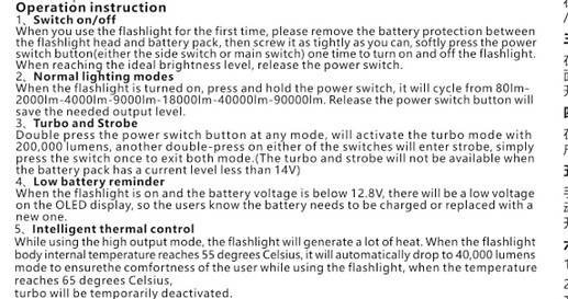

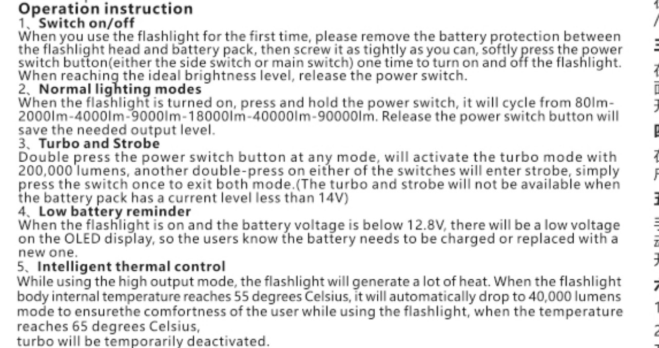

This stemmed from after I took my MS32 out on a walk for the first time. I noted after a while I could not use Turbo, High I (40,000 lm), or High II (90,000 lm) anymore. When I got home and checked the manual, thinking I had maybe a faulty light, I saw this passage: “The turbo and strobe will not be available when the battery pack has a current level less than 14V.” Which is fair enough; however there is ZERO mention of High I (40,000 lm) or High II (90,000 lm) being locked out.

So they had misunderstood that I was complaining about runtimes. After explaining that I am not concerned about the runtime / step-down times; I am not complaining that Turbo / High modes don’t run very long / step down too fast, I again referenced their own manual which only states ONLY Turbo and Strobe are unavailable when the battery pack is below 14 V, and that the runtime numbers you quote are about how long a mode stays at that brightness from a full charge before stepping down – not about locking out modes entirely once the battery voltage drops - which is what is happening on my unit. It would make zero sense to charge the battery to full and retry, as that completely defeats the issue at hand? If I charge to full, then I could not show how the higher modes are locked out when they should not be; below 14V? I had to wait until below 14V to do the test as this is quite literally the crux of the problem!
I basically summarised it as only one of the following two can be correct, either:
  1. Imalent’s manual is currently incorrect, and it should say that, under 14V, Turbo, Strobe, AND High III (90,000 lm) and High II (40,000 lm) will be locked out. Meaning that yes, if I receive a replacement, then that this is expected behaviour. However the manual remains incorrect.
  2. My unit is faulty, and indeed only Turbo and Strobe should be locked out when below 14V.
Again, they replied quote:
“I have carefully reviewed all your comments. Our manual is not incorrect, but we did not explicitly state that the 40,000-lumen and 90,000-lumen modes cannot be activated when the voltage is below 14V. This is because the manual only highlights points deemed crucial by our engineers. We do not include every minor detail of the product, as doing so would make the manual overly lengthy and less user-friendly. We kindly ask for your understanding regarding these omitted details. We sincerely appreciate your feedback, which I have forwarded to our product engineers. They will prioritize addressing your concerns to enhance the user experience.”
