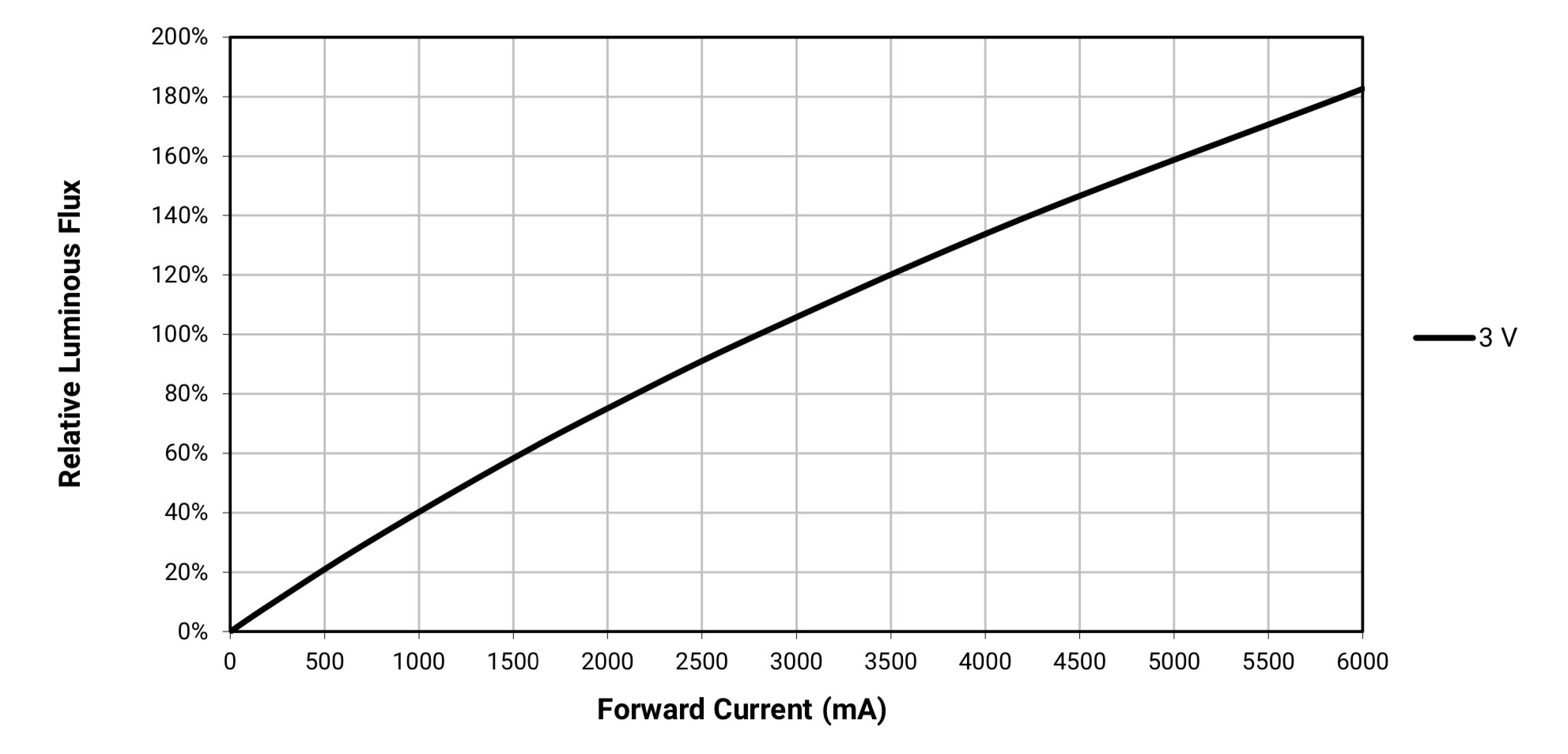

Ah, sorry. At 3V it’s 2.8A that makes 1000-1200 lumens.
This chart shows in percentage, so if a 5000K 90 CRI is shown as making 1000 lumens at 2.8A this chart shows relative percentages.

Wattage (Max) : 9.8 W @ 3.0 A
Absolute Maximum Rating
Pulse Forward Current IFP 2400 mA

Cree rates the XHP-50.2 at 5000mA. Just sayin.
It peaks up around 9 or 11, I forget.
Edit: From the data sheet…
Maximum drive current: 6000 mA (3 V), 3000 mA (6 V), 1500 mA (12 V)
