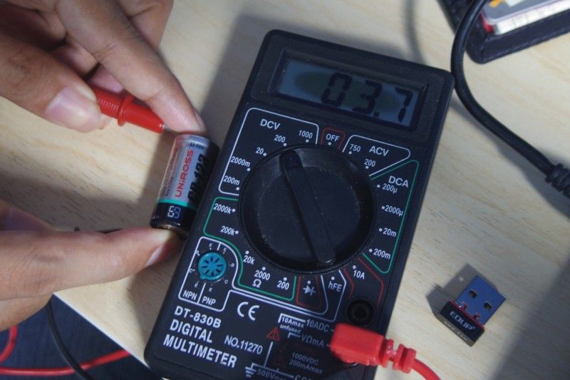

Thanks for all the answers, I will check the voltage later tonight and post it here.
Confirmed, it’s just the same 16340 batteries.
Is that full? If so it’s a 3.0v and not Li-on.
Yes, it’s full.
I thought that 3V cell will display 3V on multitester.
But then I tried other 16340 batteries, ranging from 3.7-4.2 volts.
Now I’m confused :smiley:
