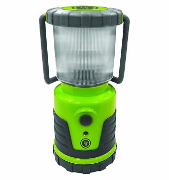

Or should I just get this one, is $30 shipped a good deal?
Ultimate Survival Technologies Pico Lantern (Green)
(Seems to have good reviews here: Amazon.com)
The unit you mentioned is a good choice, though there are hundreds of good “small” lanterns to choose from. I usually modify most of my lanterns with warmer tint LEDs. It really depends what your looking for and the purpose you plan to use it. Camping, Power Outages, long-term storage, battery versatility, etc. Some lanterns are better for different purposes than others.
