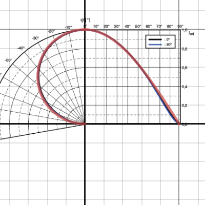

This works only for no-dome LEDs such as the black flat, white flat, or CFT90. (but it can do other LEDs if you put in some effort)
These LEDs have an intensity that follows Lambertian distribution, which means that the intensity of the LED is proportional to cos(angle), making it very simple to put inside the calculator.
If the LED does not follow the Lambertian distribution, a special function needs to be used instead of cos().
Here you can see that flat LEDs have almost a perfect Lambertian distribution (orange line), although the intensity drops slightly faster at large angles near 90 degrees, so the lumen numbers given by the calculator are a slight overestimate.

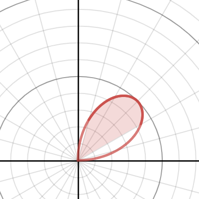

The calculator:
By setting the intensity (candela) and LED die size based on test or datasheet info, the luminance is calculated (cd/mm^2) and then you can adjust the min and max angles of light collection.
For example, the CSLPM1.TG has 171cd and 515 lumens at spec.
If we put 171cd intensity and 1.59*1.25 = 1.9875mm^2 die size we get 86cd/mm^2 and 537 total lumens.
As I mentioned earlier this is a slight overestimate because of what you can see in the first image.
Correcting for non-lambertian distribution:
Here I used cos(1.025*angle) instead of just cos(angle) in order to make the function match the datasheet more closely:
Putting that into the calculator then gives 514 lumens, extremely close to the 515 spec.
If we do the CSLNM1.TG, we get 324.5 lumens from the calculator, again very close to the rated 325 lumens.
If you want to do other LEDs that don’t have lambertian distribution you need to take a screenshot of the datasheet relative intensity graph, overlay it on the desmos calculator with some transparency, adjust the size so that it matches, then use trial and error to modify the cos() function until the orange line matches the image from the datasheet.
