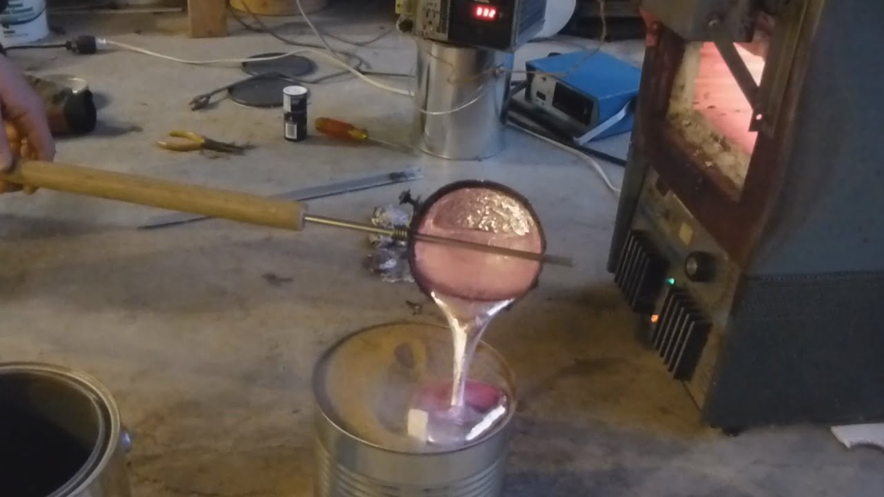

this is HIGHLY frustrating. You first have to MAKE enough heat to melt the aluminum. THEN you have to have “more” because things start cooling down q-u-i-c-k once out of the furnace. At THAT elevated temperature (above liquidus)? Things are happening like… your melt which is a precious commodity? Is “burning off” into aluminum oxide quite steadily.
raise the temps of the furnace more to give yourself more time? you start burning it off like lighting paper on fire, lol… aluminum cans, which is of course the most popular “thing” to melt to GET molten aluminum at home? Has got to be one of the crappiest sources of aluminum going.
you see, when you melt metal (as any self respecting bullet caster can tell you?) you have to have a big load of the source metal… you melt it, and you pick out the “crap”, and theres plenty of it. Its called “dross” and its the waste equivalent of “slag” from making steel… its a total waste product.
The dross is lighter and riding on top of your melt… and its POROUS so, its sucking up your precious commodity of melt like a sponge. You have to “flux” the molten liquid, which makes it all smooth and creamy temporarily, allowing you to mix it thoroughly… and the waste comes up top where it can be pulled off to the side withOUT sucking up metal like a sponge… and you have a very limited time window of opportunity to accomplish this.
THAT leaves the final melt of very much cleaner metal? which you can now make clean INGOTS from.
but, you still havent made diddly *&^% yet… when you have enough ingots of the right size? you can NOW get a melt going, with the clean metal… which of course is oxidizing off at the same temperatures, but, its a ton easier to flux THAT clean melt, drag off the tiny bit of dross, then you can get a nice clean “pour” into your mold.
its basically the same procedure as making bullets at home (i am a bullet caster, i got my technique down pat) to do this with aluminum. The problem is scaling everything UP. Higher temperatures… much higher… greatly shortened working times… higher and quicker oxidation (basically your precious melt evaporating steadily).
melting pots are GONE, your working with a big furnace, and putting a little “crucible” in it, and working out of THAT. For some idea of what i am going thru? i have a a coal furnace (a big one) simply ROCKING, the size/shape/thickness of the crucible? are all fairly critical.
its all a dance, and its frustrating.
a smaller diameter crucible? heats up fast, but, it doesnt HOLD enough melt for what i want to pour.
also, to “flux”, i have to get down IN THERE into red hot molten aluminum with tools and flux. it should be obvious that the small diameter crucible that works well, is way too small to “work in”.
thinner crucible? heats up awesome, but, it burns thru in a time frame measured in “minutes”.
thicker crucible? actually nice, and, it wont burn thru quick… but, its now getting too WIDE to be any good. A whole coal furnace’s heat, on a 3 inch diameter thick walled ductile ironpipe and base? thick enough it lasts… but, only the bottom inch or two is glowing cherry red like it needs to be. the DROSS from aluminum cans? theres so MUCH of it, that it forms a thick cap on top of the small melt, and theres more dross than melt… and i havent even made the ingot yet…
cant even get a “pour off” into a fluxing container? because what little melt is under the thick layer of dross? solidifies up the sides of the pipe trying to pour. and the dross is sucking up even more of the precious melt like a sponge.
I just today, paid 31 dollars for a couple inches of thick ductile iron pipe, with a thick cap on it… i got it working okay? but… the DROSS from the cans? is so bad and so much of it, that it gummed the whole thing up, its now useless.
you cant MELT dross, its no longer aluminum… its mostly aluminum oxide, which wont melt.

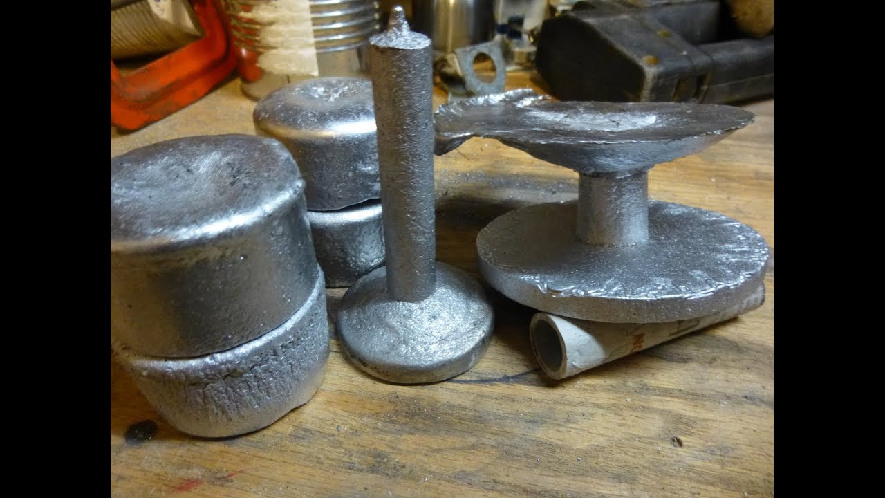

my only “success” has been when i accidentally made ingots, by a small thin crucible burning thru, and retrieving the shiny puddles and sawing them into shape for re-melting… which of course burns thru another crucible.

so… what am i GONNA do? glad you asked…. quitting is not an option. My couple of small “wanna be ingots” i saved up and got one small GOOD melt fluxed and poured? worked good enough i am machining ONE small flashlight out of right now.
