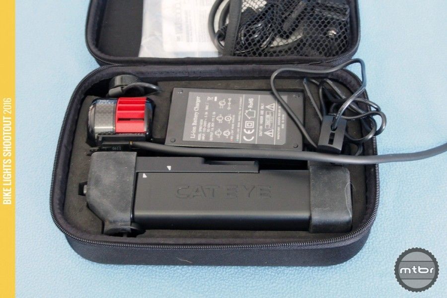

Just came across the review in a subscription. As I find more info, I’ll post here. It really looks impressive
(IMPRESSIVE PRICE TOO!)
now someone make a budget one.
800$ for exactly what?
Even the best 60W COB doesn’t cost more than 50$ for the end-customer and a battery-pack doesn’t cost $700…
ANd like Pilotdog said, this thing produces only flood. Not what you need when you go downhill fast.
Just get an M43 Meteor and bike mount it. Sorted. $600 still in your pocket and a better light on your bike or in your hand.

The Cat Eye’s active cooled COB concept is directly on target for anyone who spends a great deal of time bicycle ridding in dark isolated environments. The large even spill beam and decent range would be a very welcome addition for someone like me. Im amazed at its tiny size and light weight; especially while being able to manage the amount of heat it must dispense. AND it can run at max output continuously! :bigsmile: While it may not produce the long beam range of my hot rodded SRK, I can’t run the SRK in turbo for more than 5 minutes without overheating, and thats while traveling 20+ MPH through cool night air. I doubt my car could overrun the SRK at normal freeway speeds, so its often a waste having such a beam on a bike that must be kept in a medium mode to prevent overheating. Well, at least the remote pack prevents it from cooking the cells… and it will run forever with the large pack.

I respect cateye’s guts for going all out with this. It seems well designed given OUR standards. Personally, I don’t care for mules (all flood) even when on trail but it seems like the ultimate trend with the influential MTB community. The price is NOT budget however, it is comparable to brands like hope, lupine and the many others that have PREMIUM prices.

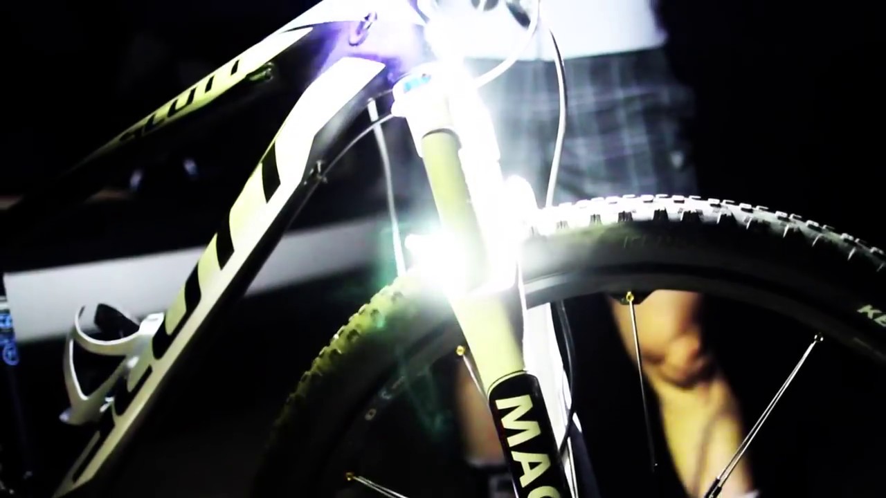

This guy has the right idea but the wrong emitter and needs a real reflector (the cheap glass optic is a huge lumen killer):
As time marches forward, our unscrupulous Chinese copy cats should easily be able to replicate the cat eye or similar, and at a small fraction of the cost. I bet its only a matter of time…
