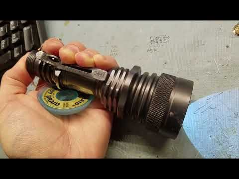

SP01: switch mounted:
driver modified with MELDsc chip:
finished spring/switch arrangement:

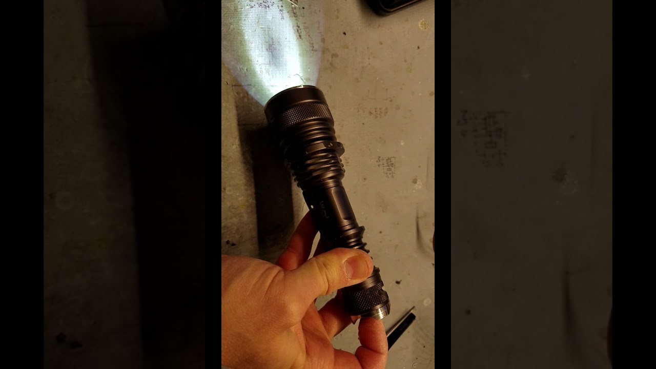

test before modifying tailcap:
G42 with Cell-Slide Switching completed:
