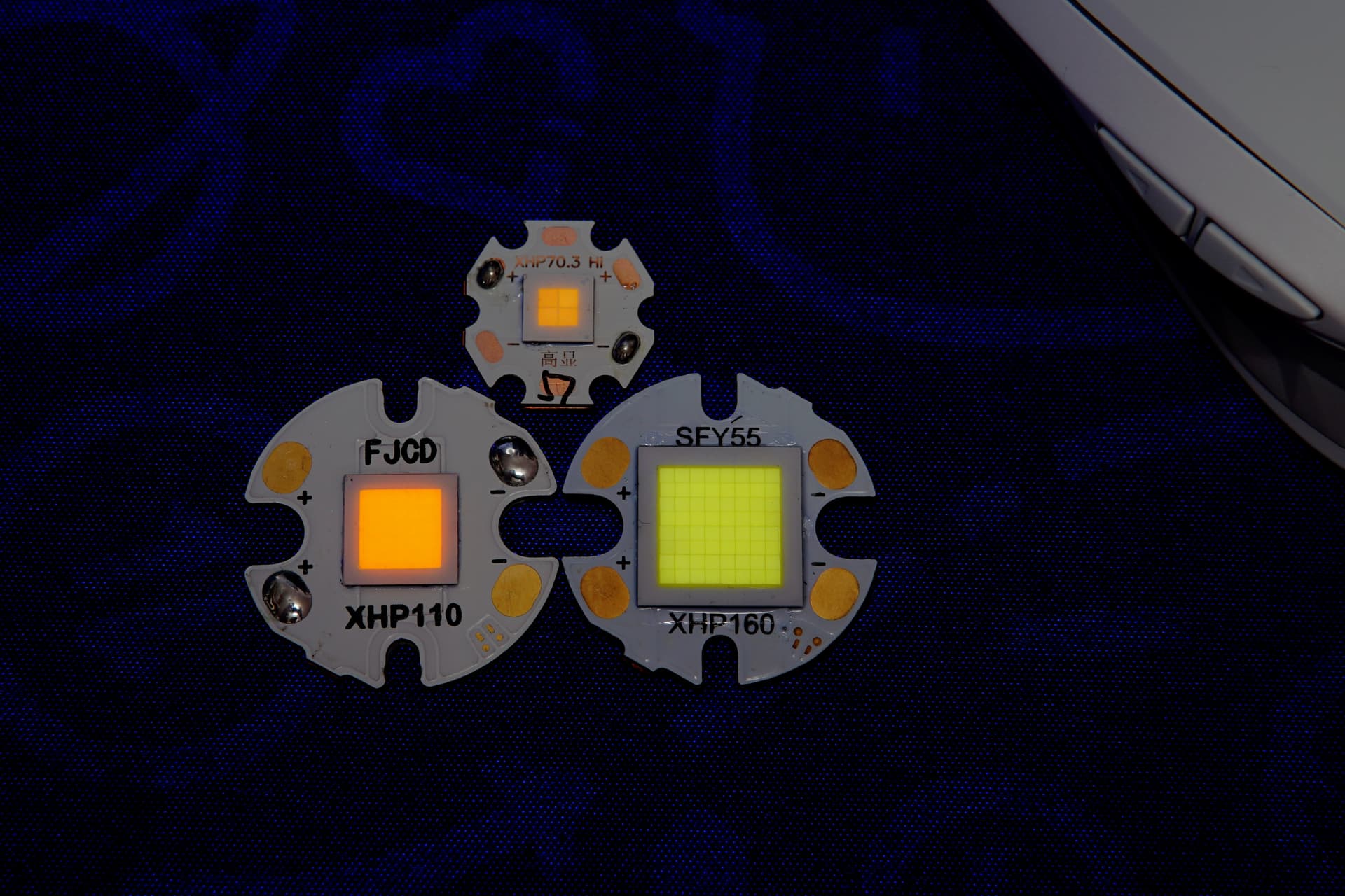

First thing first, does it even fit?
On top is the xhp70.3hi, and the bottom right? SFY55
