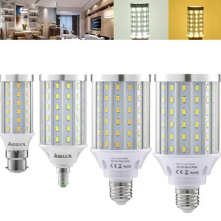

The information on the fixture is for incandescent or halogen bulbs only. It is a warning to avoid overheating the fixture because incandescent and halogen bulbs get hot. As you have discovered, LED bulbs may get warm but you can pick up a bulb that has been on for quite some time and it will never burn your hand. I bought a true 25W LED bulb from Banggood in China with the idea I would use it to replace the overhead bulb in my garage.
It measures 65X145 mm so is quite a bit larger than an ordinary 100
W bulb. It was so bright you never would want to look directly at it. The same area is now well lit with seven 50cm, 36 LED bar lights spread across the garage. You don’t sear your eyeballs if you look at one. When I buy these “corn bulbs” I use cool or natural white. A bulb with 64 5730 LEDs cool white gives 720 lumens and is equivalent to 60W incandescent. I have a few 108 LED bulbs for places where I wanted the equivalent to a 120W incandescent bulb. What a great improvement over the CFL bulbs that my local electric utility got us to use for energy efficiency.
