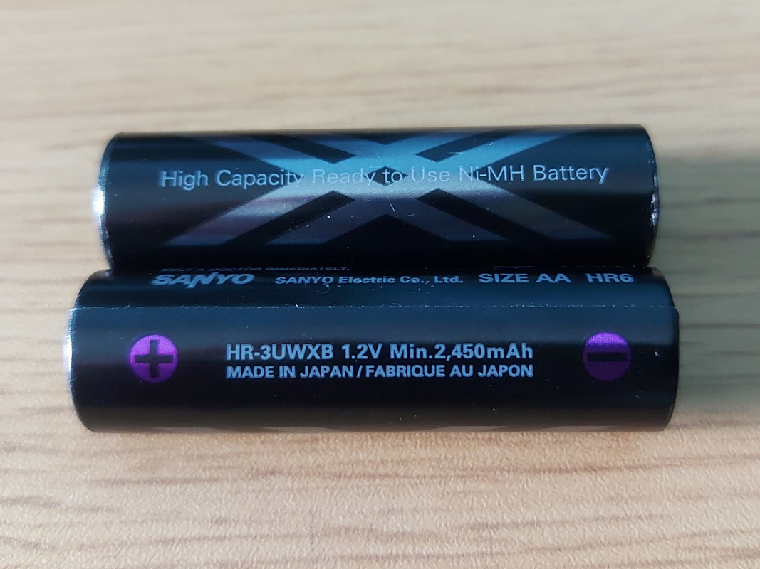

I have bought Sanyo XX Eneloops AA 2450mAh in early 2010 and they have been sitting 95% of the time in drawer unused.
Yesterday after putting in 3 batteries I noticed LED turns on for several seconds and then starts blinking. Had to use Camelion charger to force battery to charge. Then I see LED blinking for another battery. And that considering it has been charging for hours. Did CC17 charger decided it is no good later?
I think these Panasonic chargers for eneloops were developed with planned obsolesce motive to get consumers to replace their rechargeables even when resistance readings are not bad enough to warrant the replacement. Maybe I should have bought general charger with advanced functions to cycle batteries.
