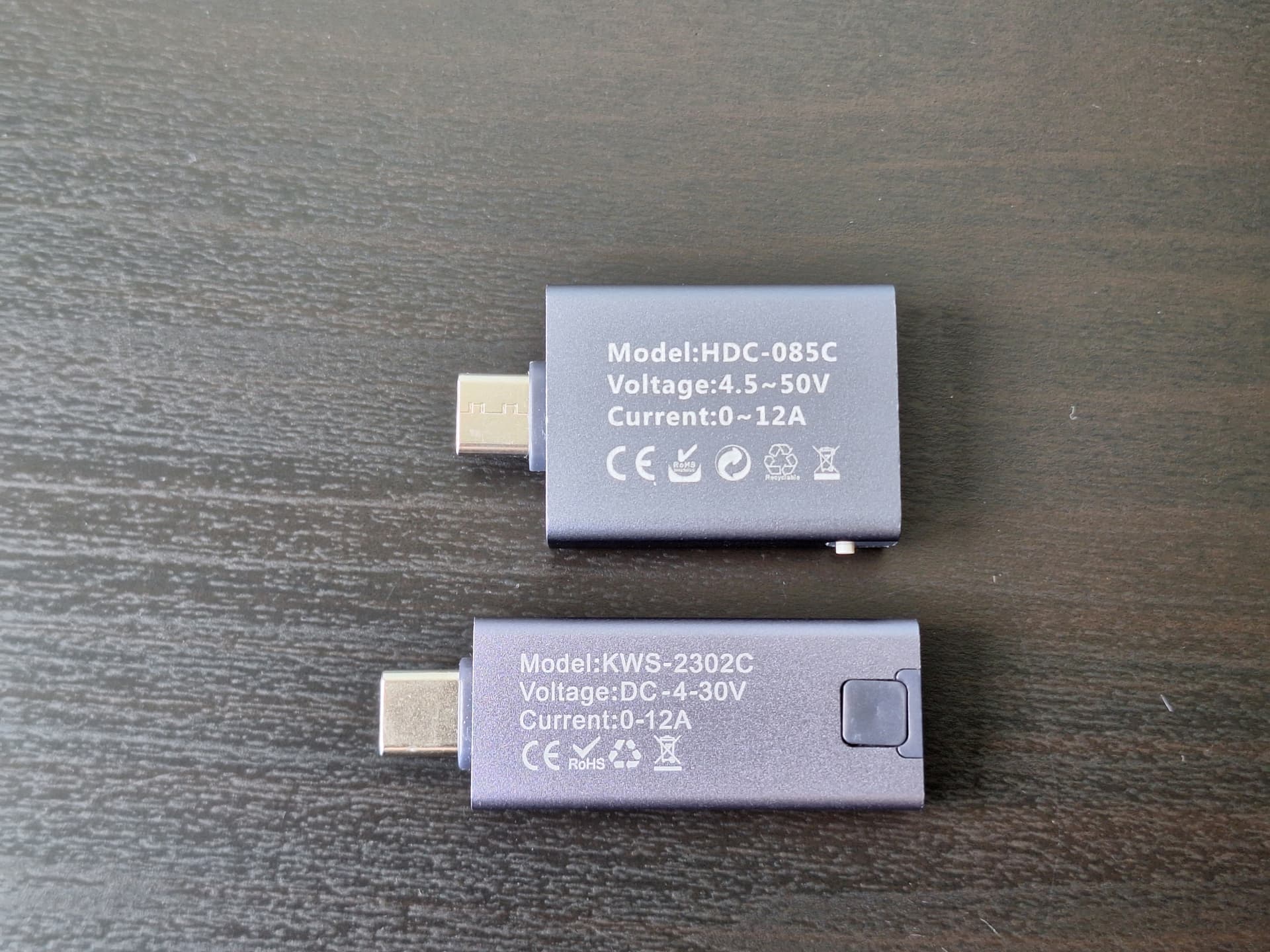

Most of the important things already mentioned in this topic, but just a tip if you want to have a bit more peace of mind for a few $:
It might be worth purchasing a (cheap) USB-C to USB-C, 2-way USB meter, like the 2 models showed below. I believe I’ve paid between 5 to 6 euro each for them on Aliexpress.
Regardless how accurate they are, they at least give you an idea in which voltage mode (5, 9, 12, 15, etc.) the device/flashlight is being charged and at (roughly) what amps and/or watts. That way you can more easily spot if a charger (or device) is acting weird. You can also compare numbers between different chargers to see in which way they behave different.
The only downside might be that it sometimes might be difficult to directly plug these meters into a flashlight, if the USB-C port is recessed, due to a rubber protection flap for example. The upside is that then you could also plug it directly into the charger and measure it that way, since both meters work in 2 directions.

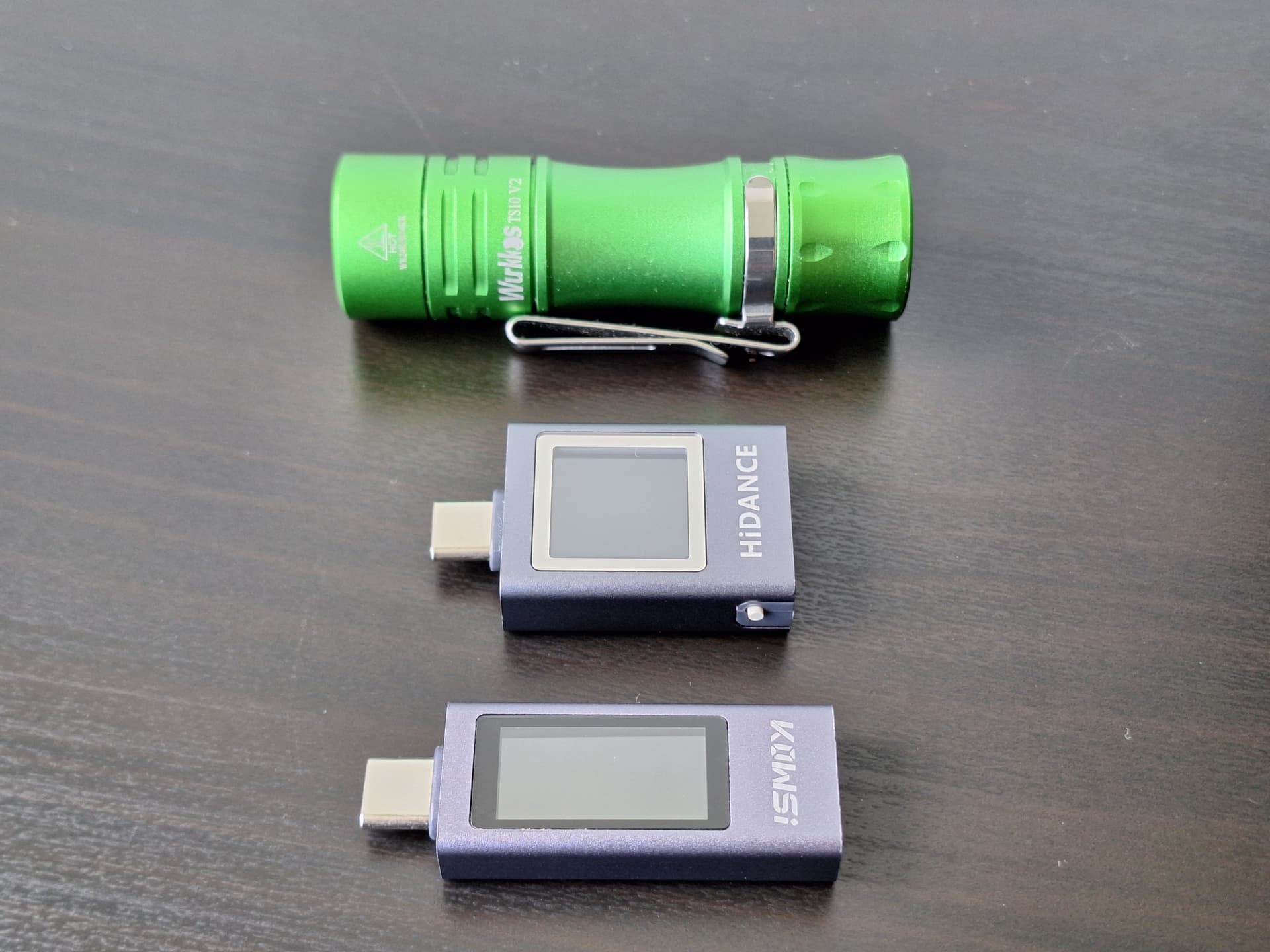

I have put in a Wurkkos TS10 for scale in the first photo:
And a photo I took recently from the ‘Hidance’ one in action, used to register the total charging time of a device:
