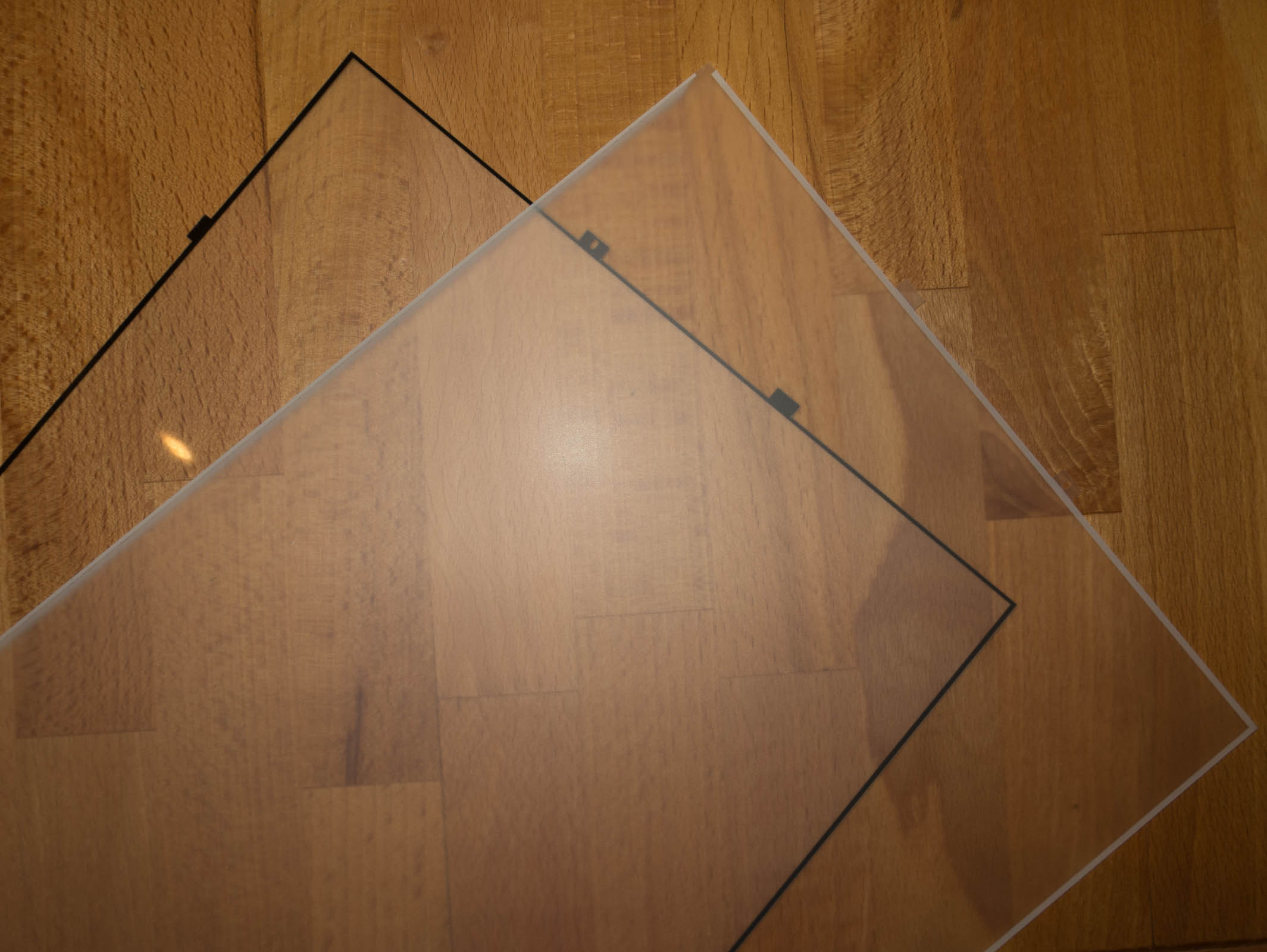

Can you post a picture so we know what to look for?
two diffusor foils from LCD panel

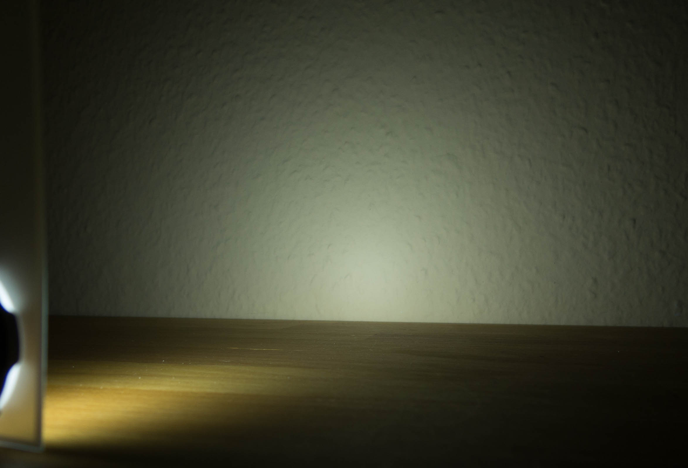

without diffusor

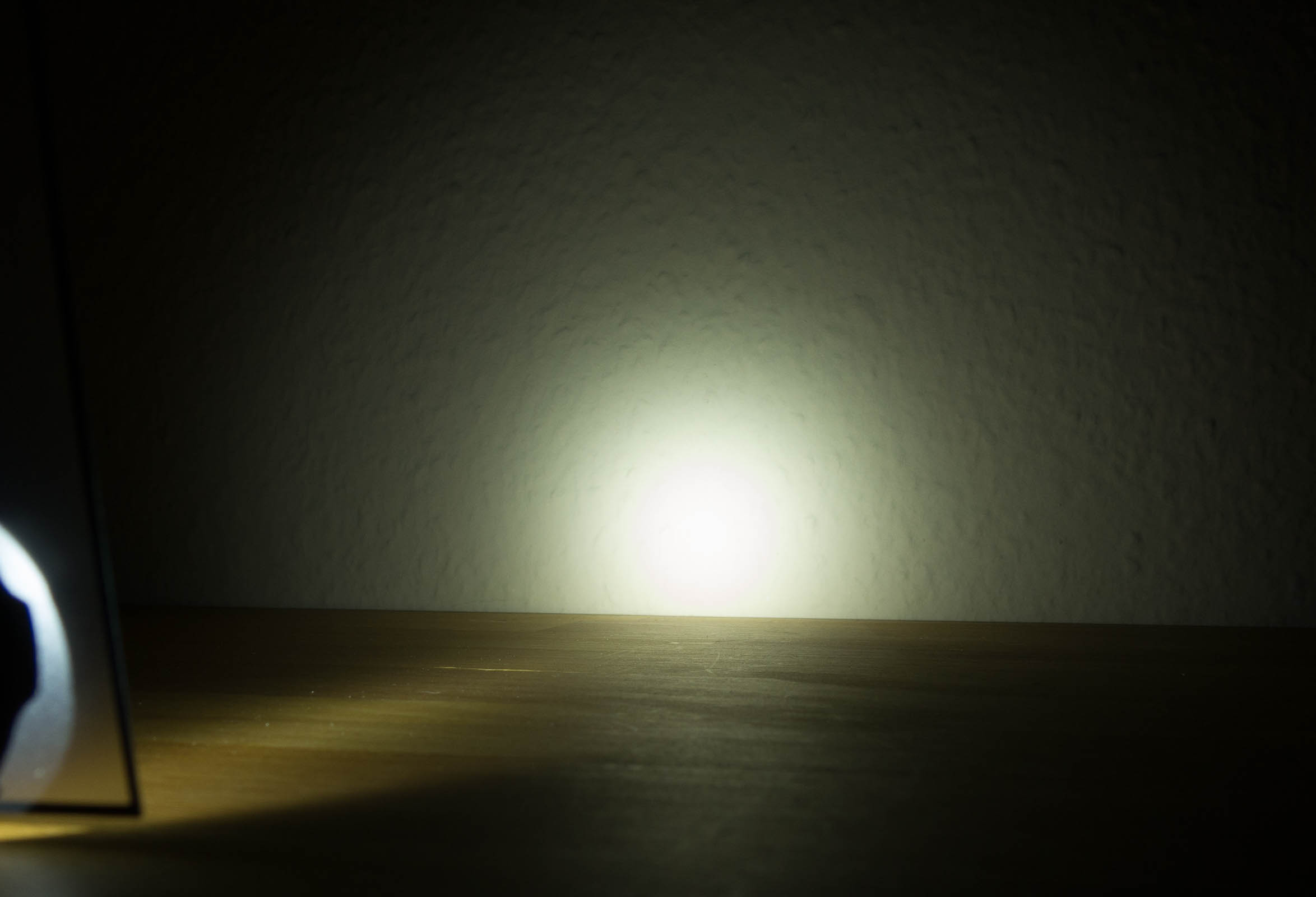

with soft diffusor

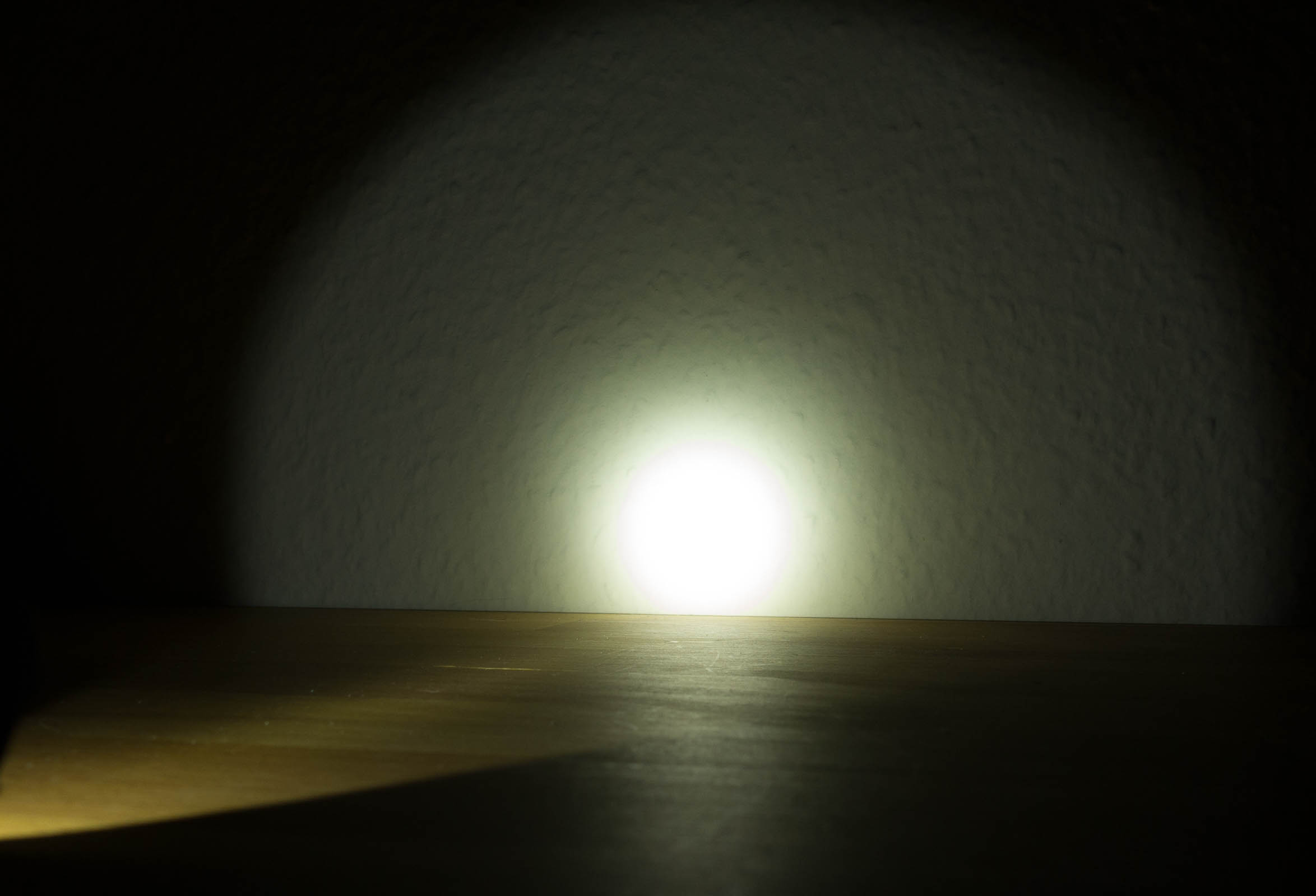

with strong diffusor
