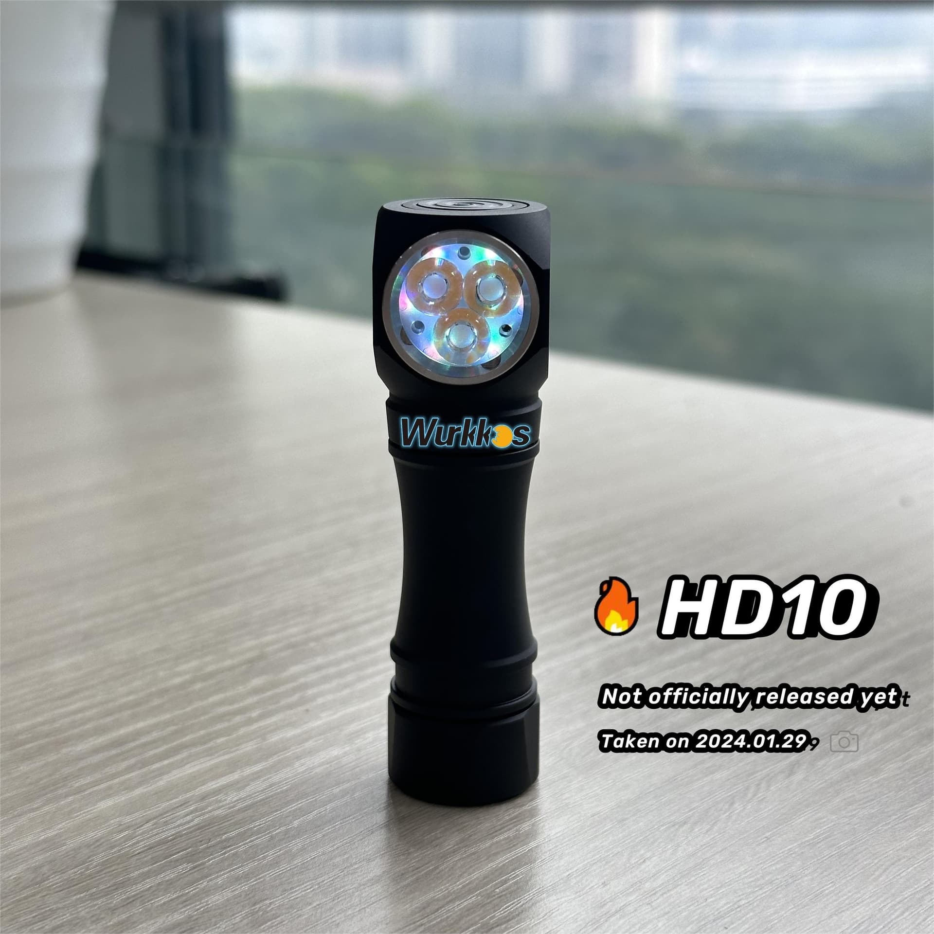

Wurkkos is currently working on this 14500 headlamp which looks really fun, but no idea if it will come with 519As:
I’m waiting for that one, hope it will be good. Might replace my HS10 entirely.

Looks good. I’ve seen something similar form-wise from Fenix incl. red aux. emitter but some lesser CRI main LED and more expensive.
