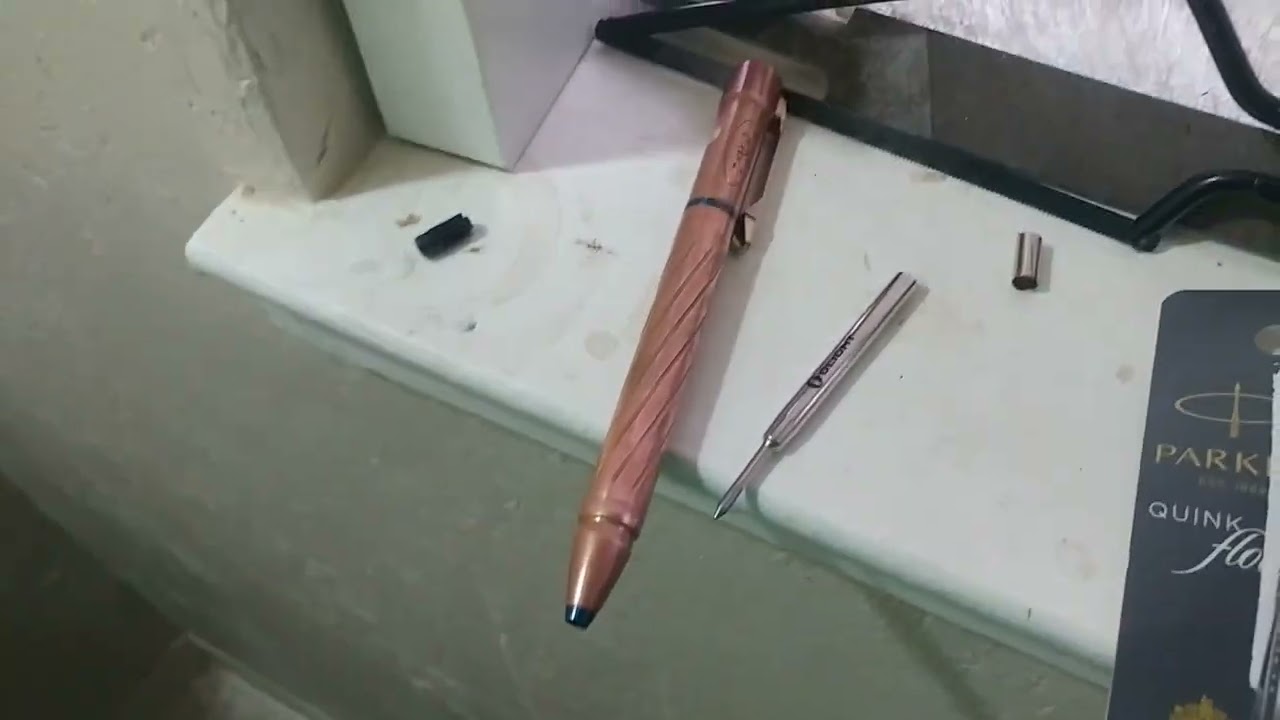

I didn’t want to wait for the 2 recommended refills to arrive, so I went to the closest office store and managed to find a “parker” refill with roughly the same size shaft (its a little longer, but stretching the spring is an easy fix)
I basically just lined up the pen tips at the bottom and then marked the top, with the caps off.
I used a cheap hacksaw, very slowly. Then gently reamed out the inside so the olight cap fit in the Parker refill, becsuse it was a little rough after using the saw to cut some length off. (If there is a better way to cut, let me know)
Surprisingly, even after taking over 1/4” to 1/2” off, I hardly reached the ink/ink sealant. (Pretty shady on their part but whatever)

If you can manage to find something local that is longer but has the full metal shaft, you can easily mod it in 5 minutes and will be cheaper than the azprintsmith adapter.
Here is a video I made. I will post the full process next time.
