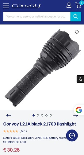

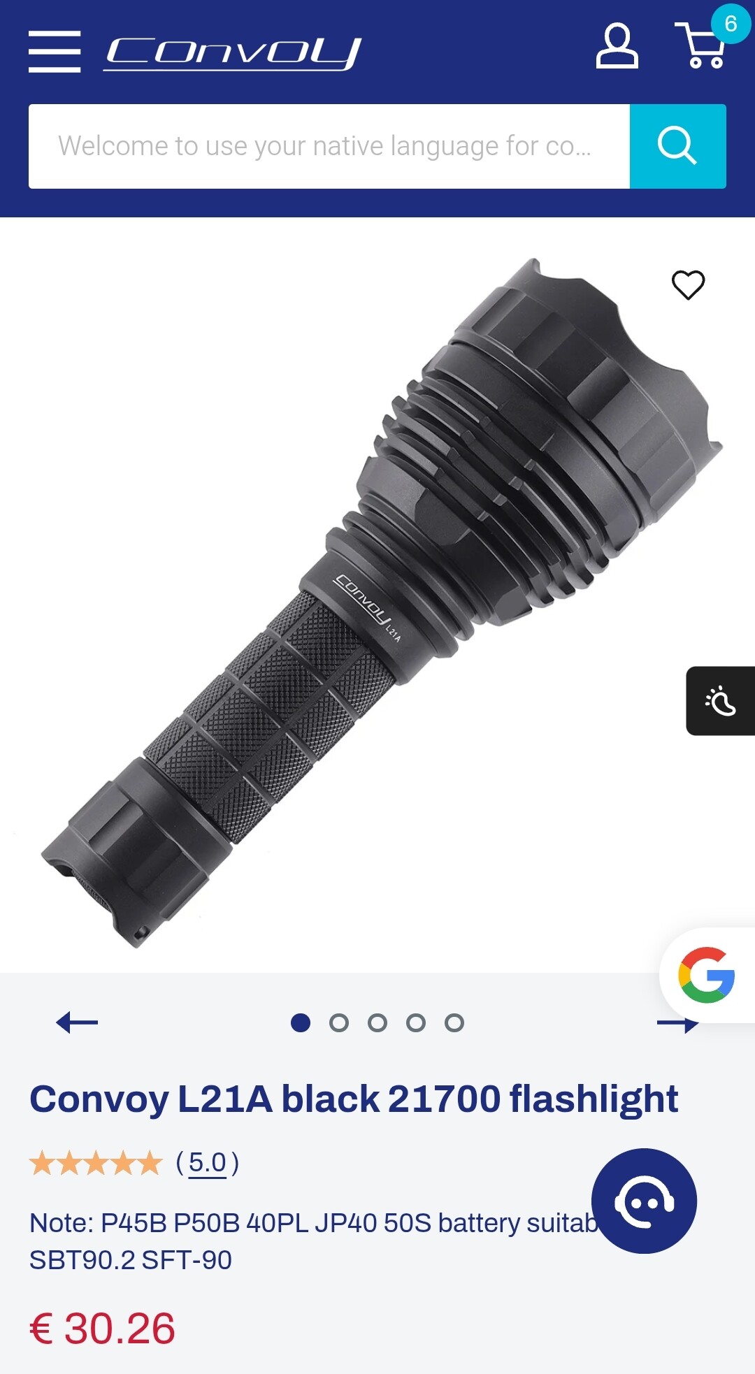

L6 has larger reflector in diameter but slightly shorter than L21A/B
Convoy L21A

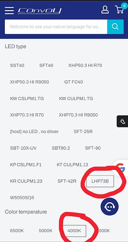

LHP73B 4000K

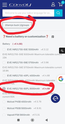

20A buck driver and the battery
Discard the XM-MR 5700K part as you won’t find that LED in the Convoy shop

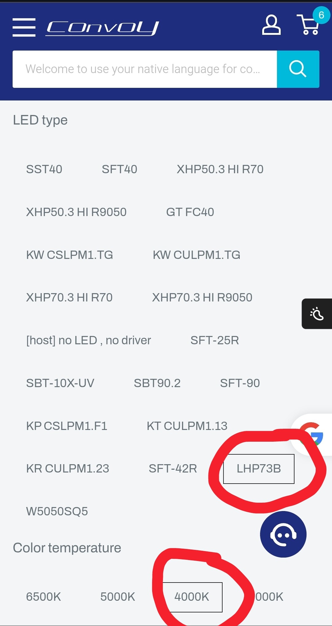

@Toaster79 I’ve attached the screen shot of the page I see. I don’t see that “20amps buck 12groups” option on my page. Other than that, I think I have it down pat.
FYI, my beam shots didn’t turn out well. The L50 has an Osram P9 LED emitter @6500K. Honestly, mine looks to me more like 4000K. Also, the center beam is almost indiscernible, it’s more of a flood light that a spot, which is what we like. The video below has some excellent shots in it. Those are exactly how our light appears.
You’re browsing on your computer, I’m on the phone. Lower down the page should be description where it says what leds are paired with what driver and reflector.

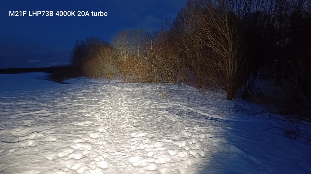

I finally found beam shots of the M21F with the LPH73B LED and at 4000k. This looks like the one, @Toaster79
I wish they’d done it when it was fully dark out. Better than nothing though!
I suggest not getting the EVE PL-50 cells, despite their high performance. They have a high self discharge rate, so they will need to he charged often, even if the light isn’t used. I would get a Molicel or the Reliance RS-50.
@CollectEverything Yes, but I’m sure they’d have only looked even brighter.
@Irons Just when I thought I had it all squared away

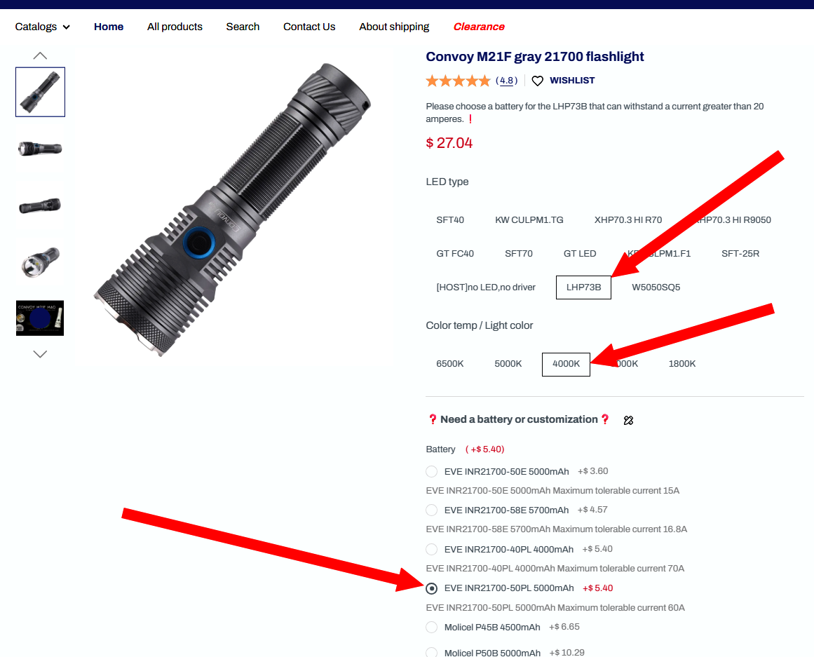

Okay, this is from this page: Convoy M21F gray 21700 flashlight. I’m not sure what it all means but…so which one?
EVE INR21700-50PL 5000mAh Maximum tolerable current 60A
Samsung INR21700-50S2 5000mAh Maximum tolerable current 25A
Reliance INR21700-RS50 5000mAh Maximum tolerable current 70A
@Toaster79 opinion? You’ve been so helpful so far ![]()
INR is the battery chemistry. 21700 is the size. Molicels and the RS50 can all supply the max current for your LED (30A). The 5000mAh cells will give about 11% more runtime than the 4500mAh ones. Molicel has been making reliable cells for quite a while, whereas Reliance is new to the market (as far as I know).

@Irons in researching the cells, mainly the Reliance INR21700-RS50, the EVE PL-50 cell keeps popping up as THE one to beat. Nonetheless, I don’t know what the deal is because some are saying the “A” version has a high self discharge rate but the “B” version is good. Either way, I just need a battery and the RS50 seems like it’ll be it. Thanks for the tip on the PL-50, potential problem avoided.
@ToyKeeper thanks for all the information and advice. It must’ve taken a bit to compile that and I appreciate it. Nevertheless, I think we’ll stick to using just one light. If I told my wife she had to go on the porch at night and then switch back and forth between two lights she’d brain me with one of them. Currently, for our simple needs, the L50’s working out fine. We like it and about my only comment on it would be “a little brighter wouldn’t hurt”. With that said, it works well as is.
The light I’m interested in is this one: Convoy M21F gray 21700 flashlight. I couldn’t find any specific information on candelas per lumen, or cd/lm. IIRC, it’s 4000 lumens max and a 700 meter range? That sound right?
