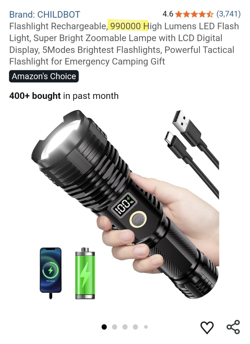

I’ll say the same thing here I did over at CPF lol…It sounds like something that should have old Ultrafire cells in it.
Only 10 thousand? That is an extremely modest seller because the flashlight actually outputs 990 thousand lumens
Jokes aside

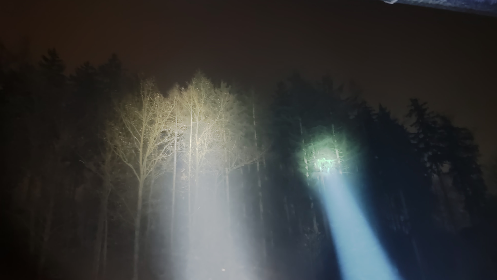

Here for example is a comparison of two identical flashlights but with completely different emitters.
On the left is the LHP73B in 4000K and on the right is the XM-MR in 5700K, same light, same reflector, same battery

Doesn’t that get rather hot?
Which flashlight model are the two lights in the pic?
Running it at full blast it will get hot of course, but they’re checking the perimeter. Also the light has thermal regulation of some sort.
Convoy L21A
LHP73B 4000K, 20A buck, EVE 50PL
XM-MR 5700K, “12A” FET, EVE 50PL
Both with SMO reflector
@Toaster79 Gotcha, I was just wondering because I have an M21F with a 70.3 Hi in it. I’m curious if the LH35B LHP73B gives you more or less sustained lumens.
L21A
Ahh I see. That looks like the L6 head on a 21700 sized tube. I have an L6 so that’s my point of reference
Edit: I was mistaken. The styling is L6-like but the reflector must be different as it is listed as a separate product from the L6 reflectors on the Convoy website. Looks like the L21A and L21B share the same reflector though so that’s nice to know.
