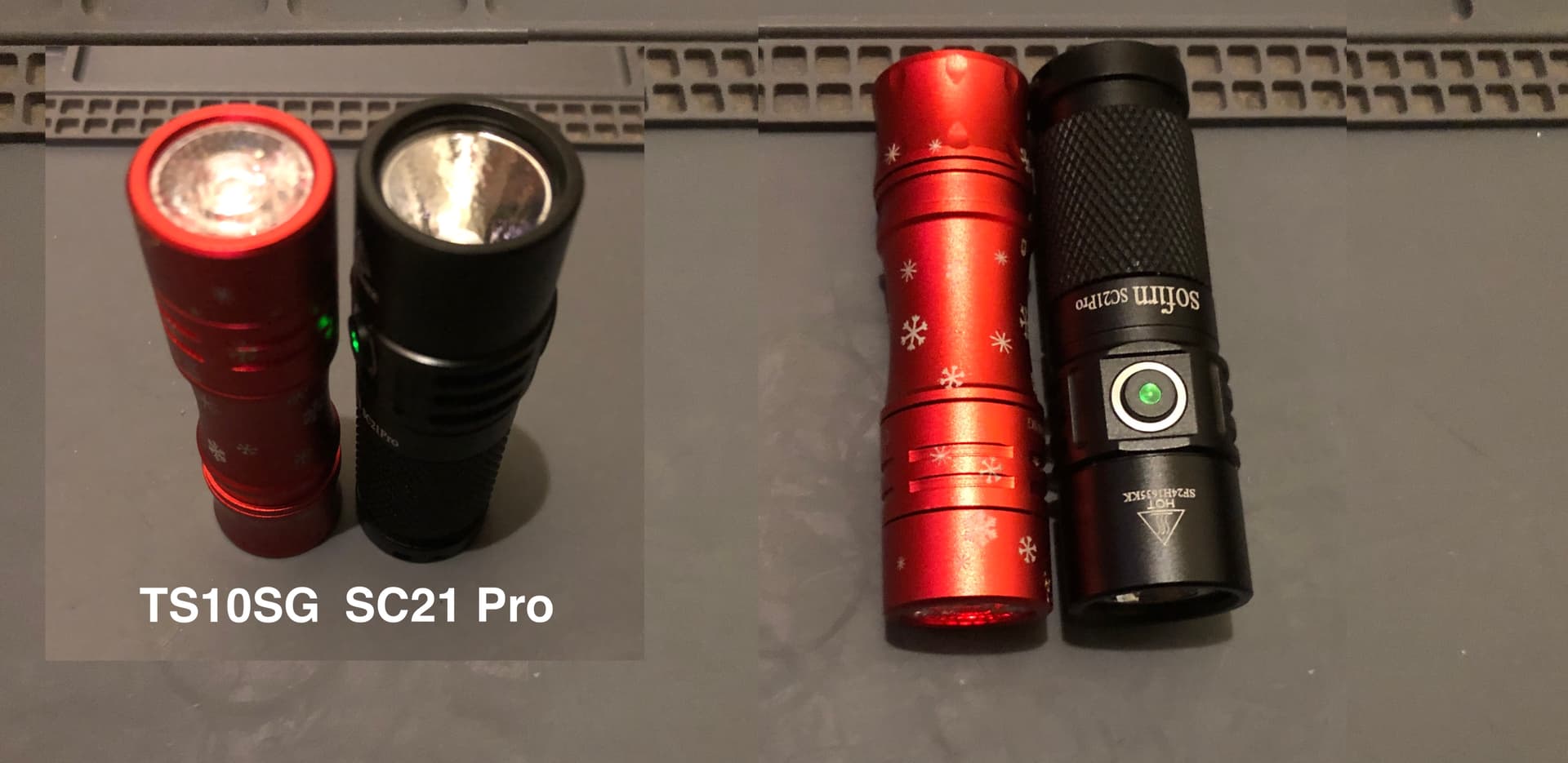

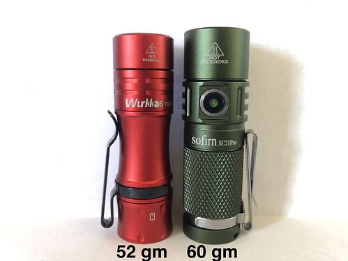

Closest size to a TS10 w USB-C is the SC21 Pro
The TS10 is an SC21 Pro without USB-C charging
SC21 Pro came first, it is 1.4mm fatter and 1mm longer than the TS10
the SC21 Pro has a 16340 battery, while the TS10 has a 14500 battery
Timeline
Sofirn had created the SC21 Pro. It has built in charging and a 16340 battery. It has a lighted sideswitch, a tailmagnet and uses a Reflector with an LH351D 5000K High CRI LED. The beam has a throwy hotspot, plus spill.
Then Lumintop made the Floody FWAA, 14500 and Anduril, no USB, no Aux. Wurkkos modeled the TS10 after the FWAA, and had Sofirn manufacture the TS10 with the driver from the SC21 Pro.
The TS10 is my favorite of the three, because of the tailswitch and form factor.

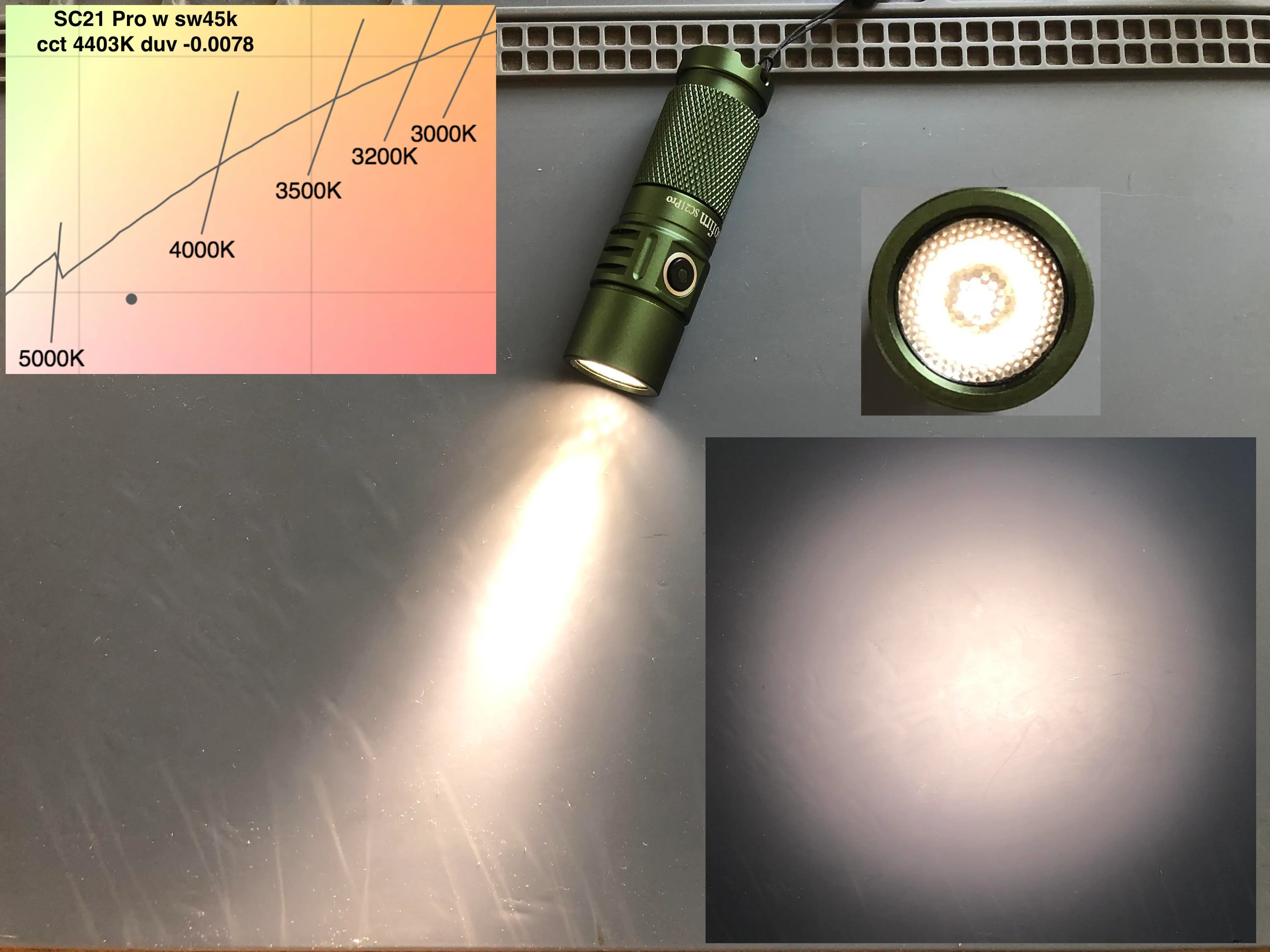

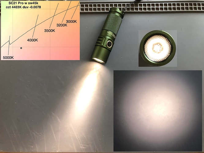

But for a USB light w Anduril, I reach for my SC21 Pro. The LED can be changed to Nichia, and the reflector can be replaced with a Pebbled Tir for a floody beam.

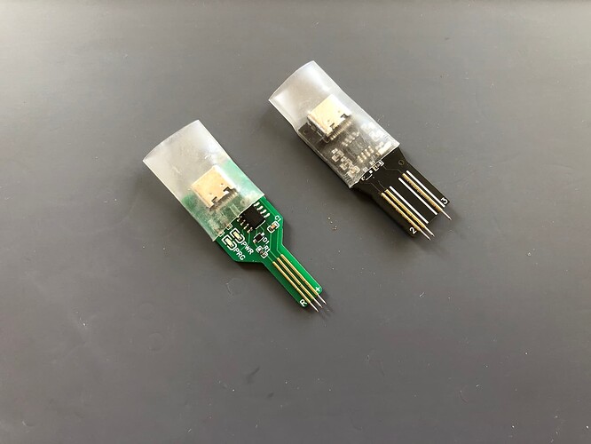

The switch button on the SC21 Pro is tiny and hard to find by feel, but the illuminated button makes it easy to locate on a dark nightstand and while in use. The stock firmware 2022-02-08 lacks LVP on Aux same as on first batch TS10. Firmware can be reflashed to fix that, and add firefly lows.
The unique flashing adapter available from gchart, is not the same as the TS10 flashing adapter.

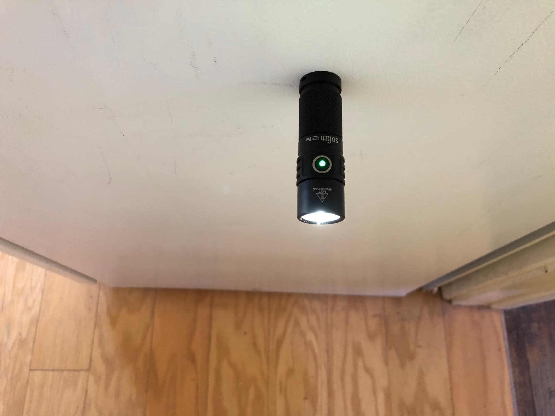

The tailmagnet has good strength, it holds securely to the side of the fridge.
I like this… but as crazy as it seems, that 1.4 mm bigger diameter and no tapered waist sure makes a big difference to the feel of the light in hand or even in a pocket… It just feels a bit porky next to the TS10.
Plus , yes finding that tiny switch by feel is … plainly a PIA.
A 16340 with Anduril and with tail switch like the TS10 would be nice! :innocent:
TS10SG? :partying_face:
Well, the SG is a 14500, but I would like to try a 16340 :wink:
