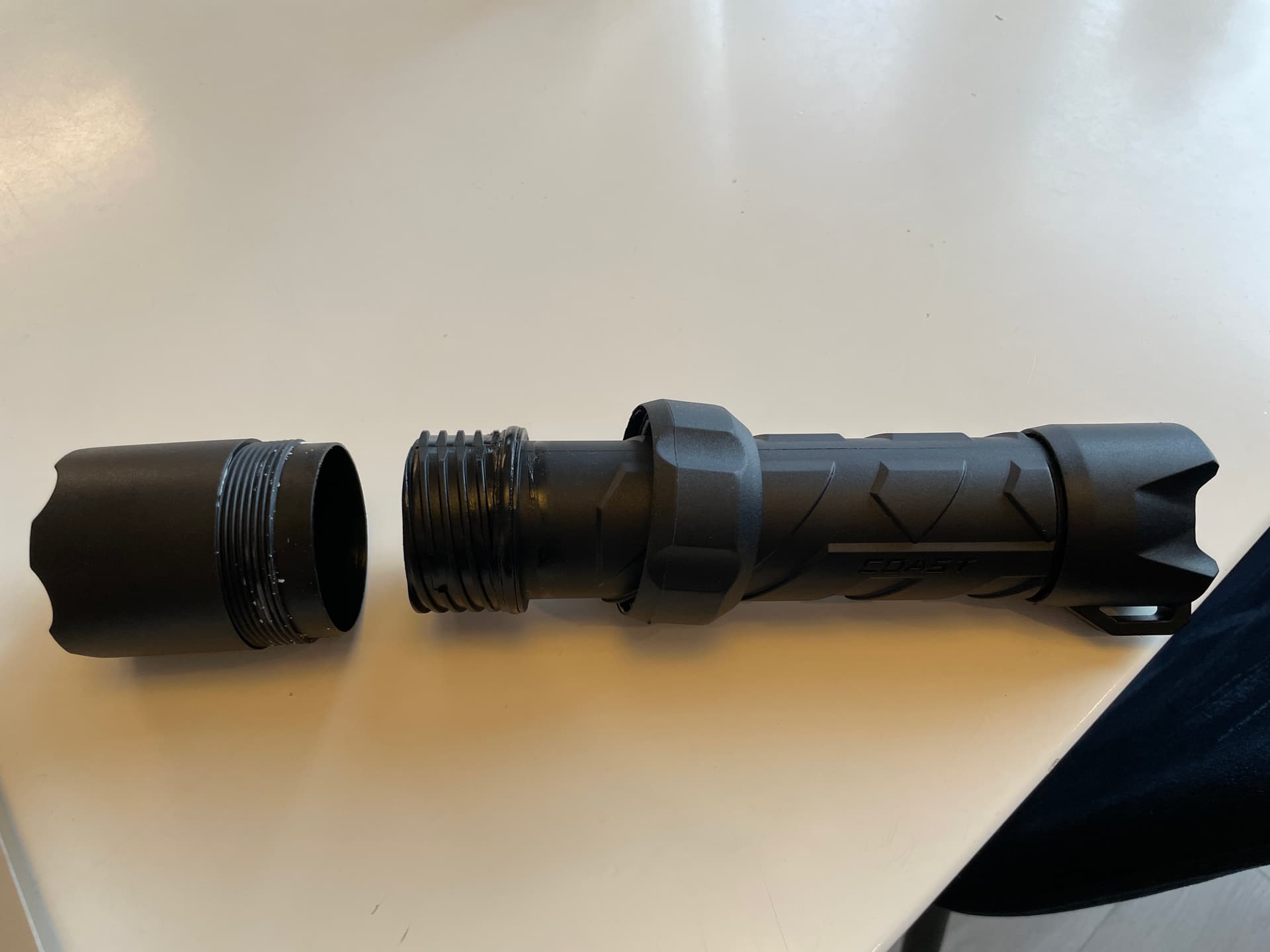

Know this is a decade old thread, but you don’t have to saw it open, just screw the head off. I did so to change the led on my PS400. Planning to change PS600´s led to nichia 519.
Well done, you must have a lot of muscle or good machinery to get the glue loose without damaging the light!
I would like to brag about my strength, but It actually wasn´t that tight. I think the glue was old and dry or something.

Yes, just screw the hell out if it, and it will loosen. There’s an o-ring and its tight anyway, so no problem “destroying” the glue.
