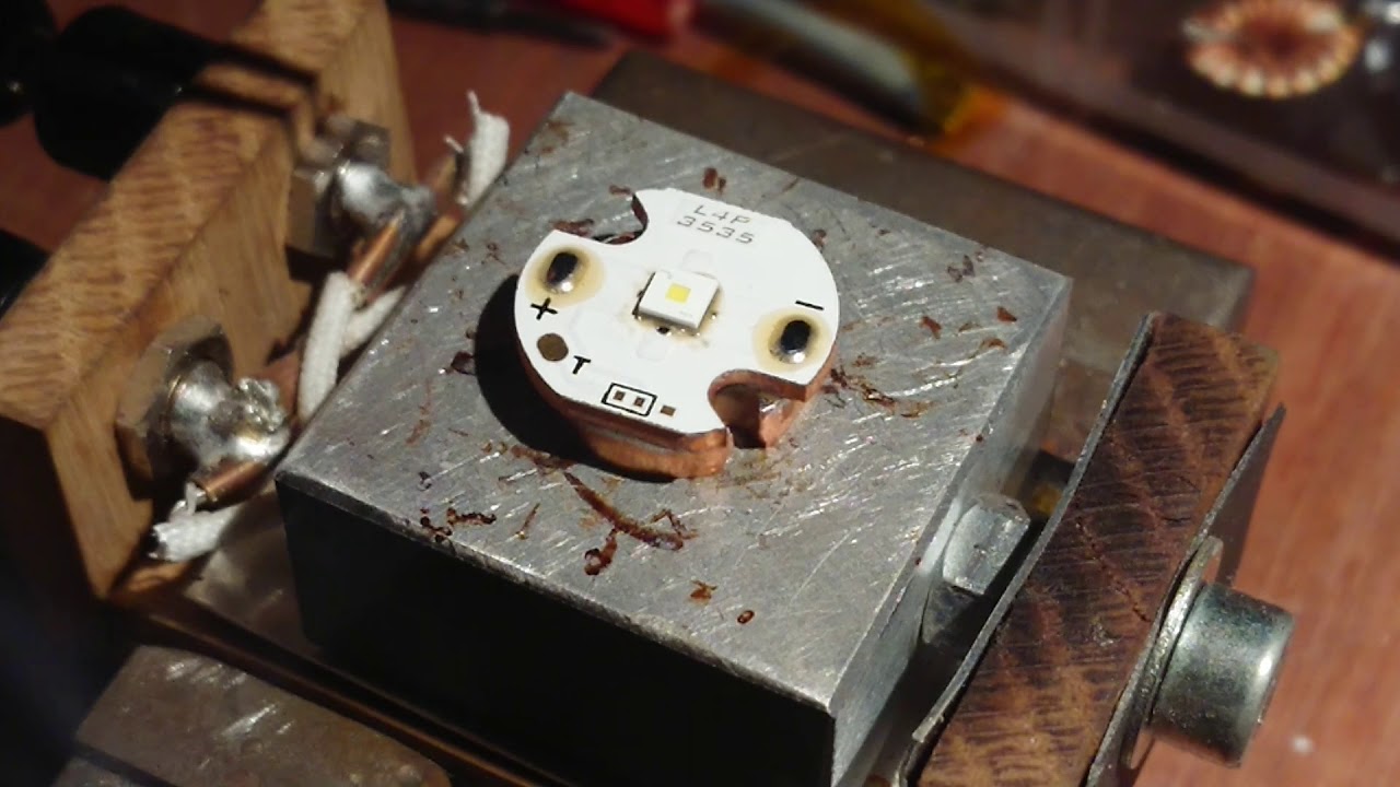

This zoomie has a hollow pill and although normally when using a copper DTP-board that is no problem for the heat path, with this led at close to 5 amps some extra measures are needed, I decided on a little chunk of copper under the ledboard.
The ledboard
After sanding with disc sander and by hand with sand paper, and driling holes for the led wires:
Solder paste was added (yes, I use too much solder paste for the led!)
stacked
the stack was soldered together on my heat block, making sure that the copper chunk was centered well under the ledboard (info on the heat block here: https://budgetlightforum.com/t/-/44420 )
Excess solder on the underside was sanded and filed away

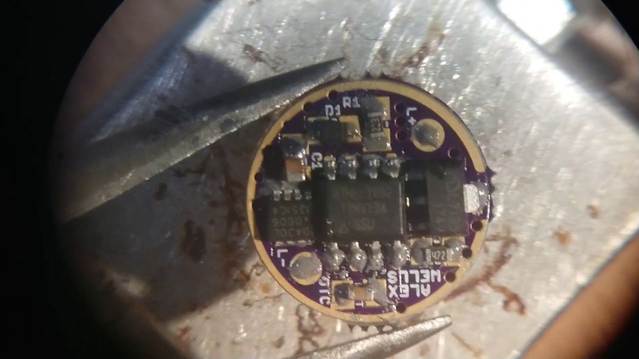

I decided on a BLF-A6 FET+7135 driver, but leave enough resitance in the flashlight to not overdrive the (very low voltage!) Osram KW CSLNM1-TG led. The BLF-A6 driver is a 17mm driver and can not be sanded down to 15mm for this flashlight, but WarhawkAWG a few years ago had made a 15mm version of wight's FET+7135 driver (Oshpark link) that works well with the components unsoldered from the A6 driver, except the FET is too large and should be replaced by a smaller LFPAK33-package FET (bought from Mountain Electronics some years back).
solder paste was applied on the new board.
The yellow BLF-A6 board was put on the hotplate and the components one by one transferred to the 15mm board (except the FET, that came new).
The reflow, accompanied by my talented son
who is learning himself how to wistle
result
it works with my test-led

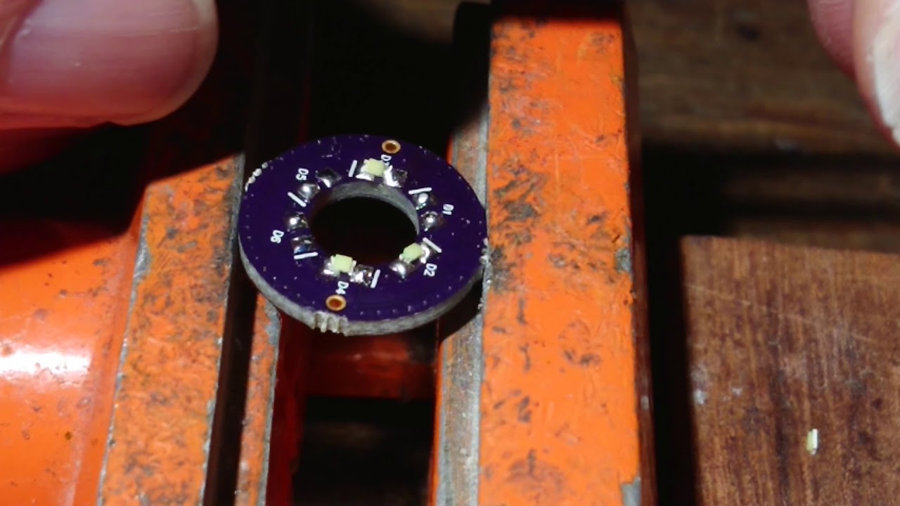

I used a 6-led ring board for the tail leds, made by Lexel. it has pads for two potmeters on the back, but I simply soldered fixed resistors there (2x 8.4 kOhm). The leds are ice-blue 0603 leds. If 10 minutes of your life watching soldering is not too boring
, off you go:
ok, it worked but it was not particularly nice soldering![]()
so I did it up a bit after the video
I had a few tail leds fail over time and I think it helps if the soldering is good.
Two very short copper connection wires were soldered in the ring-board and soldered to the switch-leads. tested with the led-tester, it works :-)
