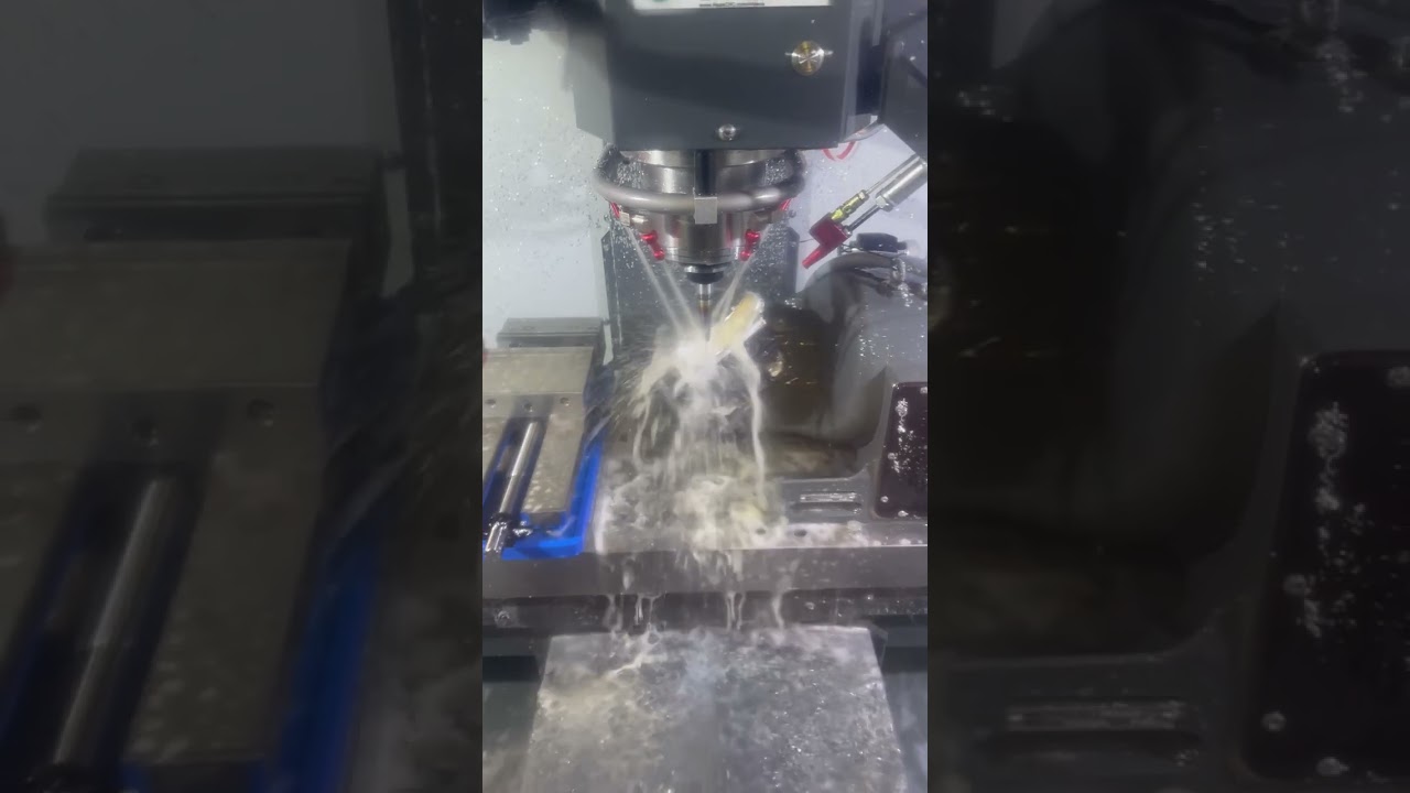

I run two 5 axis mills.
Here is a video of a part I programmed running on my machine:
So if you can make it on a mill. I can make it on a mill.
