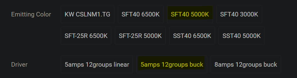

I’ve ordered the Convoy S6 and it just arrived today. I am getting confused on how to select a mode, I am not even sure if I have the “5amps 12 groups buck” driver. The LED is SFT40 5000K. Clicking for eternity, I happen to have accidentally changed to 3 modes. The original mode has a strobe and I didn’t like it so I pressed for 20ish times then it changed to have something like a bicycle light as an addition, and still have a strobe. Then it changed to something with this brightness: very low, low, highest I think, then the last 2 clicks seems to be a “battery check”. Now, upon clicking for eternity again, it has reverse the last brightness. It is now 2 “battery check”, high, low, very low. And I can’t change it anymore, no matter how I click. Did I receive the actual driver that I ordered? I am not that sure.
