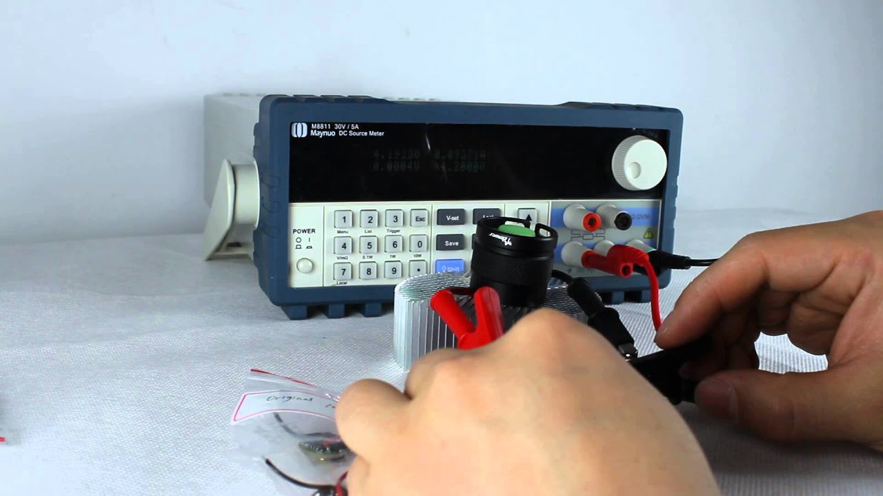

I noticed a new video on the Qlite page:
:slight_smile:
Seriously can’t believe they’re going to that kind of trouble…not many places would! Nice touch…guess it’s time to order some new Q-Lite drivers.
