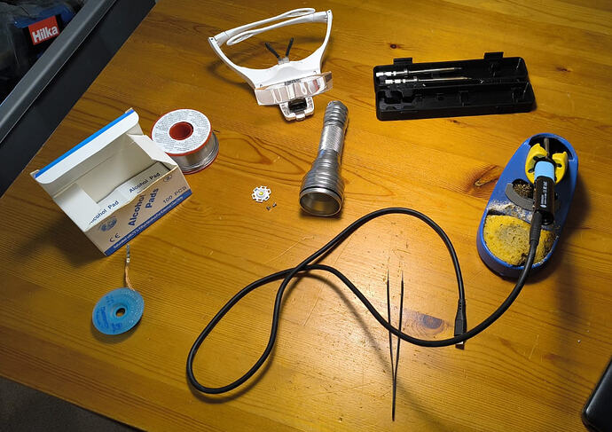

Only just placed my order, but I thought I would prep the light in anticipation! Now to frantically keep refreshing a tracking link…

It seems you have everything you need, if your solder contains flux.
Yep. I’ve done a reasonable amount of soldering over the years. My Convoy order is in the UK now, so I hope to be able to show my results soon.
