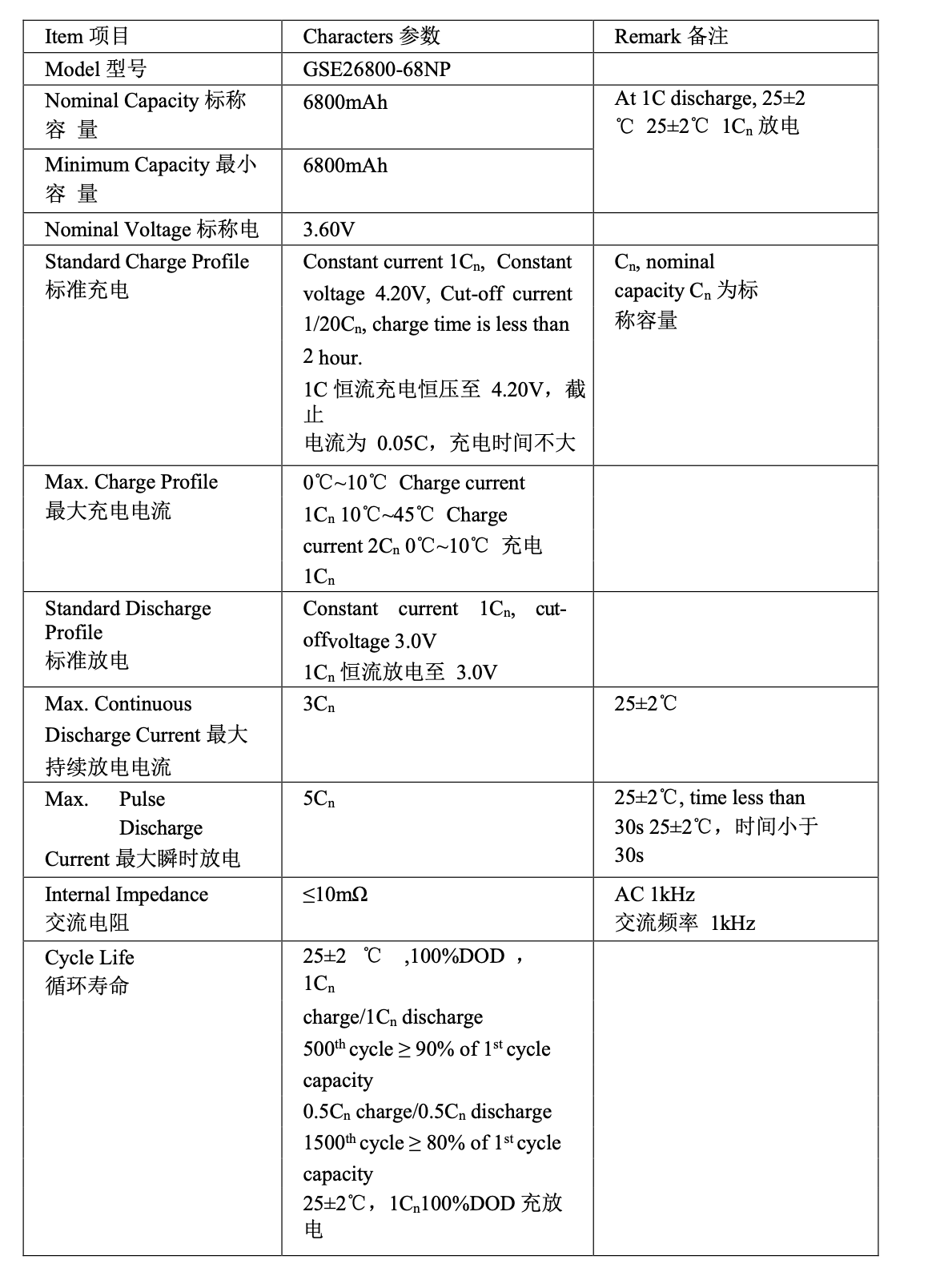

Convoy states that the cells are rated at around 6800 mAh and with a discharge rate of 5C. The cells appear to be the GSE26800-68NP. I found the datasheet on a Ukrainian website.
Паспорт на акумуляторний елемент.pdf (402.1 KB)
Datasheet states a CDR of 3C (20.4A), a capacity of 6800 mAh, and a discharge cutoff voltage of 3.0V (as opposed of 2.5V of most 18650/21700s)

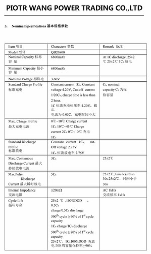

It’s notable that the datasheet for the QB26800 cell is formatted similarly to the datasheet of this cell, although the QB26800 datasheet specifies a discharge cutoff voltage of 2.75V and with lower cycle specs (and later the standard discharge current was revised to 0.2C.) It may be concluded that the QB26800 is a rewrap of the GSE26800-68NP.
QB26800 datasheet (v2):
QB26800 DATASHEET.pdf (252.3 KB)

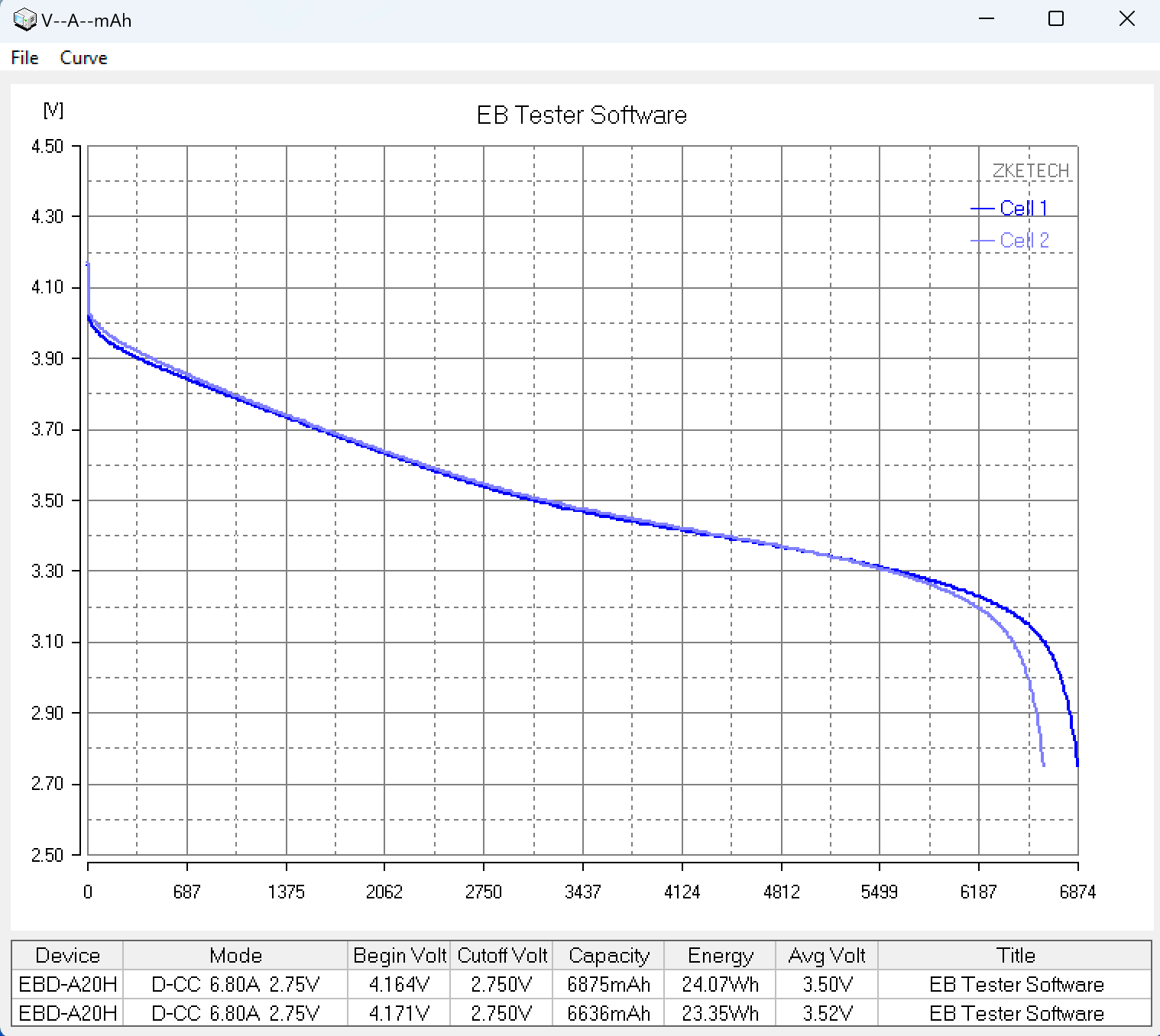

Cell Cutoff Voltage Current Capacity Energy
#1 2.75V 6.8A 6875mAh 24.07Wh
#2 2.75V 6.8A 6636mAh 23.35Wh

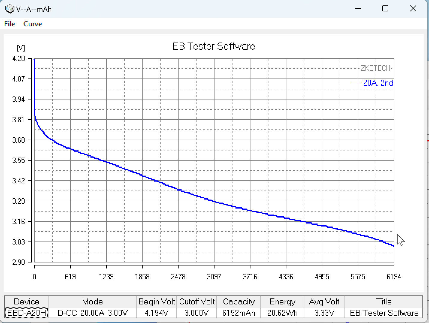

Cell Cutoff Voltage Current Capacity Energy Energy until 3.2V
#2 3.00V 20A 6192mAh 20.62Wh 14.01Wh
The cell reached ~61 C at the end of the 20A discharge.

The cells appear to match match their specifications but aren’t brand new. High current capability seems good but note that the 5C rating from Convoy is for pulse discharges under 30s only. The cells might be identical to the QB26800.

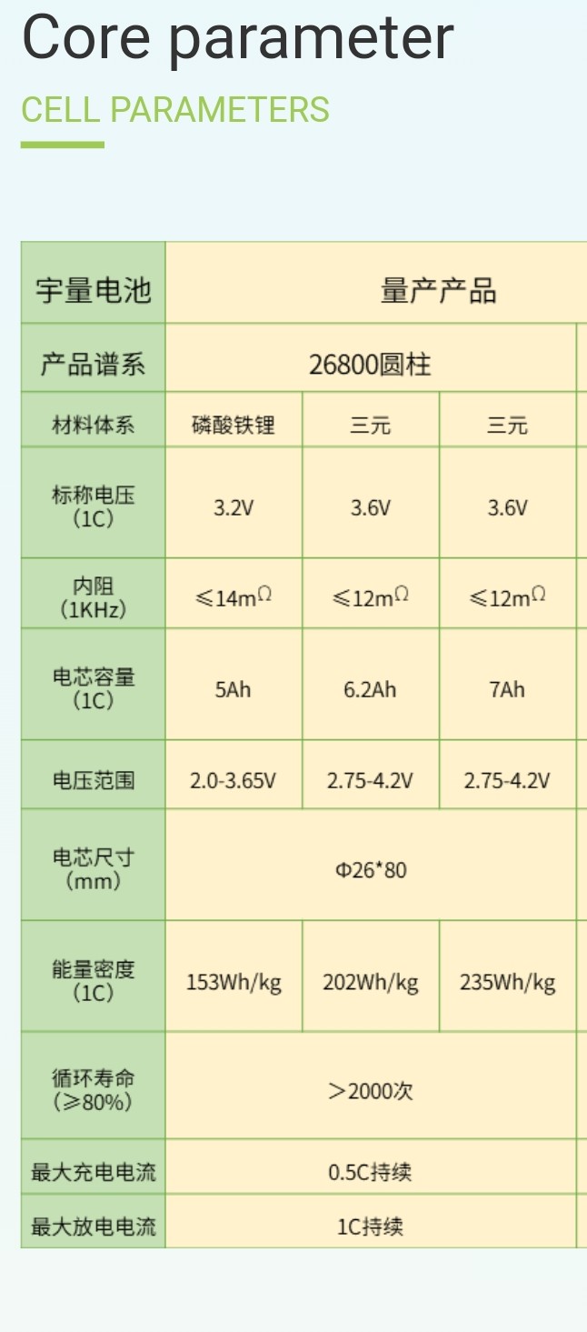

When looking for details on these cells a company called Suzhou YouLion (sometimes translated to Yuliang or YuQiang) Battery comes up a lot.
http://www.youlionbattery.com

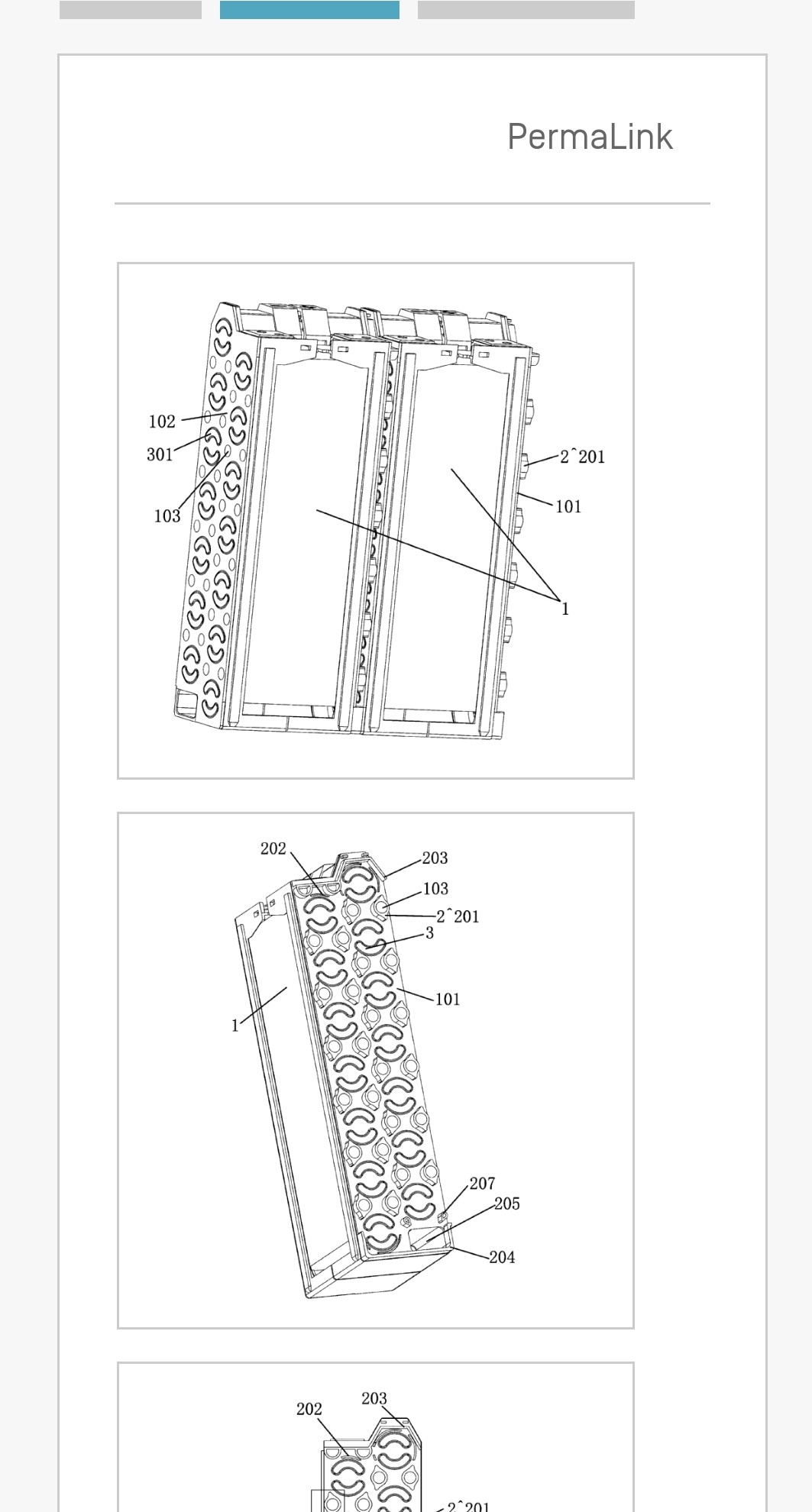

Theres tons of supporting evidence that suggests that, at the very least, they have been one of the biggest manufacturers of 26800s for quite some time. They have dozens of patents involving 26800s dating back to 2016. Here’s one from 2016 for the battery holder that they still are sold in online today.
They’re listed in many reports that support their 26800 production volume claims. They appear to have initially used them in buses in China, though soon after they started offer batteries for passenger vehicles as well, competing directly with bigger manufacturers like CATL and Lishen, though most of these were likely prismatic cells.
https://www.internationalbatteryseminar.com/18/battery-manufacturing

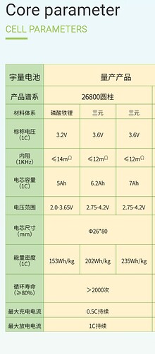

They currently claim to manufacture 26800s in 6200mAh and 7000mAh.
