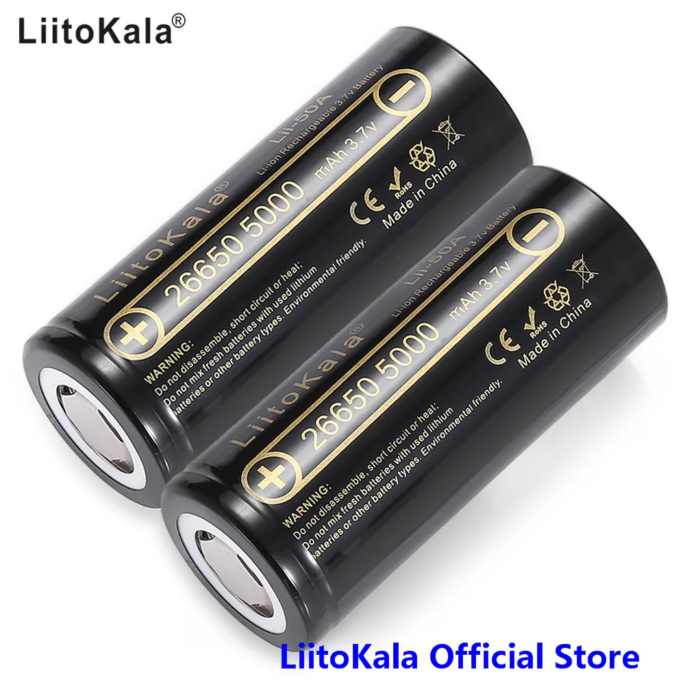

2x liitokala 26650 will be good for this light ? (https://pl.aliexpress.com/item/HK-LiitoKala-Lii-50A-26650-5000mah-26650-50A-Li-ion-3-7v-Rechargeable-Battery-for-Flashlight/32790517311.html)
Not for 2S, I had to solder blob the 4 I bought.
Little magnes in between will do the job in 2s configuration?
They are great batteries and produce a lot of power. You do have to solder blob them, though (the cyan and black).
They also have a new blue 5100mah. Some of them have raised ends, some don’t. It’s a bit of a lottery which one you’ll get.
Keep in mind that the last time I ordered from that store shipping took 2 months to the US (from Turkey). :confounded:
If you are in the US you might also consider the Shockli 5500 mah from MTN. Shockli 26650 IMR 5500mAh
They have raised ends for series use and are quite powerful as well.
This is dangerous and adds a lot of resistance.
I did film me adding solder blobs if your interested in doing it yourself.
Thanks JasonWW ! I will do the blob :laughing:
