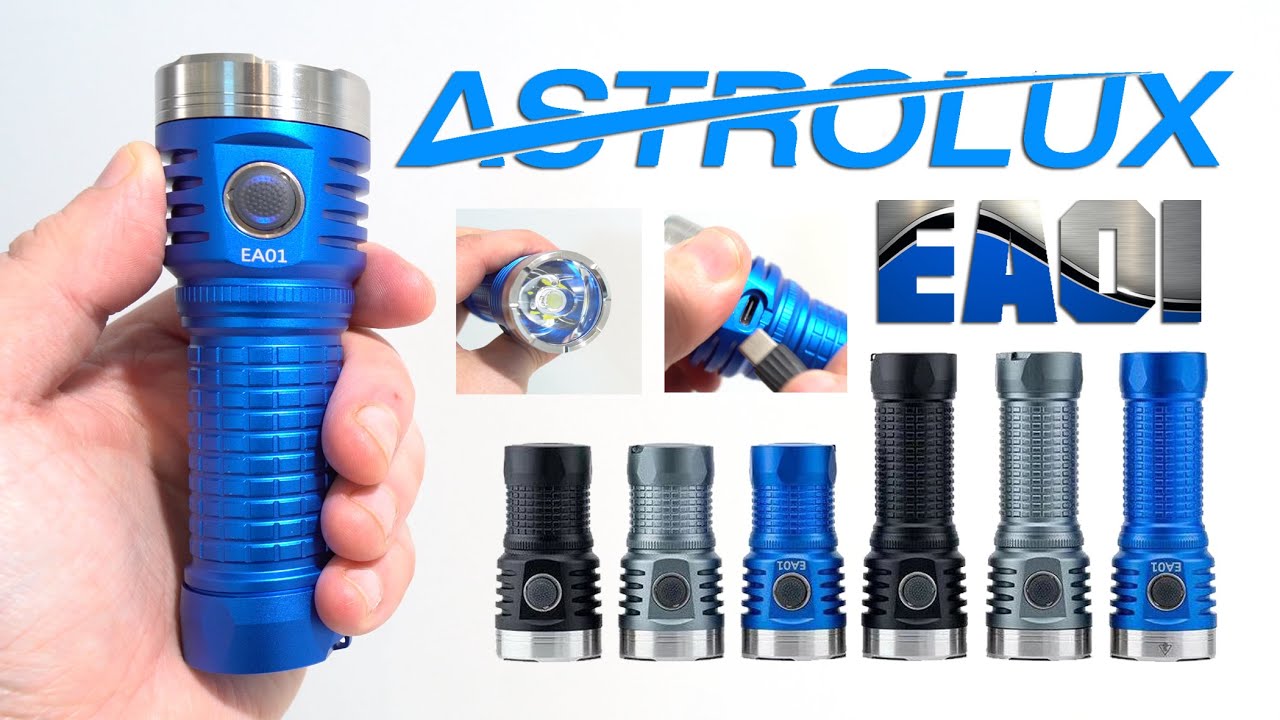

I would say your reasoning about the 50.2 is sound. It will put out many lumens for a fair distance. Some will tell you that it will do neither well but unless you are doing something like long range hunting at night, I think it will be a fine compromise. Another one to look at is the Astrolux EA01. Flashoholic’s videos have some great beam shots. This is a smaller light though with less mass.
Pennzy, Thanks for your info, appreciate it. Great recommendation. I like how versatile it is and it uses 26650 which I wanted in the first place so that it can run longer on a single charge. The TIR looks interesting. I thought C8 was compact, EA01 can be even more so. Awesome. On the other hand its small size does make me wonder how well it can dissipate heat. I do like the Anduril UI for its ramping ability. Great recommendation and now I want the EA01 instead…
Definitely will heat up faster than the larger convoy which will be able to run longer at high lumen level. You know the BLF mantra, get both. :+1:
