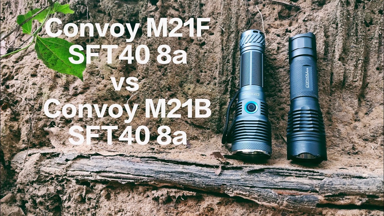

Next, a little bit on SFT40
Convoy M21F vs M21B, by Weerapat Kiatdumrong
Meanwhile, have a look at what SFT40 is capable of when paired with 60 mm head (Convoy L21B)
