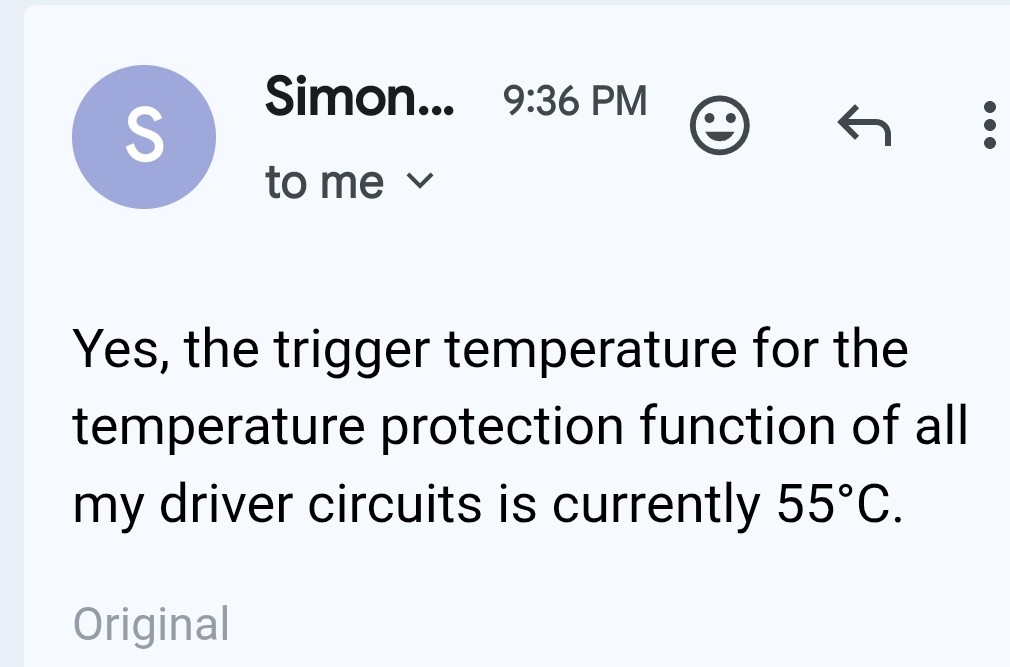

In the quote below I asked him if the l21b - sft-42r had the same 55 C step down and also what the output was.
Here is his answer below.
Maybe the light you reviewed isn’t in the category of “Most” I will ask him. Because I always want to know the answers!

It indeed does have that 55c step down listed. I should have looked at the product page before I emailed him.

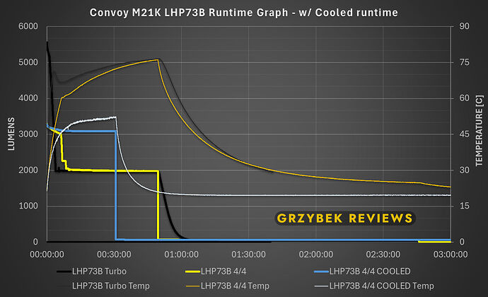

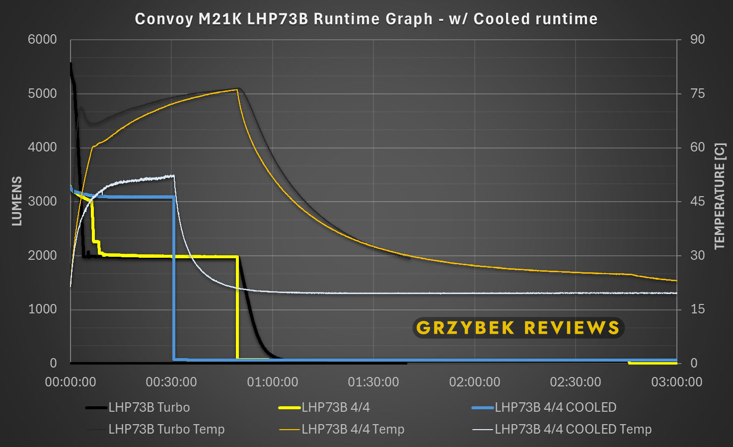

Well according to this graph, the original samples could spike to temps above 70 degrees Celsius and would respond to being cooled. If Simon has changed the driver to regulate the temperature more I would have liked to have known that before buying a light with the same driver. Maybe it can’t even sustain 2000 lumens anymore.

I’ll let you know what he tells me. I have a strong feeling it’s 55C.

I found it quite interesting how much my runtime graphs look quite a bit different compared to 1Lumen’s readings (especially temperature graphs). Not sure if there’s been a driver change.

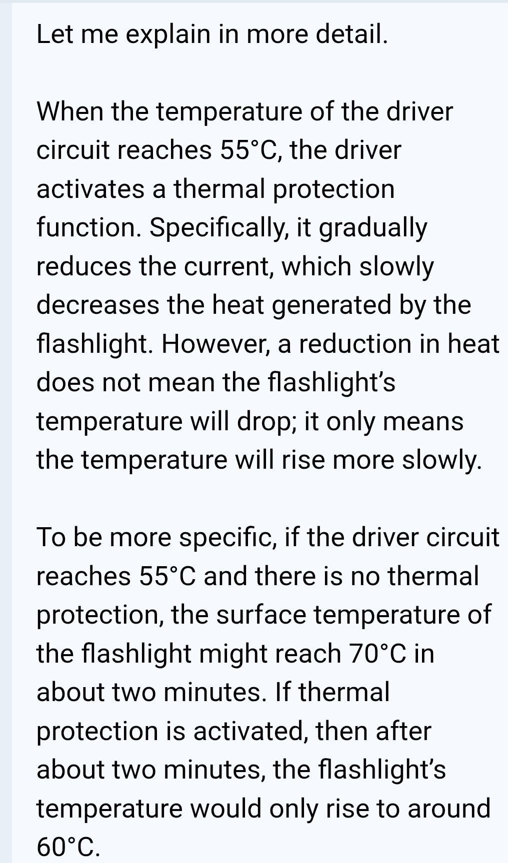

I asked Simon specifically about the M21K and if its step down is also 55C?
This is the answer I got.

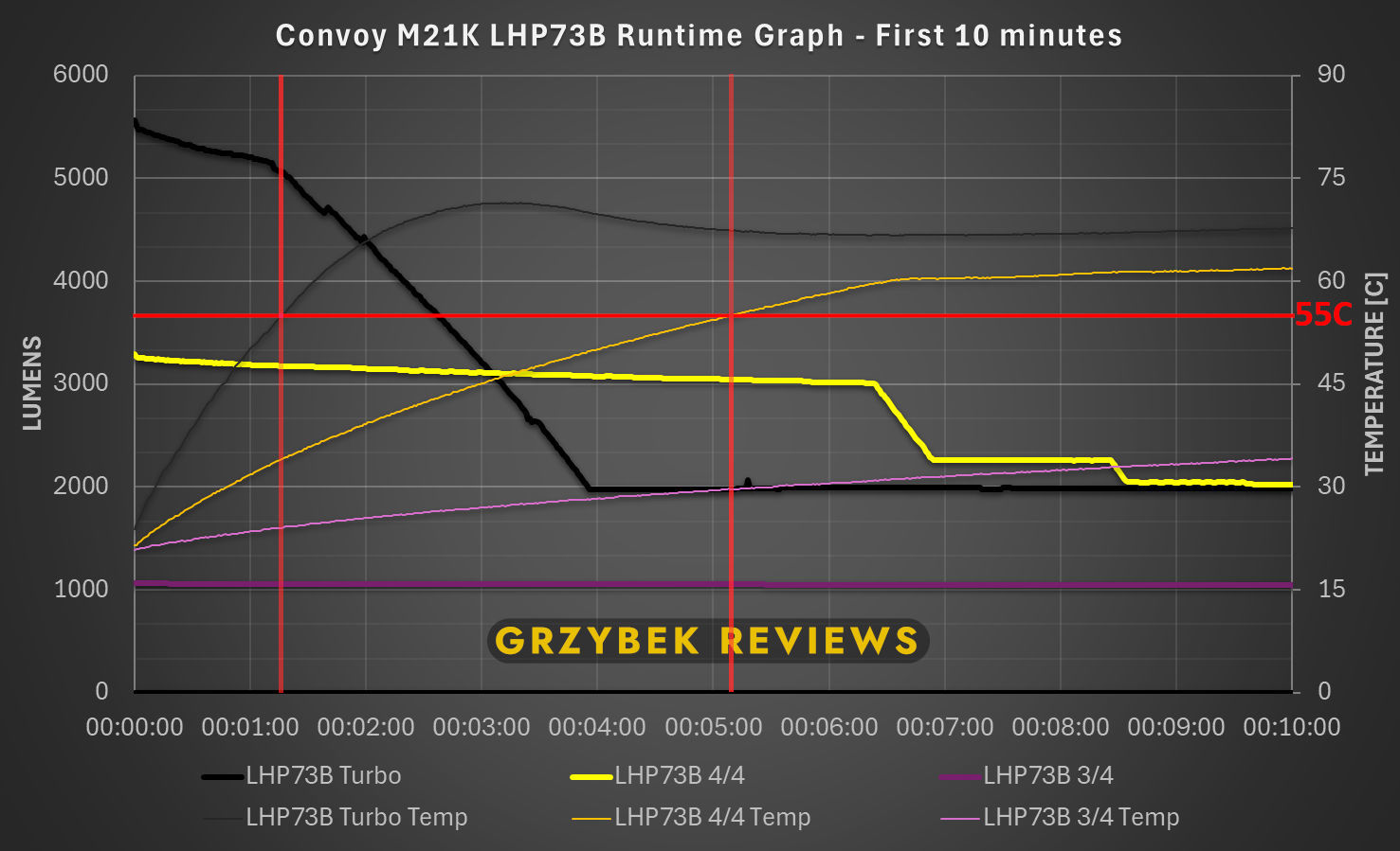

That’s a very nice explanation! My tests confirm this behavior:
I highlighted where the flashlight reaches 55C (near the switch) in the runtime. The Turbo seems to step down right at that moment, “High 4/4” mode seems to take 1.5 minute longer to step down (steps down at 60C).
Please remember that I measured the temperature of the host near the switch. Driver’s temperature won’t be the same.
After stepdown, you can see the temperature raises slower, just as Simon described.
Final, Official Confirmation.
