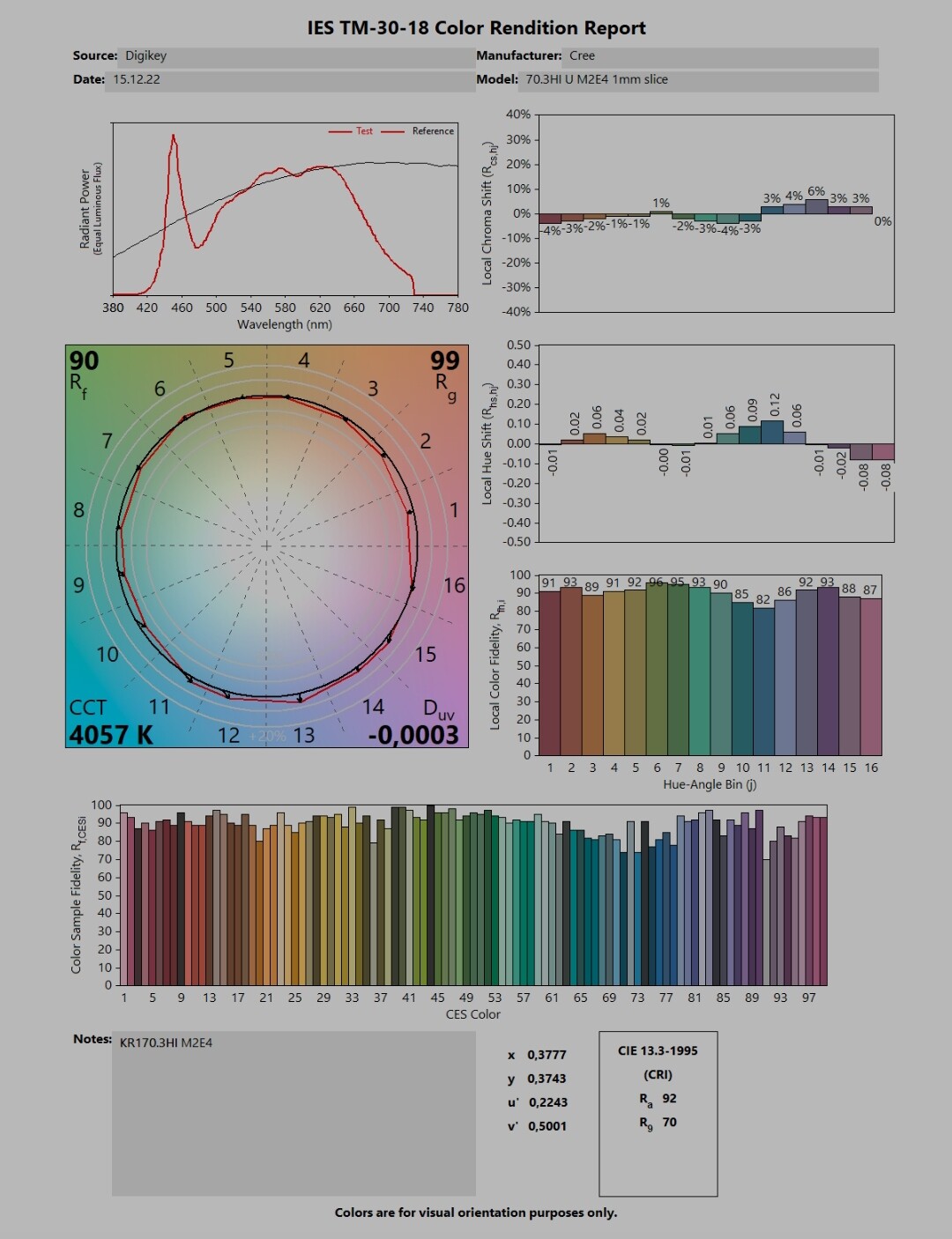

Based on my measurements 90cri 70.3’s have R9 of ~70.
You’ve really won the tint lottery with -0.0003 Duv! The 90CRI variant of the XHP50.3 tested by koef3 hit 0.0053, which is quite green even compared to bad bin SST20s. Looks like there is a lot of variance between different samples.
EDIT: was this a stock HI emitter or a sliced HD? The screenshot gives conflicting information. The sliced HDs generally perform MUCH better than stock HIs in tint.
Sliced HD. I noticed my typo too late
