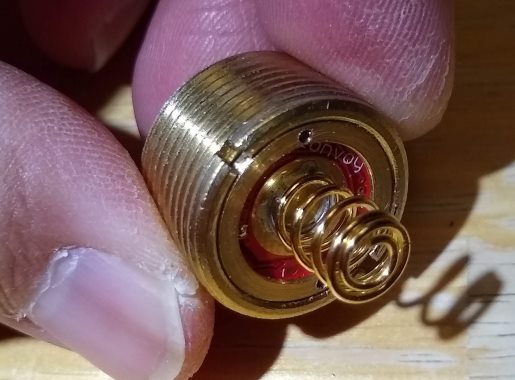

I got the driver and LED assembly out of the light after watching some videos. But I can’t figure out how to disassemble the PCB from the light assembly. I see two circular openings on diametric sides of the brass ring that is covering the PCB. What tools might be useful to unscrew that? I tried needle nose pliers but no luck.

To remove the driver you need to loosen the retaining ring. Use a pair of snap ring pliers (tweezers will work in a pinch but may bend) inserted into the two holes, not the notches, and unscrew.
That depends on what driver it uses, versions with more than 4*7135 do not come with a retainer ring, instead they are soldered on the pill with 2 solder blobs
Did you look at his picture?
Have you tried tightening the tailswitch retaining ring? Drivers themselves rarely go bad, so I would suspect a electrical contact issue might be causing your inconsistent behavior. To turn those restaining rings with the two holes I use a pair of thick crappy tweezers that I don’t care about bending some.
Your current 12 mode group driver satisfies most of your requirements. It does not have LVP I think, but LVP is not as necessary on this type of driver because it is very unlikely that you will damage your cell from overdischarge in this light. The voltage of the LED is such that when the cell is empty it draws very very little current. So your light will just become dim when the battery is low.
I recall there being some production issues with your driver that caused the electrical ground ring to be covered by a film that prevented good contact, so that is something you should check for when you take off the driver retaining ring. You can just scratch off the film, if it’s there, to fix the issue.
Snap-ring pliers OR needle nose pliers. In either case you may need to further file or grind down the tips to go fully into the hole to reach the bottom for full engagement.Then put some electrical tape on the threads before you wreck them in anyway.

Remember: the retaining ring in the pill has a (regular clockwise) righthand thread, while the retaining ring on the switch of an S2+ has a (counter clockwise) lefthand thread.
And take a closer look at the retaining ring of the switch. There should be NO visible gap between the switch-PCB and the ring. The PCB must snug fit IN a groove in the retaining ring.
