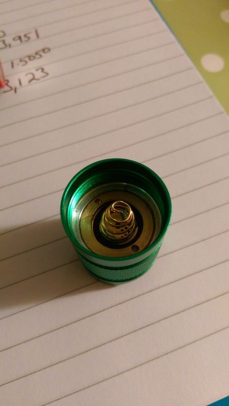

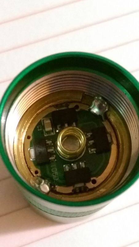

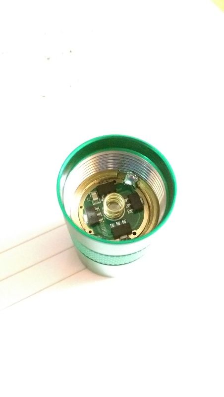

Got any pics of the light you have? I’d like to see it, specifically, the inside of the head (showing the driver and spring) and the spring in the tailcap.

Pics below, though I wonder what you’re looking for?

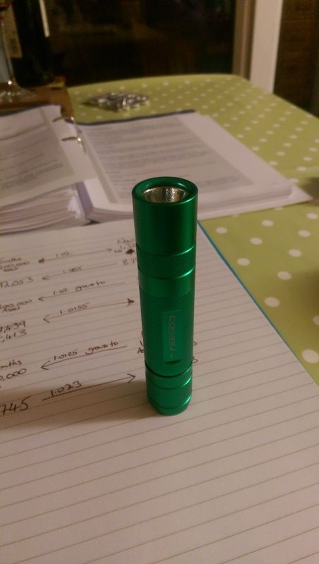

Very nice! It appears to be a legitimate Convoy there… GB had been shipping some fakes, but yours looks good. That looks like the 2.8A driver too, so yeah, it’ll get warm. :party:
The listing said “Circuitry: 2800mA (7135 x 8) ”, I presume that’s what you mean……I’m not sure what it is really…
Among other things, checking to see whether you’ve got a fake .

Also of interest — whether your driver is held in by a retaining ring (the pill is threaded to take one)
or is held in by solder blobs
or has a threaded retaining ring screwed in plus solder blobs on top of it.
I’m not sure what the pattern is there — maybe it’s the drivers with more chips that get the solder added?
Yes, if you have more than 4 chips (i.e. they have to put chips on the bottom) they use the solder blobs because the retaining ring won’t fit over the chips on the bottom. Makes it more of a pain reprogram those drivers, wish convoy would come up with a new retaining ring that fit over them - just a deeper pill would be fine.
