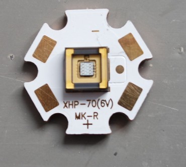

The picture on the BG site shows a chinese led, certainly not Nichia. A nice light if you have no UV light yet, very disappointing if you know what it looks like with a good 365nm led plus UV-pass filter.

The thing with this Light is the LED is overdriven so Djozz pecial copper board is nice to have

Mark, if a good (ZWB2) uv-pass filter is used, there’s quite a few new 365nm leds that can be used just as effectively or even better than the Nichia 276A.
Edit: nice website! :slight_smile:
With UV filter the Lite-on is way better, more current and has an thermal pad used with DTP stars to drive it hard
Only Problem with that LED is at 1A its forward voltage is above 4.2V so you need a boost or buck driver

The trick with the LiteOn led is that it has a central thermal solder pad, that the Nichia’s do not have. Here on this forum we use special (direct thermal path) ledboards that heatsink these leds very well so that they can be overdriven with the output boosted and without seeming harm. What it does to the led over many many hours I don’t know for sure but they may survive just fine…
