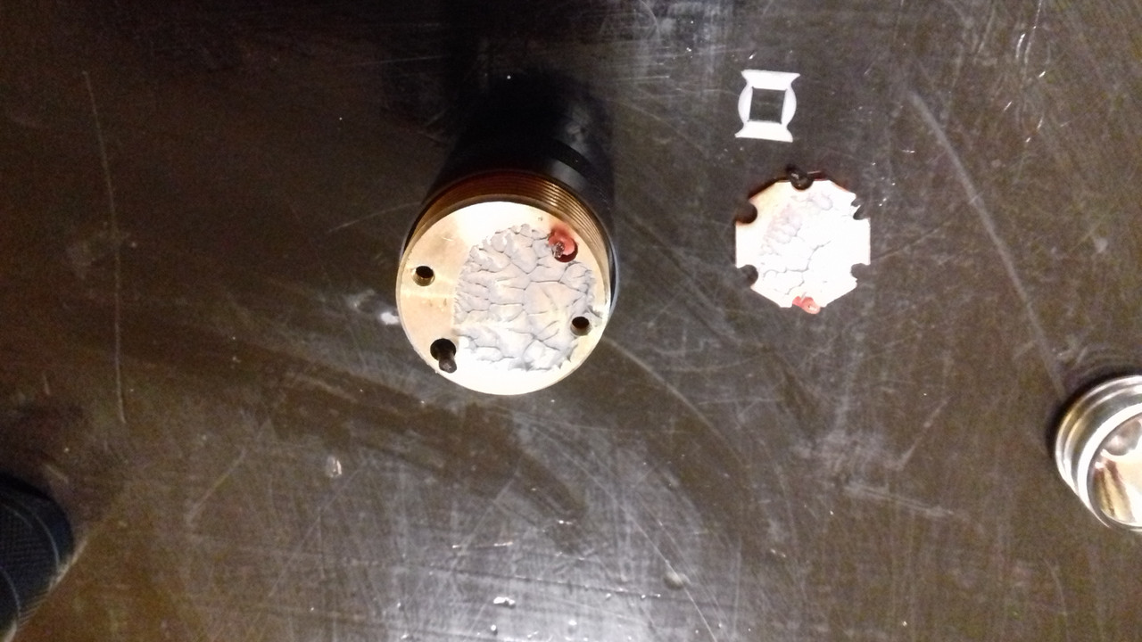

Here is picture of pill.
I would like to know what is the reason of this fail.
Not enough paste on pill, bad temperature control, low bin led, or something else.
Try putting gentle but firm downward pressure on the led dome while connected to an appropriate power source to see if you get a temporary flash of light…
I’ve had many SST40s fail in a weird way which is when the emitter chip actually de-solders itself from the substrate. Often you can get them to work by pressing down on them. Obviously not a solution, but may point to a cause.

In the photo there is thermal paste. Did you add it? That amount is more than enough. A standard s2+ with the 3amp driver will overheat within minutes in some conditions on high mode. Also some times temp regulation needs to be set. It may be out of calibration from the factory.
Driver is fine.
No dirt on Led, no bad reflow.
Also not visable damage on LED.
