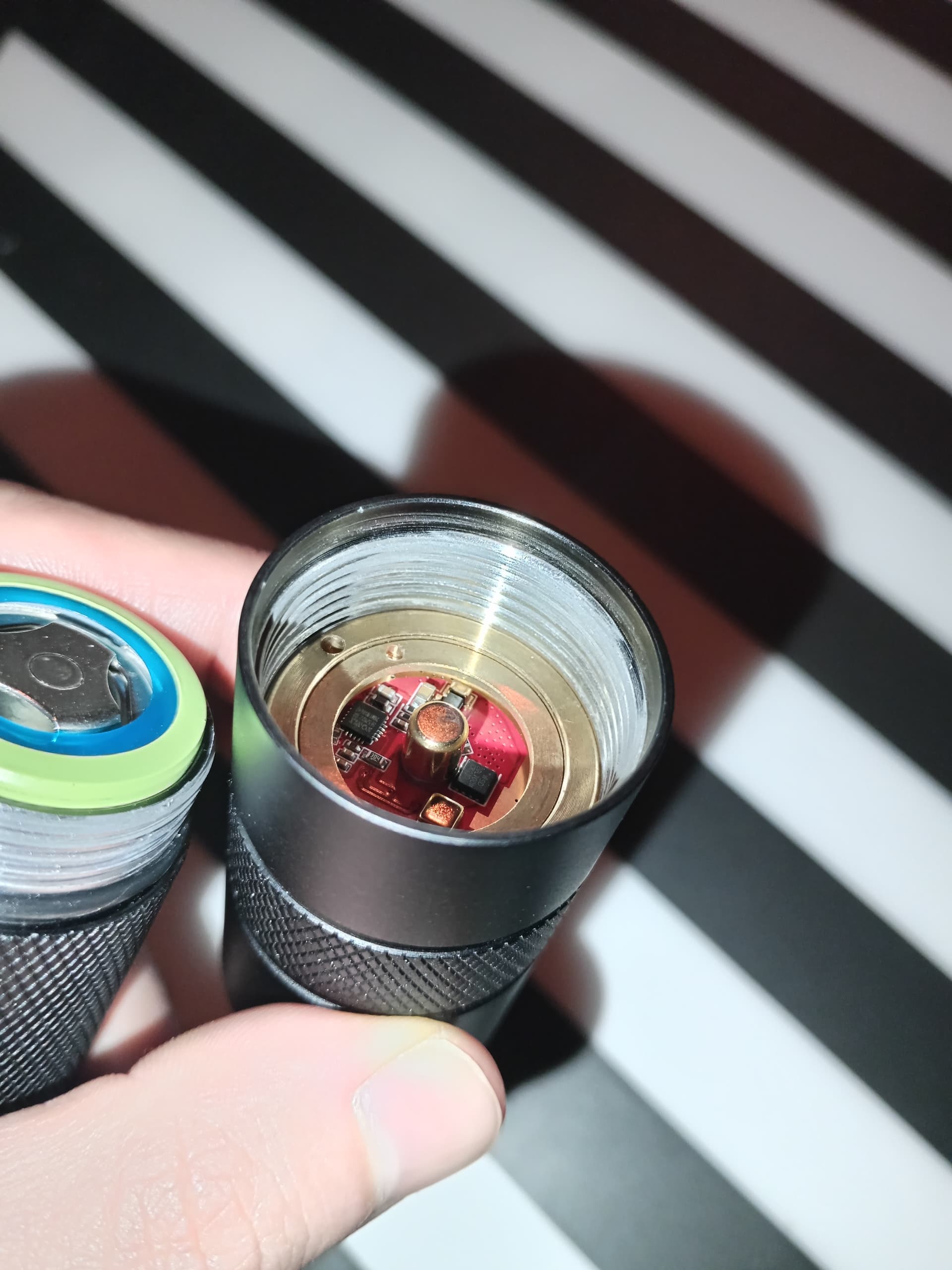

I have a Convoy S26a and a S21a on a bike. The S26a doesn’t work well, it changes modes during the session when I go over bumps in the road. The S21a worked well so far.
The S26a has a spring on the rear cap and a “cylinder” on the driver’s side. The S21a has a spring on both sides.
Does anyone have any idea how I can save the S26a? Is it possible to buy a driver with a spring?
Thanks in advance
What led the S26 is, is it the xhp70.2/3 if thats the case; you can purchase the 6v5a 17mm driver + additional retaining ring for the 17 to 22mm converter.

Hey, I had a very similar problem with my M3-C, and ended up soldering on a tiny spring on the end of the brass post.
This one I think. It’s tiny and just the right size. Really easy soldering, just don’t accidentally desolder the post itself that’s a bit trickier.

It’s similar to the post connector in the S26a, but these pogo pin have a spring. However I know nothing about this, do you think I could replace the post by this ?

Depending on your soldering ability, it might be a challenge, it’s a large metallic component so might suck up a lot of heat?

Make sure the base of the pogo pin not hitting any components protruding around the brasspost.

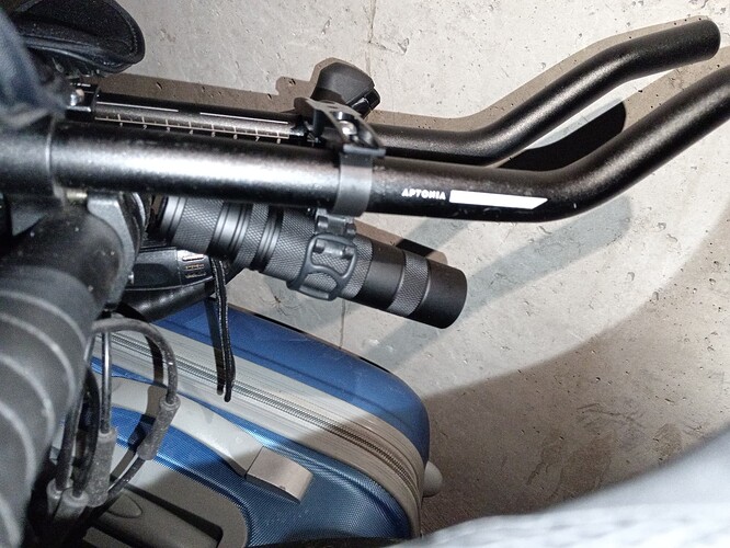

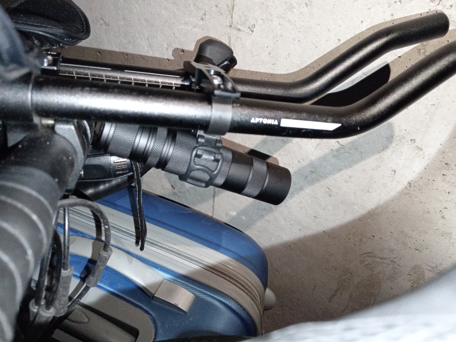

Just to give some feedback. The problem has been reduced but hasn’t gone away. When the back of the flashlight hits the handlebars, it changes mode:

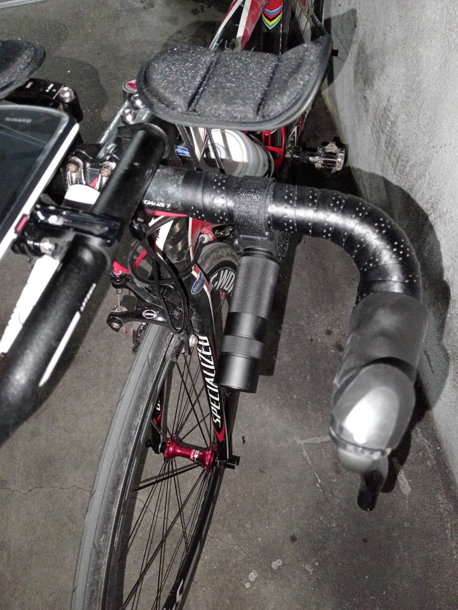

However, if I move the torch here, there is no problem:
I will keep this solution for now. I have an S21E and when I tap the back of the flashlight this problem never happens. So maybe an M26D would work well here.
M26D uses a brass post for the driver and would have the same problem. You want springs on both ends for this application.
