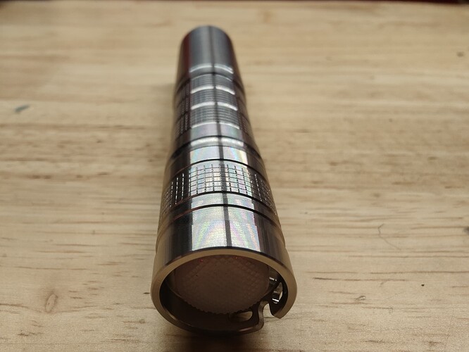

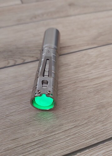

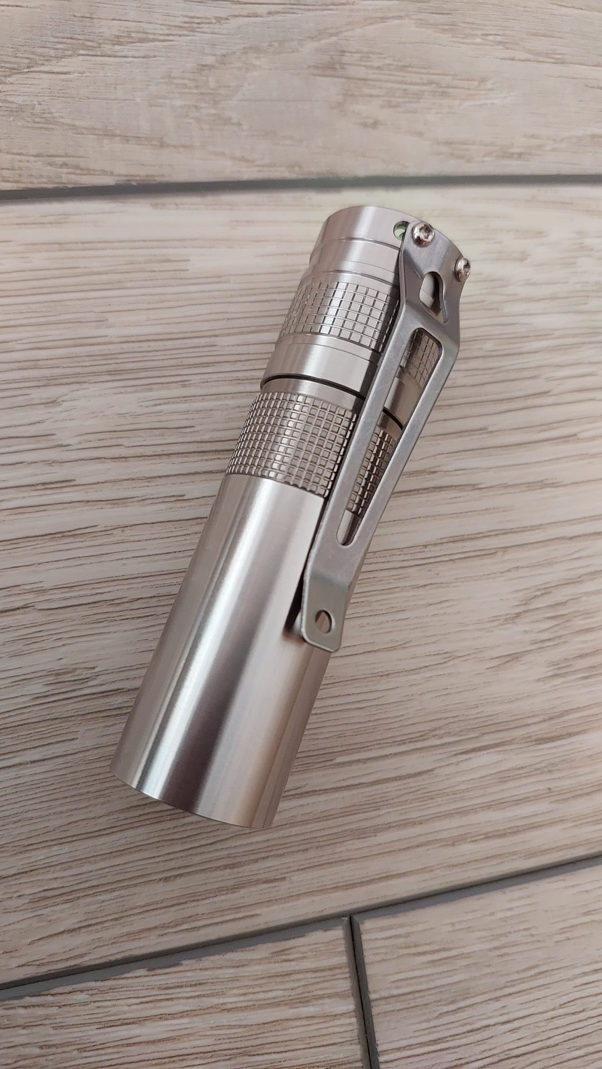

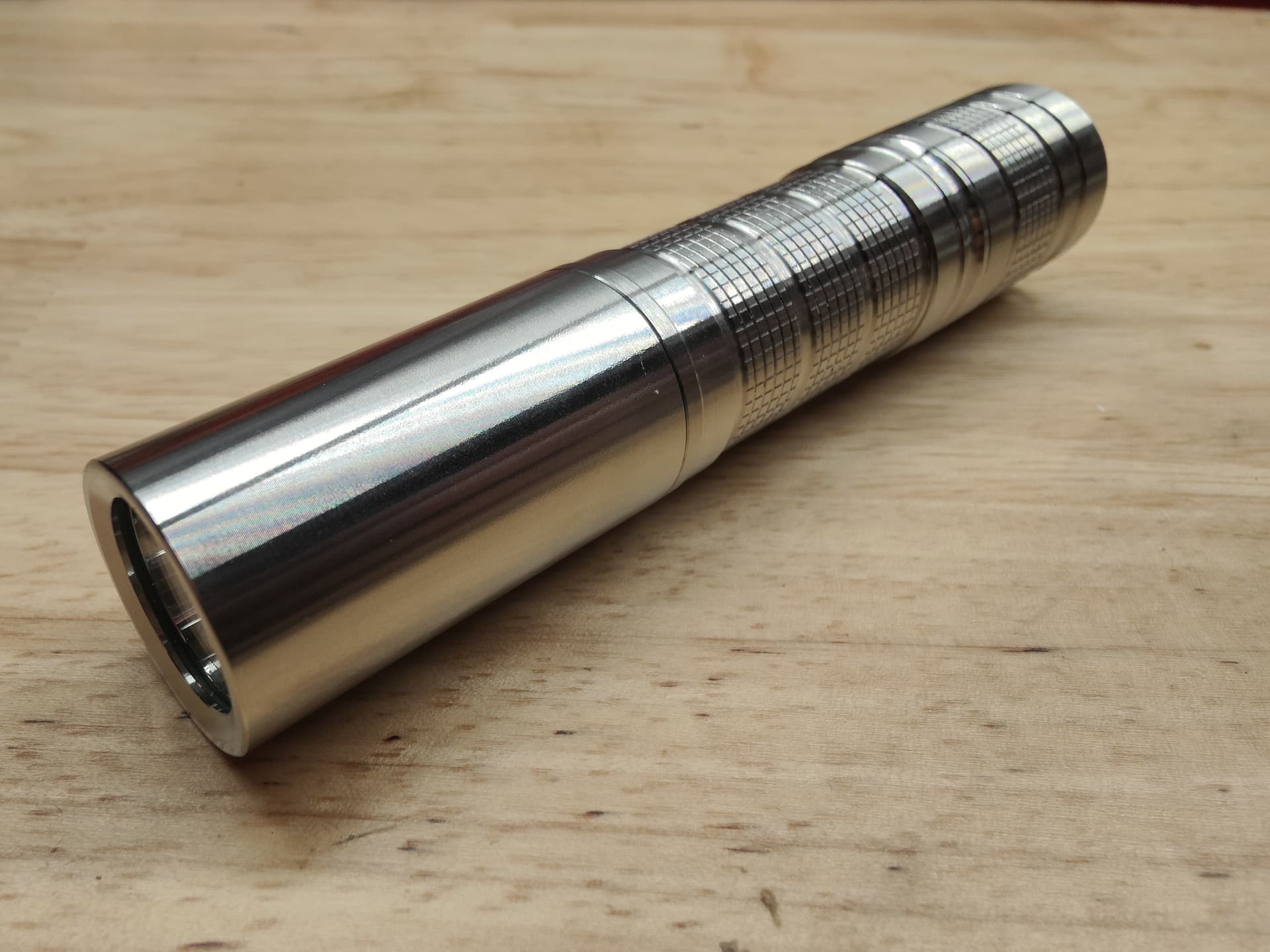

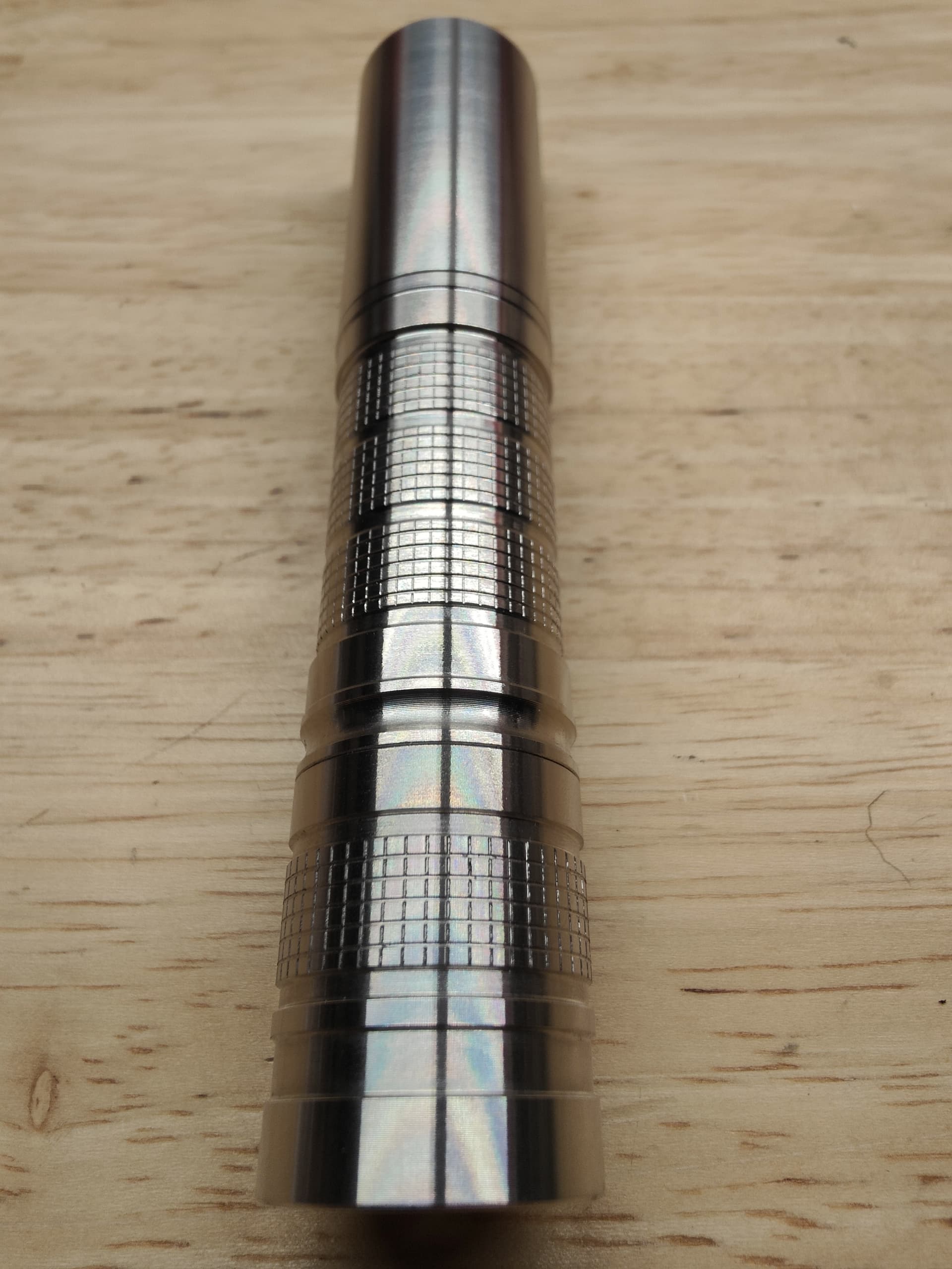

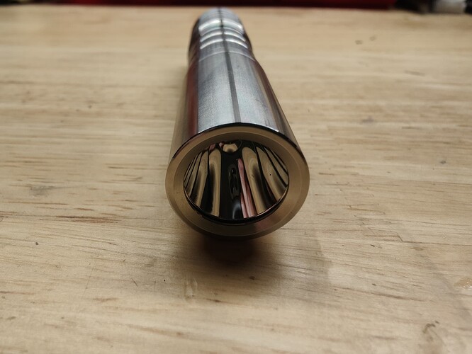

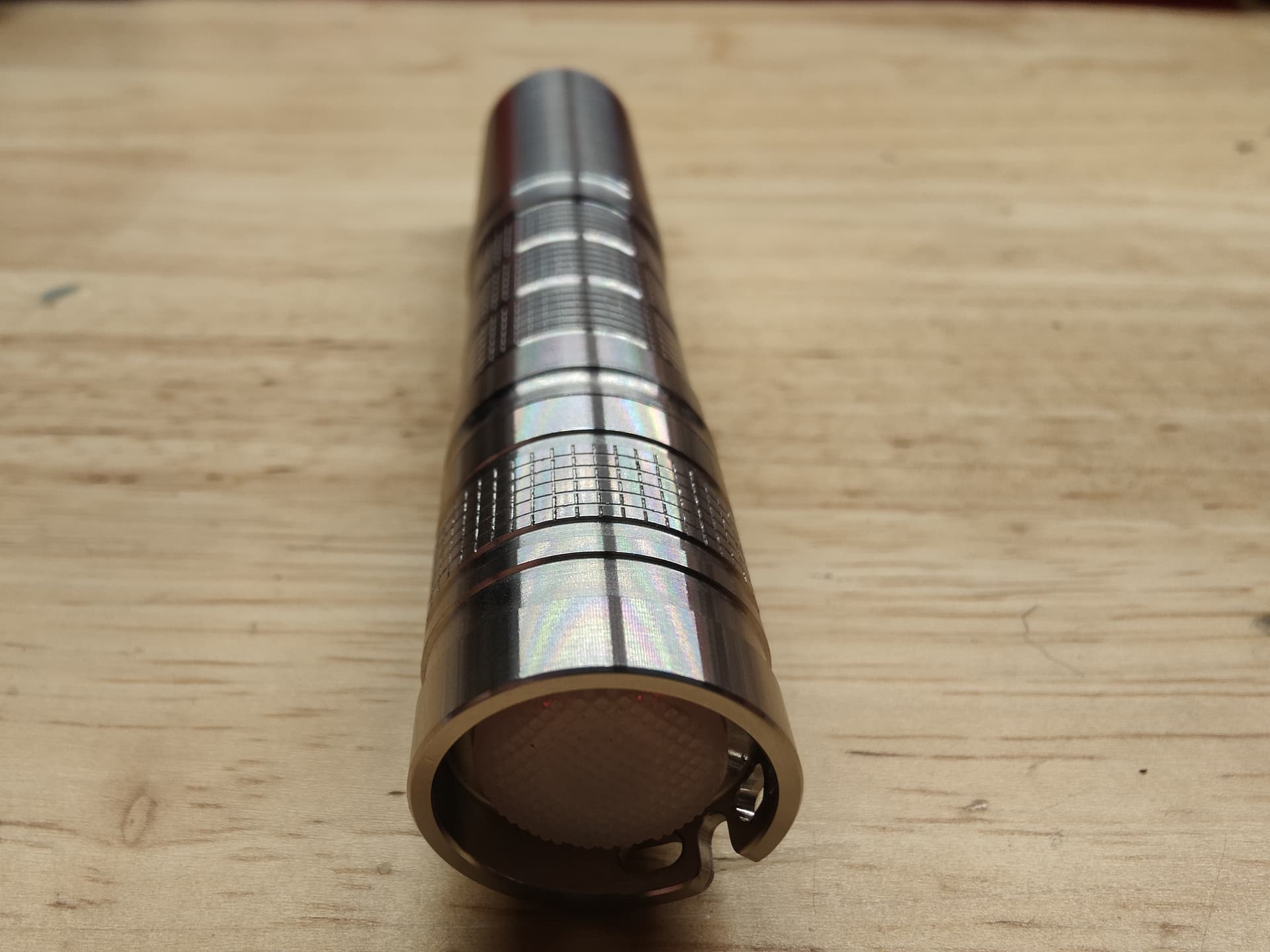

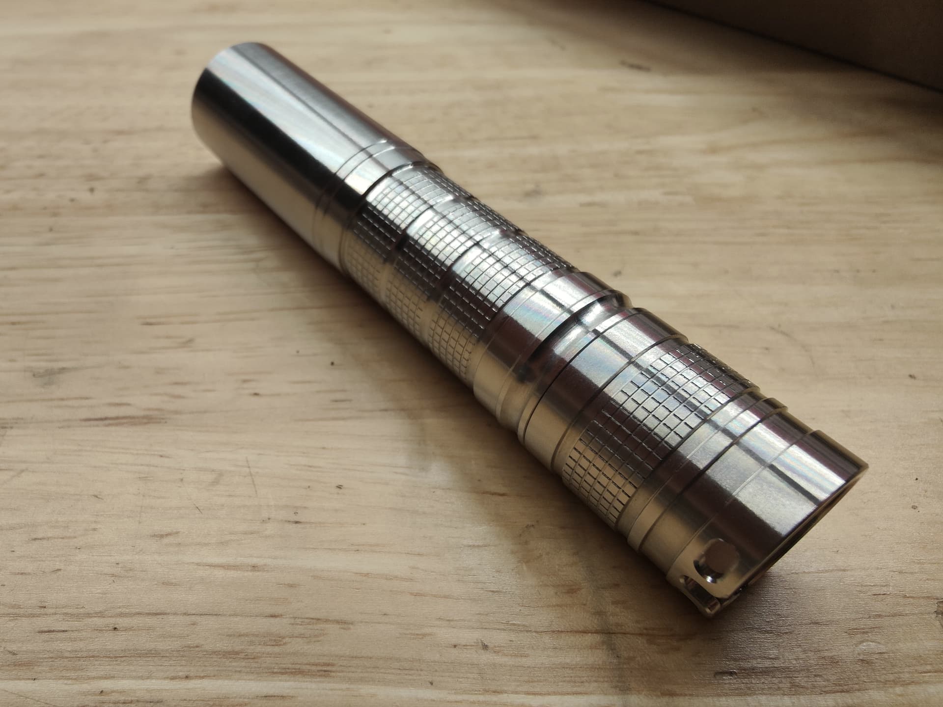

Hey folks, I hope all is well, I just got the Convoy S7 in glossy Stainless Steel and it’s an amazing looking flashlight. I got mine as a host and put a SFT25 in it and a BLF A6 driver as I wanted to see what the SFT25 can do. My last YouTube review was the Convoy S6 and these use the same reflector, so I will do some beam shots later as the S8 using an Osram CSLMN1 and that gets 49000cd these should perform similarly, hopefully.
The Convoy S7 cost me $22 AUD which is like $18 USD I think, not sure about the tariffs, I don’t think you will find a better looking flashlight than the Convoy S7 at that price.
On another note, the new Convoy store is amazing, it’s so well priced, international buyers have never had the opportunity to get more advanced parts like the 17mm 5amp boost diver for such a competitive price.

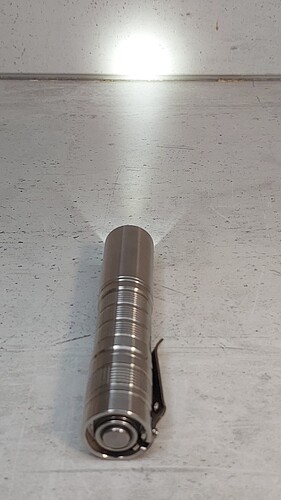

another S7, if you can add it here (Osram CSLMN1)
Osram KW CSNM1.TG 6500K, 5 А

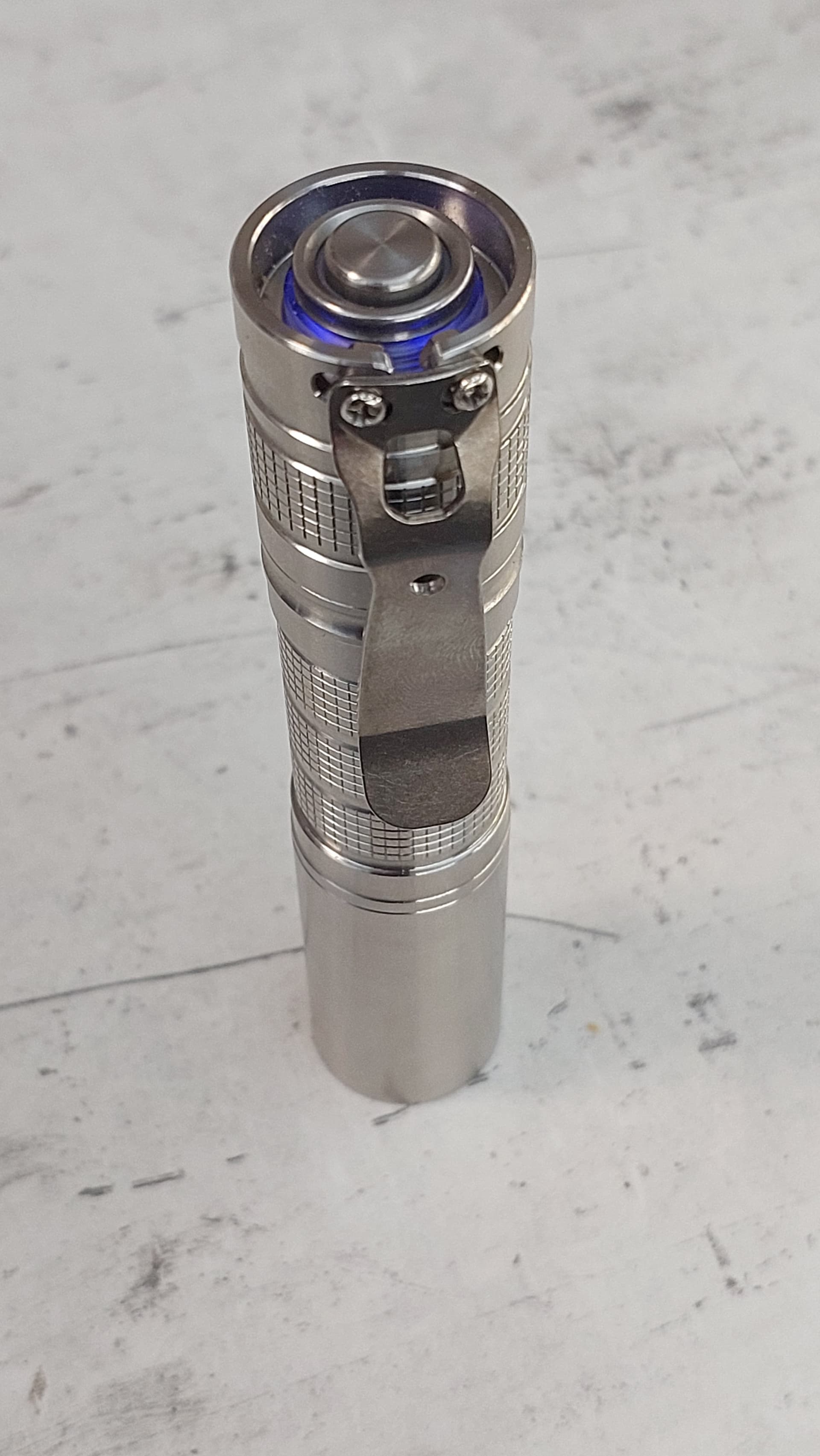

Looking good mate, I left the stock tail cap boot on mine, not sure what one I like better now, I got red LEDs in mine.
Wow that really looks great!

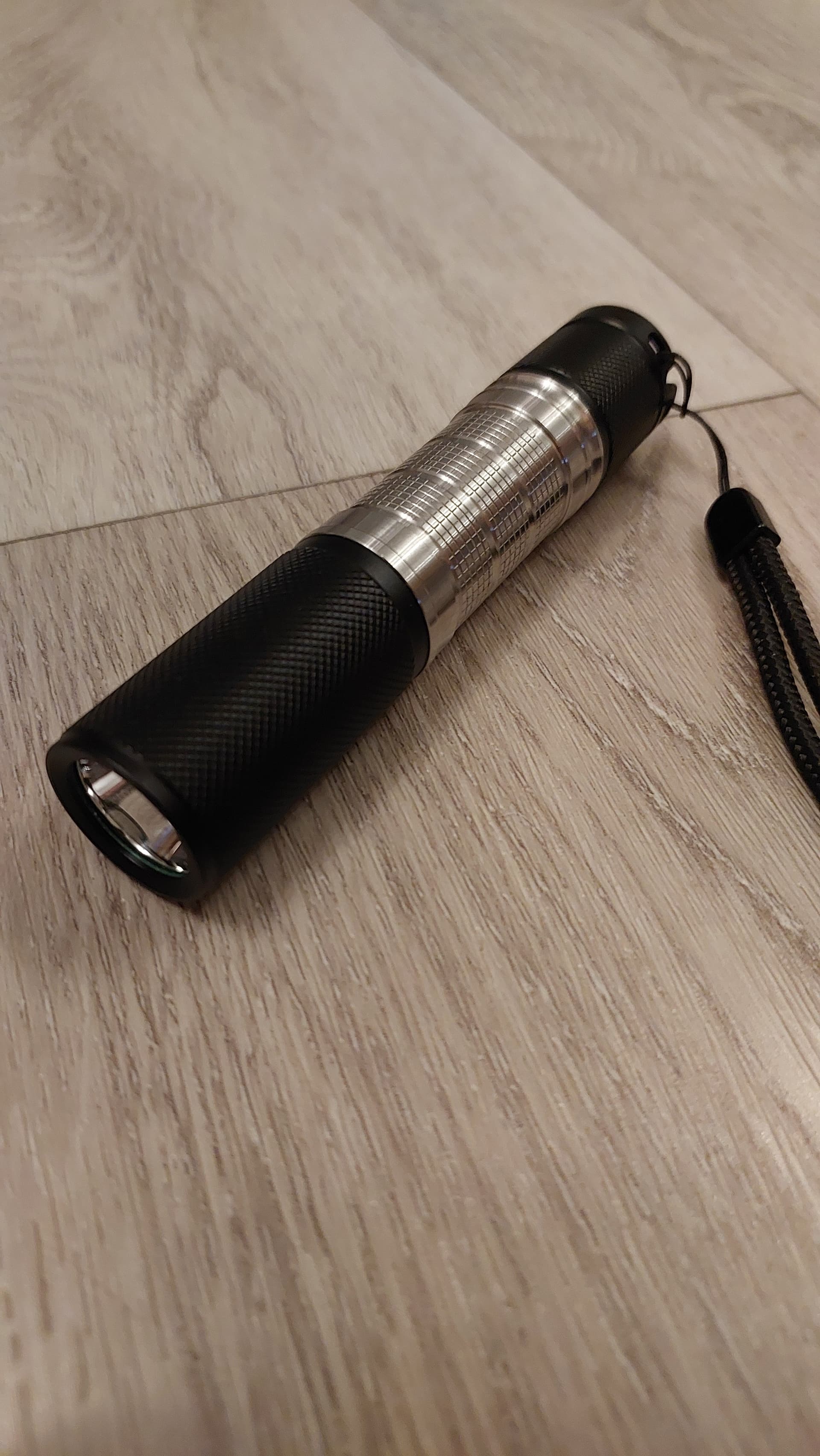

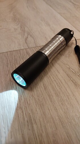

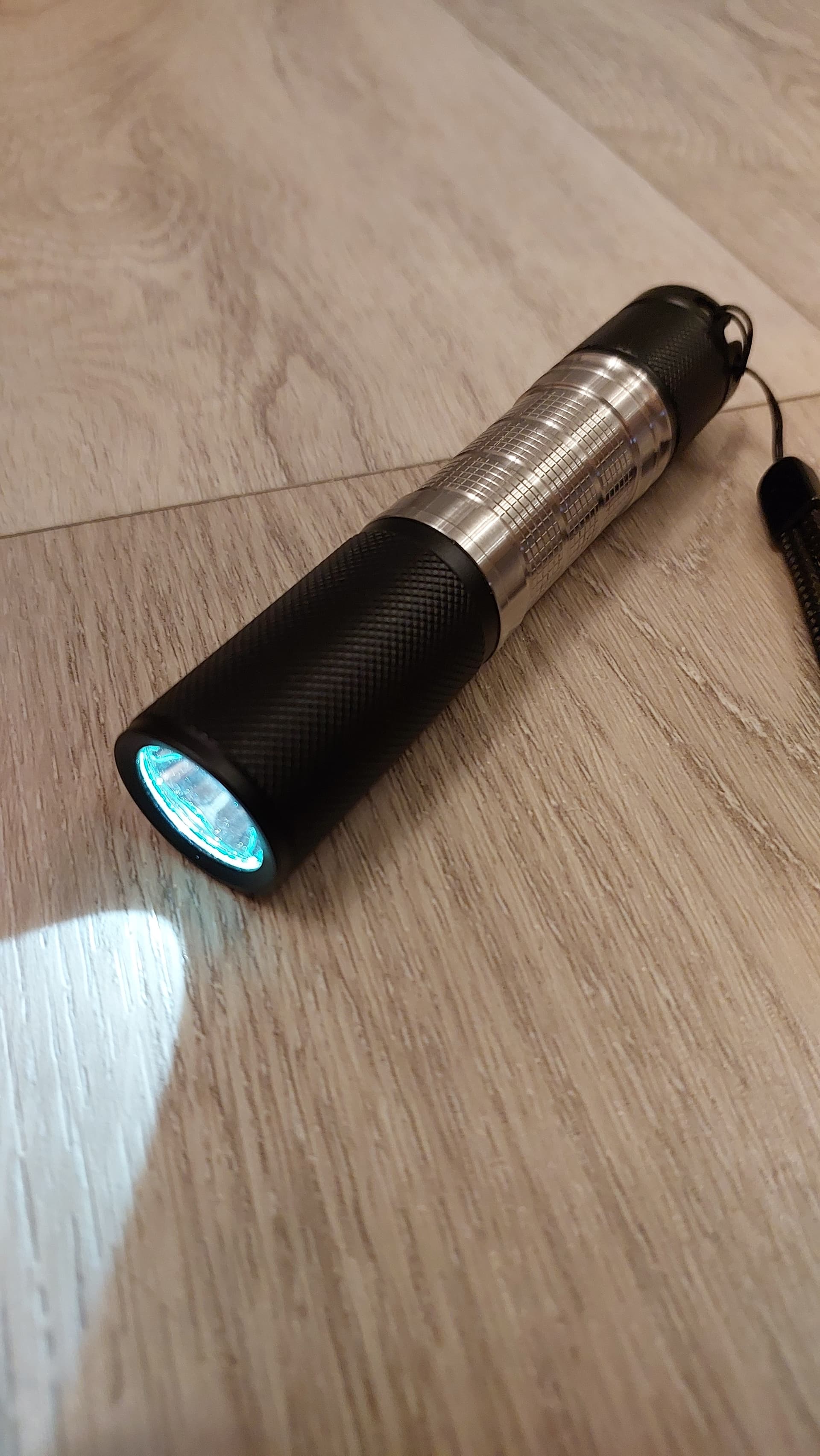

Threads on the stainless s6/7 the same as the current aluminum 18350 tubes I presume?

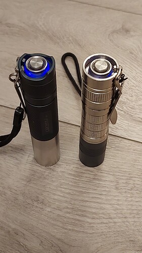

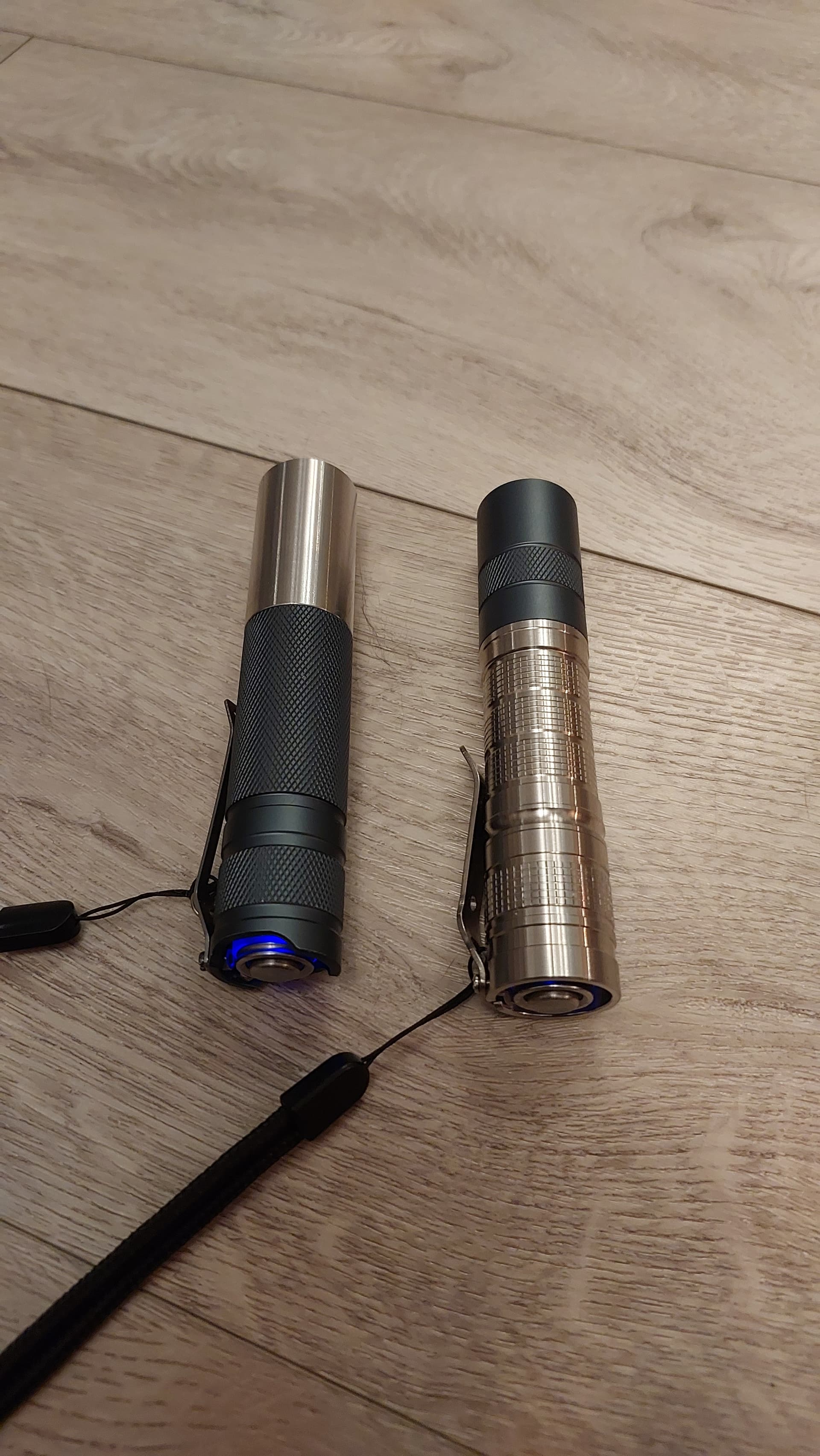

yes, I rearranged the S2+ aluminum head and everything works. The threads are the same. Short tube 18350 made of titanium. The black one is the S6. The gray tube is S2+ aluminum

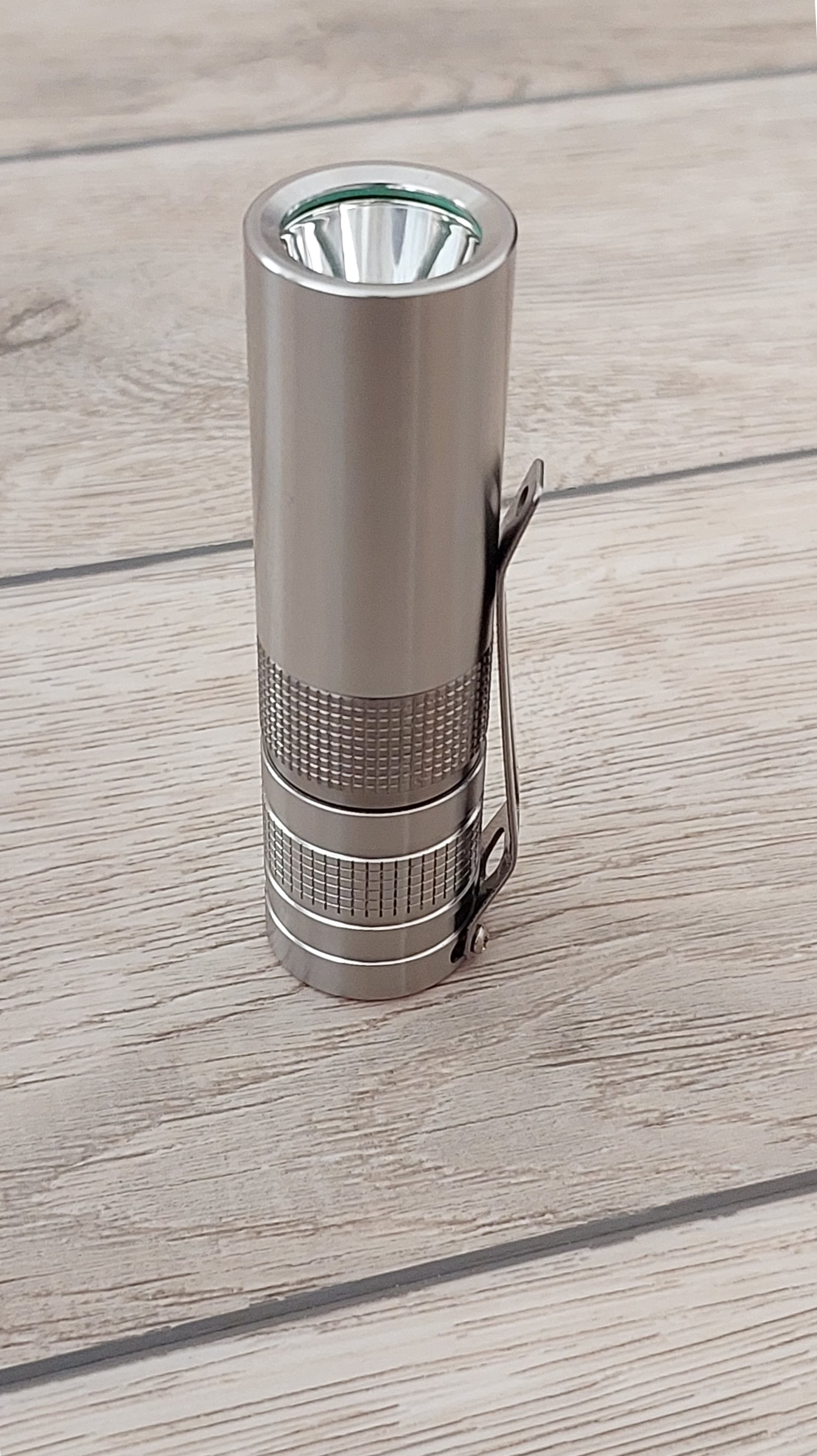

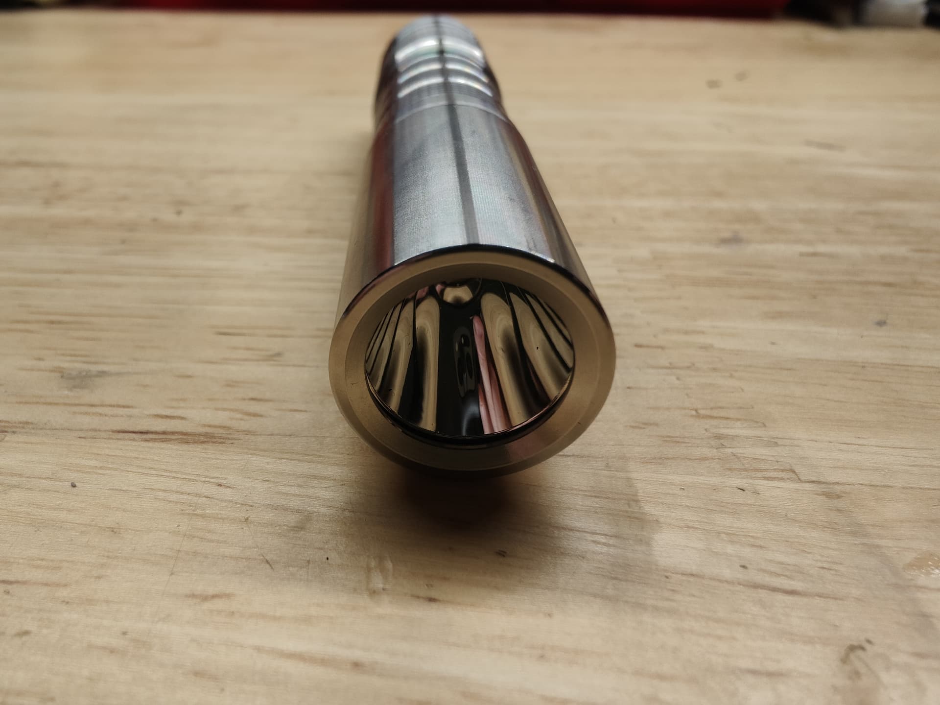

I picked up a glossy one too, although it’s really more of a lightly-brushed finish which is much better for not being a fingerprint magnet. Mine’s got a 5000K 519a in, I’ve not had it outside after dark yet but it seems like it’ll be reasonably throwy. Of course the Nichia 519 is beautifully neutral. This is a really nice-looking light! It makes my SK05 feel lightweight though. :smiley:

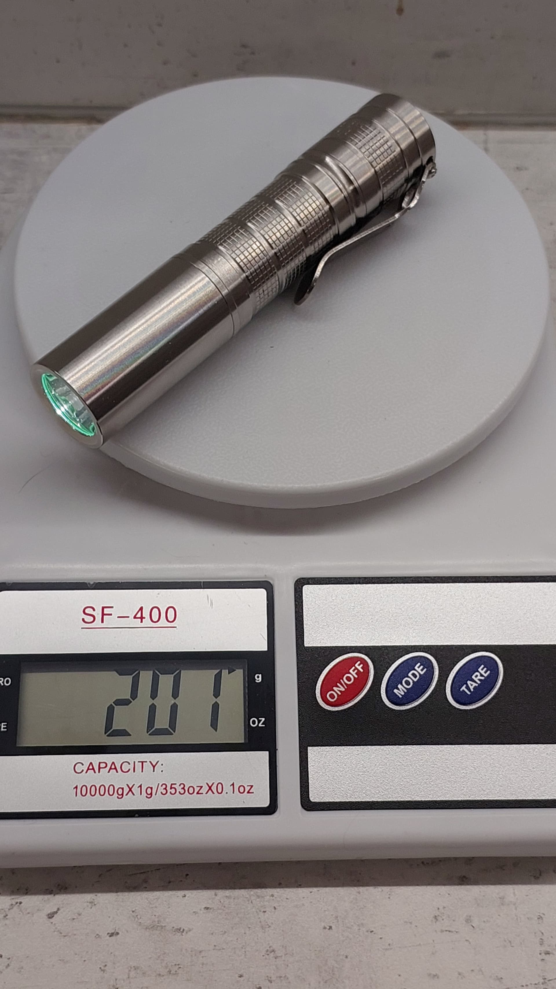

Personally, it’s too heavy to EDC this light.
